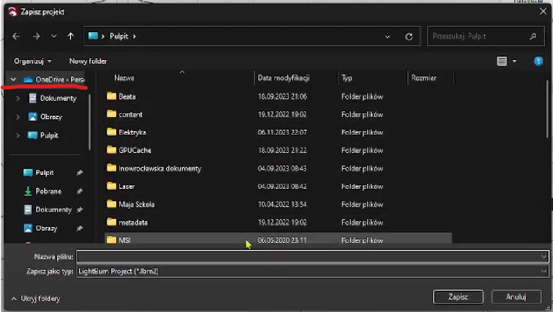

What are you trying to save? Does it hang before or after you see the window that lets you choose the filename?

I wrote to support. If there is a solution, I will definitely share it here. Below is a YT link to what exactly is happening.
Does the crash occur if you save to a local drive rather than Onedrive?
I dont use it an onedrive…
Does this not indicate that the Pulpit folder resides within OneDrive?
