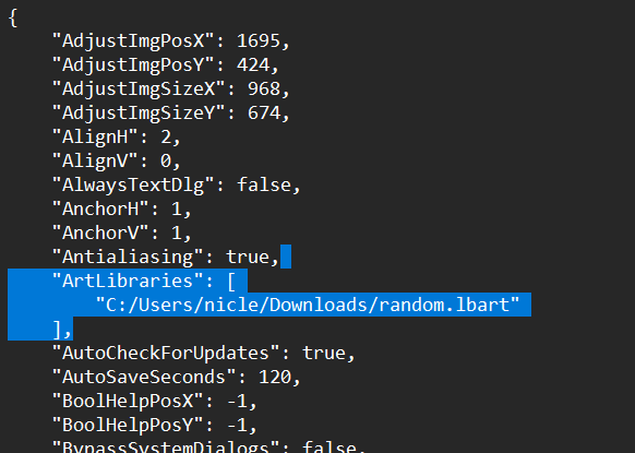

The log entry you would normally see in that position would be ‘D: Preferences loaded’, it’s absence indicates an issue during the loading of your prefs.ini file.
Last time I saw this error it turned out to be a problem with a corrupt Art Library.
Do you use an Art library?
Make a backup copy of your current Application Settings and Art Libraries : File>Bundles>Export Bundle.
Close LightBurn.
Open Notepad and then open your prefs.ini file (Ctrl+O and paste in %USERPROFILE%\AppData\Local\LightBurn\prefs.ini).
Take note of the location and names of the Art Libraries:
To prevent LightBurn from trying to load the Art Libraries at start up you can either delete just the “ArtLibraries” field as highlighted above and save, or you can find the library file/s that are referenced and move them to a different folder or rename them.
After this, if LightBurn loads successfully… you will know it’s an Art Library issue, and hopefully you will have a backup of the affected .lbart file on your computer.
Best way to backup the Art Libraries are to include them in a Bundles Export.
