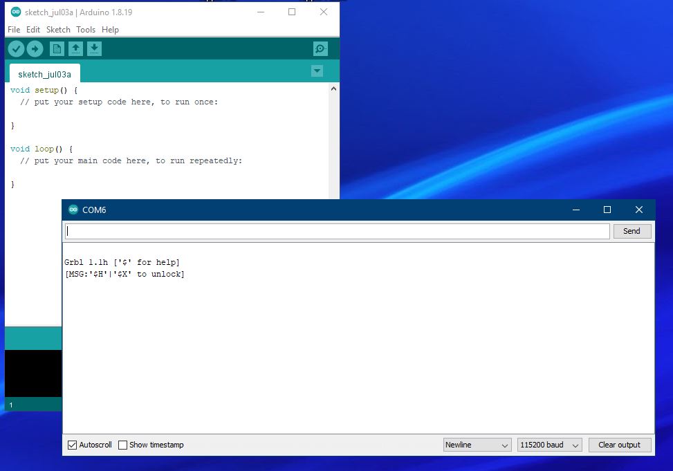

Do you have any other Terminal program available? Do you use the Arduino IDE? Then you could start the serial terminal in the IDE and check if the error also comes up there. (Start IDE, select correct COM port in tools menu and then open serial monitor with baud rate 115200).

Not sure if this is what you wanted to see?
Yes, looks right. So, if you connect via this terminal, there is no error. It looks like the error is created while LightBurn establishes connection…
If you connect like this, could you send the command “$H” via the monitor window? It should home then. Just to be sure.
Another test that would be great to check: while you are connected like this, press the “reset” button on the main board. Then the controller will do a fresh reboot, and you should get all messages. Do not disconnect the USB cable because this will disturb communication.
I sent the $H it homed and all it said was “ok” in the window. As for physically pushing the reset button on the board it’s a pain on the Atomstack as the leg needs to come off then the board is in backwards so it needs to fully come out.

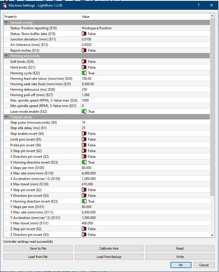

Was just wondering if you can have a look at machine settings and see if it looks ok or might have something off?
From a first glance, the only weird thing I see is your homing pull-off distance. I don’t know if it’s a formatting issue, but it seems to be set at 1000. It should be set to 1 (or something close to that). And the homing seek feed rate is much too high. It’s even faster than your max speeds. Set it to 1500 instead of 8000. The rest looks ok, I think (I don’t own an Atomstack).
“1.000” is 1 mm for US standard so should be okay.
