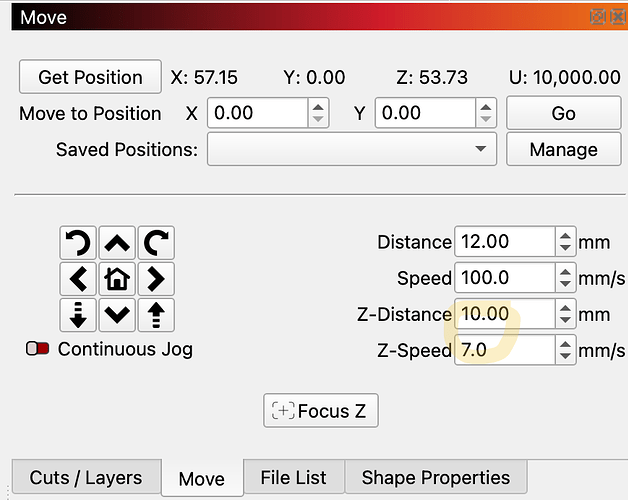

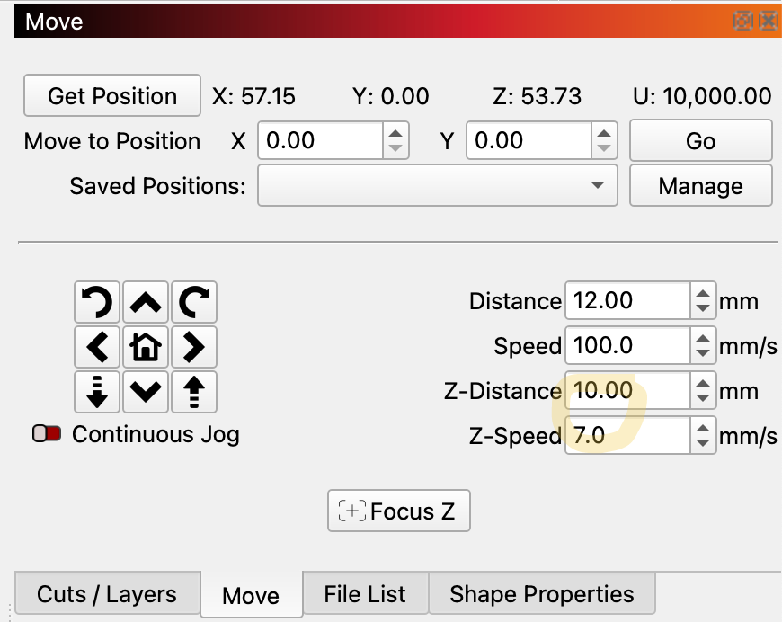

Check your Z-settings here in the Move window, especially Z-Distance which is a new setting:
Yes. Instead of changing by the assigned movement number, say even 1mm, the z crashes to the bed and then the engraver tosses an error. I have to restart the machine to clear it. Unfortunately, I do not have a control panel on the machine to be able to give you more information on the error or what else is happening. I do know that with the auto focus button it works after I updated the info from the older version as mentioned above.
