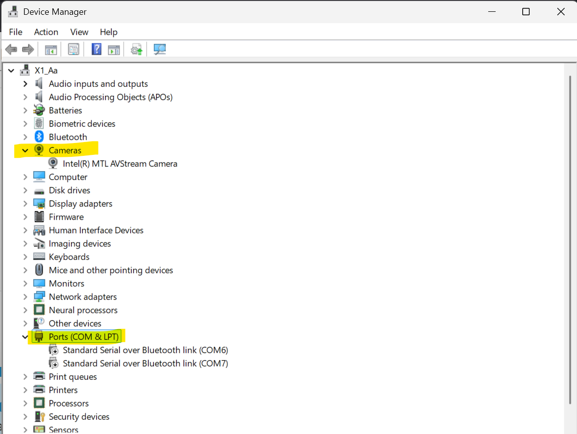

You said previously, that it recognized the laser. It should appear in the Device Manager under the tab “Ports (COM & LPT)” without any errors.
Did you install the FTDI (DSP) drivers?
Does the camera appear under the “Cameras” tab in Windows Device Manager?

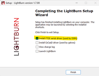

“FTDI” is the brand of the USB-serial chip in your laser’s controller (Many Lasers and 3D printers use this same chip). The driver included in the LightBurn installer should be the same as in the .ZIP file from the Gweike site.
The LightBurn installer includes an installer, which simplifies the installation:
Download the latest version from here .
Run it to install over the existing version (No need to uninstall first.)
On the last step, before clicking “Finish” tick this box:
A separate window will open to guide you through. Click “extract” and “Next” a couple of times.

Ive installed the FTDI drivers and still no camera is working?
Lightburn finds Gweike ok and also I see…
Gweike is on Com 3.
No camera showing up under device manager?

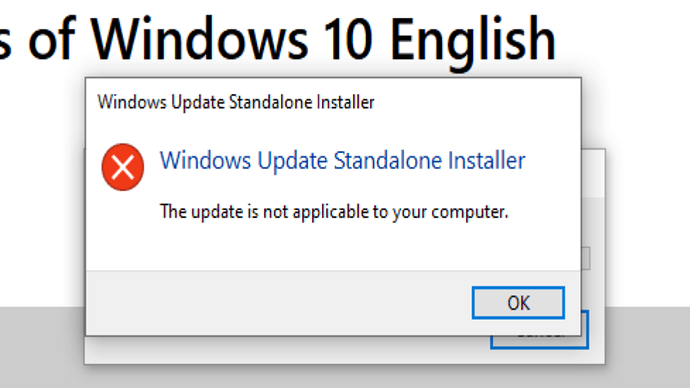

The camera is connected separately and usually does not need any drivers. On some versions of Windows 10, you need to install a Windows Media Feature Pack.
Try installing this and restart your computer, please:

The above link isnt compatable with my windows?
Says

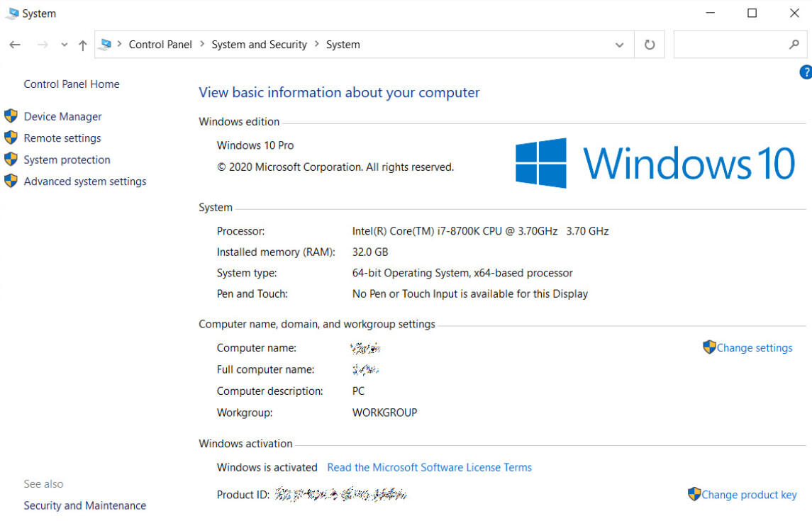

June 5, 2025, 9:09am
13

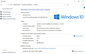

Which version of Windows are you using? Did you download the correct version for your CPU architecture - Likely 64-bit?
Please show a screenshot of this page:
That’s the Windows 11 machine?
If the camera shows up in this drop-down menu:
But you don’t see the preview below that, you will need to perform the
Camera Calibration and then the
Camera Alignment

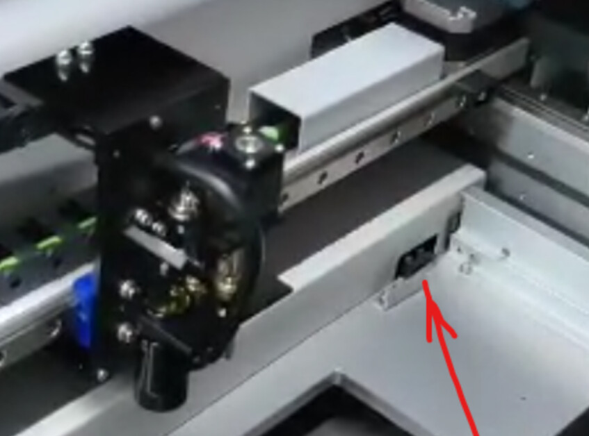

If the laser is not firing, try these suggestions first:
Check the coolant water level and top it up if needed.
Make sure, the tray is fully inserted and closes this switch:
Realist

Ive pulled out the tray and the laser head does not run, if I then slide the tray in works fine but again no laser?

Good. This means the tray switch is activated.
I assume, you have the lid closed.
