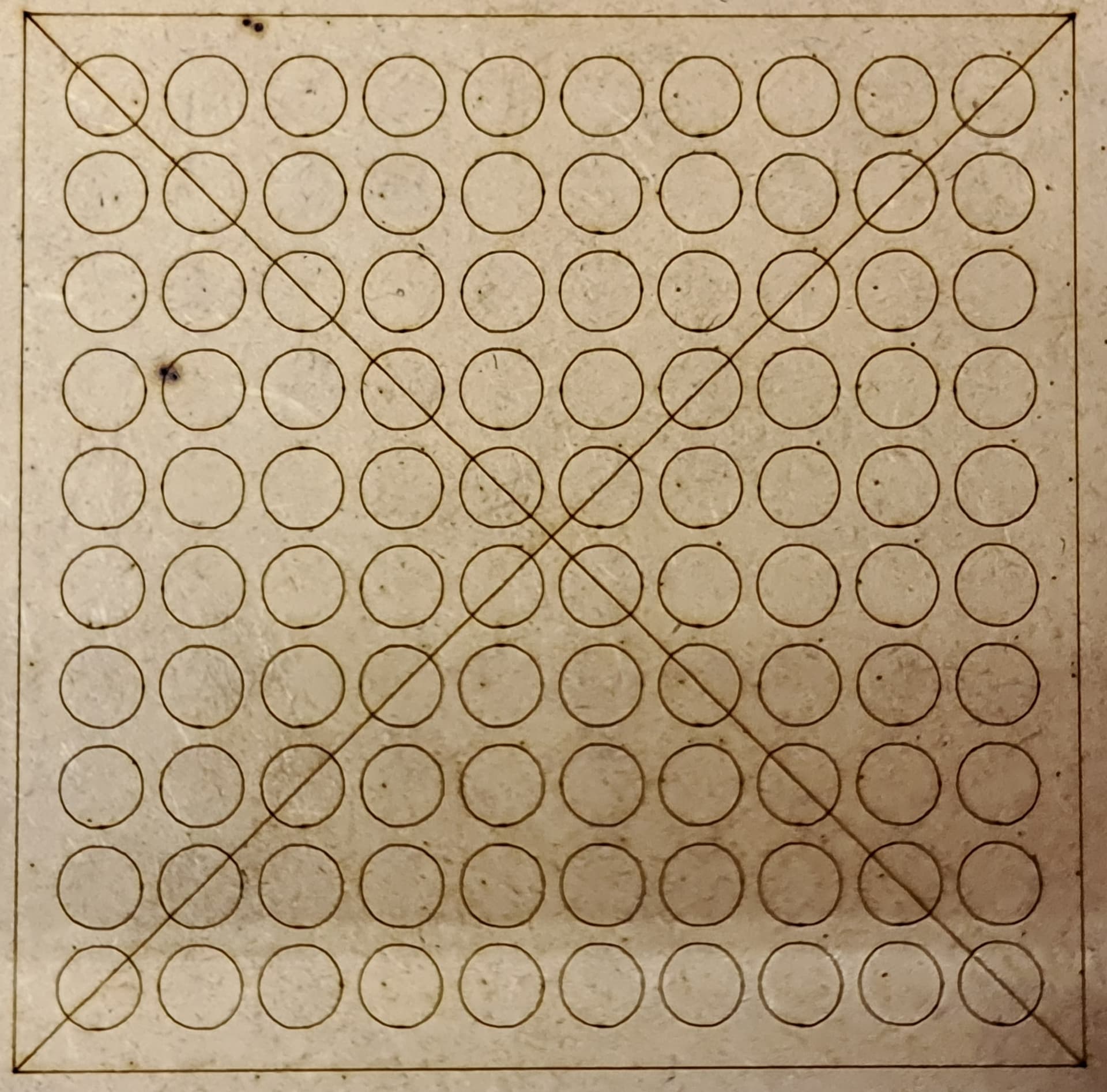

UPDATE:
Checked mirrors and lens, all secure and in good shape.
Have checked the rails, and they are all running smooth.
To check the rails, I had to remove the belts, and when I mounted them again, I didn’t made them as tight as before, and that seems to have improved on my lines.
See before and after picture.
It didn’t solve the offset problem, but see my answer to Daboo
I had a similar issue when I received my new laser with a ruida controller. It drifted when it moved to the left after moving to the right. I turned off “pwm rising edge valid” in the controller settings under the x axis settings and that solved my issue.
BINGO… Thanks David.
I had to turn off both X and Y “pwm rising edge valid”, but then it solved the problem.
I attach a picture, where I first ran the Lightburn file, and then the RDWorks file on top of it, with the same origin.
And… TADAA, no offset
It’s very curious that this didn’t happen with the RDWorks version but nonetheless, congratulations to a significantly better output and in the end with a quite small change.
Now you could tinker with your acceleration settings again (change them back or increase them step by step and see how far you can go with still a clean output).

It depends on where the direction changes happen - for the output to shift, you have to change direction in X at the same time as continuing a move in Y, or vice versa, and if you perform the opposite moves, it’ll “undo” the lost step.
I haven’t seen an offset due to the ‘rising edge’ setting on vectors before - usually it’s so small that it’s nearly imperceptible, but this test has enough direction changes in it that it’s obviously showing it as well.
