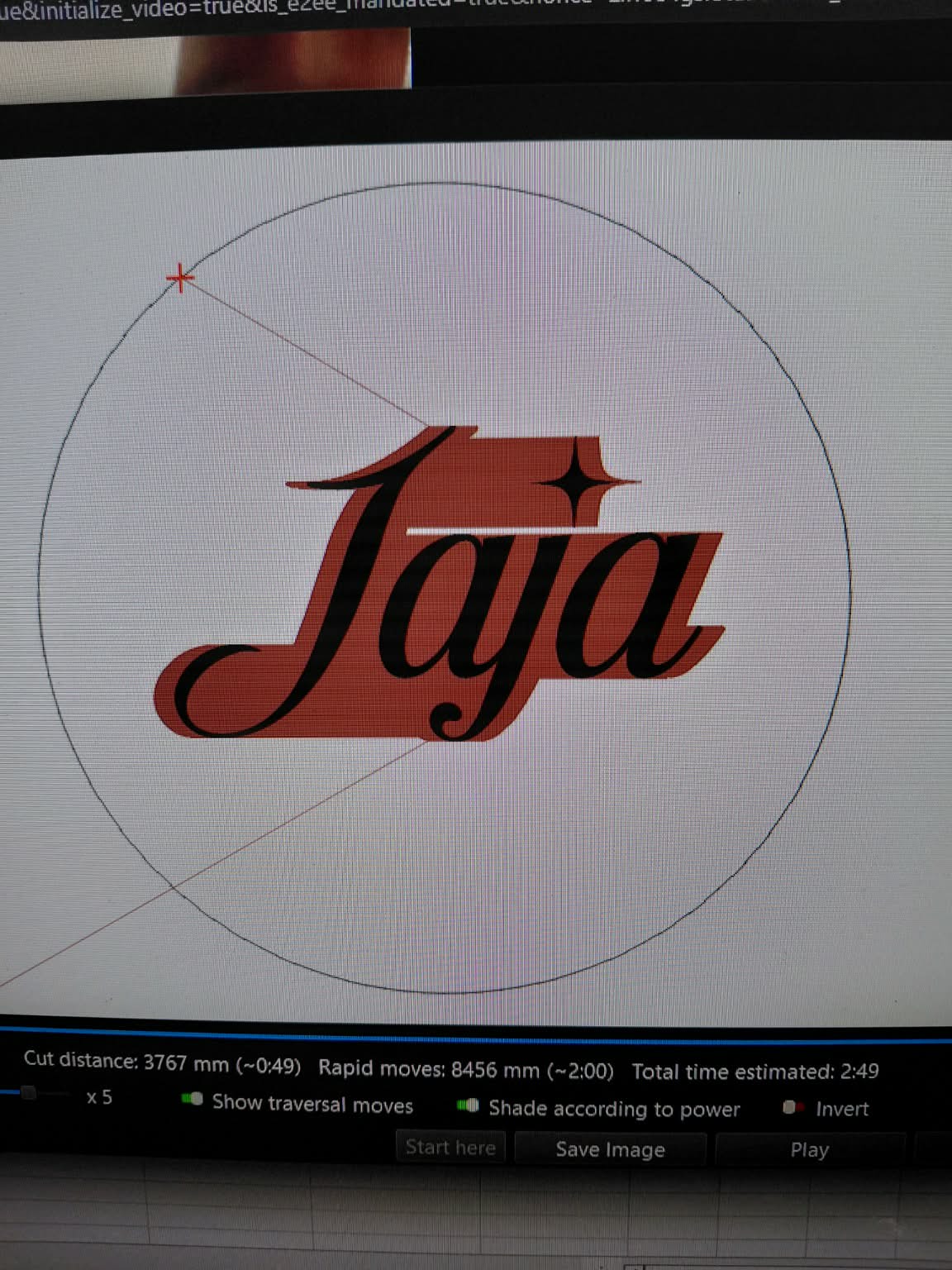

Lightburn Preview shows the text is centered or within the jig but actual framing and output is different
Hi everyone. I’m using 10w algolaser DIY kit, the problem is that in LB preview, the text or image is centered, but when I frame it, it’s different than what is previewed. And when i start the project, the output is not centered.
i have already checked tension belts and eccentric nuts, I have also tried algo app (what is shown and what is engraved is actually centered, so no problem with the app), thus, it seems to be in the lightburn issue?
can anyone help me with this?
To me, it looks correct. Did you measure the distances to the outer border? I could only measure it on the screen, but it seems quite fitting. Be aware that fonts sometimes don’t look centered because of the different weight compared to the size. The upper and left lines are very thin, but considered the same as the strong lines from the main letter bodies.

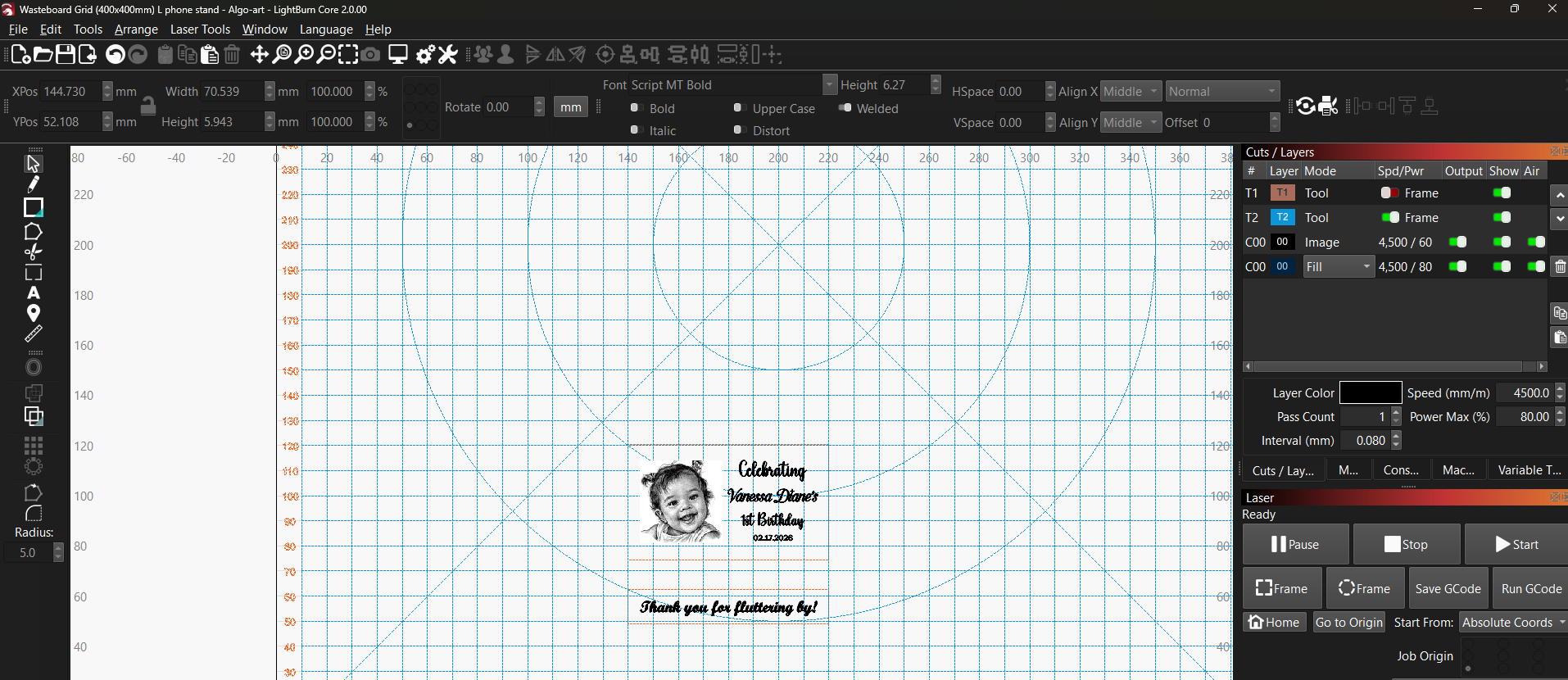

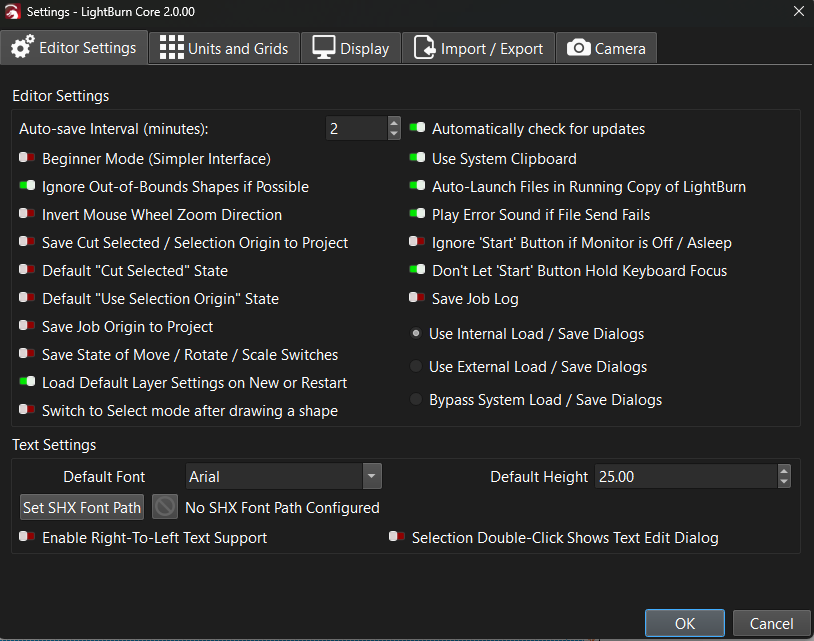

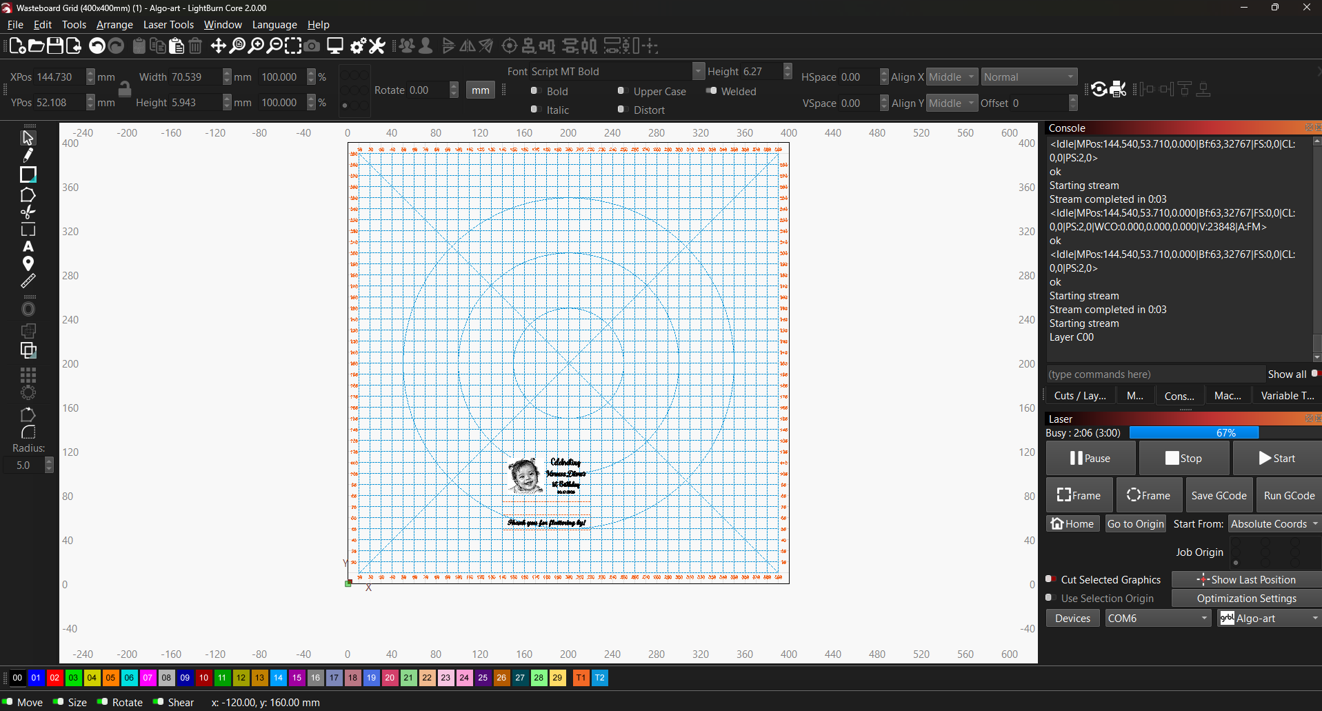

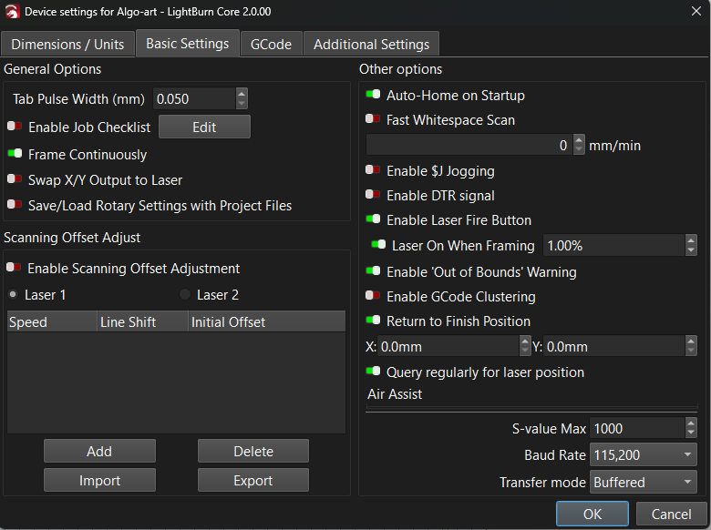

Help us see what you’re seeing. Please post a screenshot (not a cell phone pic) of your entire Lightburn screen with your project loaded and the Cuts/Layers Panel and Laser Panel visible. Also post a screenshot of the Settings Window (Gears icon) with the Editor Settings tab visible and post a screenshot of the Device Settings Window (Wrench and Screwdriver icon) with Dimensions/Units tab and also Basic Settings tab.

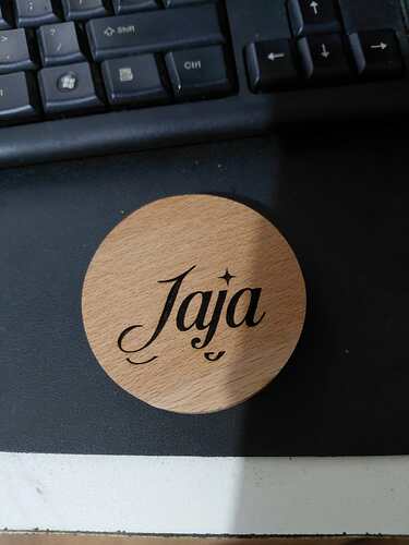

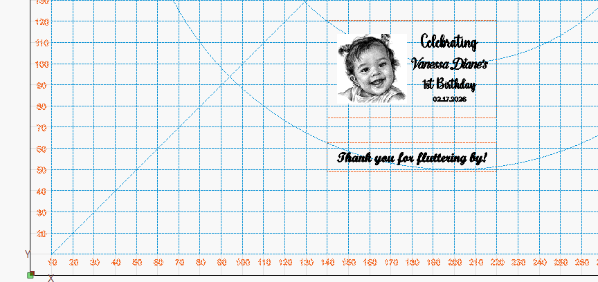

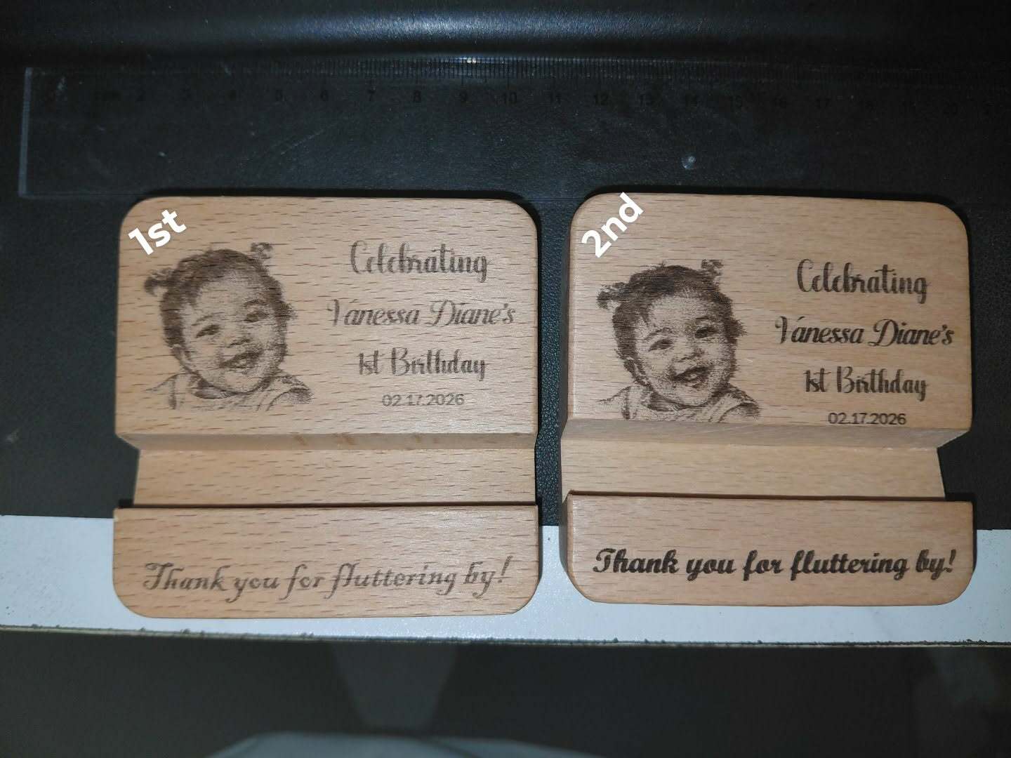

attaching also the 1st output which happened to be okay and aligned, but upon doing the next 2nd output, without moving the image, it showed a different output which is the image and text is lower than the first. I only changed the power and speed but not the placement of the image and text.
The interesting part is the text along the bottom appears the same on both. Did the bottom text engrave first? You didn’t show your cuts/layers panel.
I’m guessing that you’re missing steps on the move from lower to upper section, Y axis. Could be caused by a slipping belt or pulley or possibly incorrect asseleration settings.

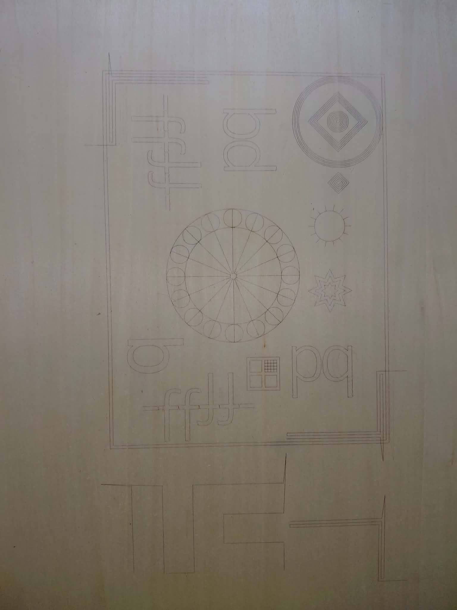

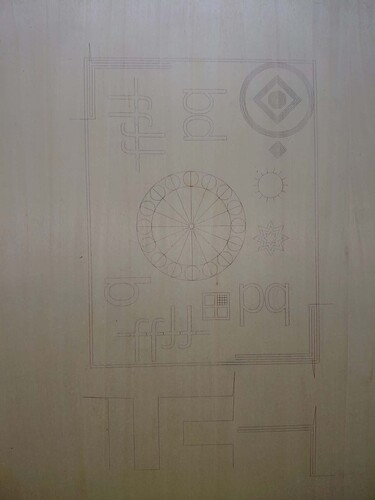

This test will help determine if you have a mechanical issue. Load this file, scale it proportionately to fit your bed and run it at high speed with just enough power to get a good mark on cardboard. Any discrepancies from the file will indicate mechanical problems. Upload a photo of the results so we can look with you.
BacklashTest.lbrn2 (68.8 KB)
I apologize, i must have missed taking a screenshot cuts/layer panel
So the photo is engraving first?
Yes, the photo is the first one to engrave.
How are you indexing the wood to the waste board? I tried and tried and tried to use my eyeball to line up my work. After struggling for way too long, I admitted defeat and resorted to using location jigs that hold the edge of the wood.
here is the backlash test
i engraved the wasteboard into the wood? and just align it with the lines and numbers i guess.
That is not what I was expecting to see. It looks pretty good overall. I’m stumped, sorry.
then does that mean it’s not a mechanical problem?
Not necessarily, but not obvious.
