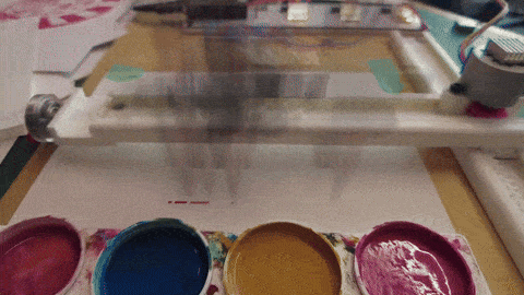

Made more progress in fixing the raster move for our openBrushograph. Should work with many other pen plotters too…
pakde_plot
Also modified all our scripts into Javascript. so it’s much easier to host it on a website, or run it locally in your browser.
First in custom gcode device, we modified a few things, as described here:

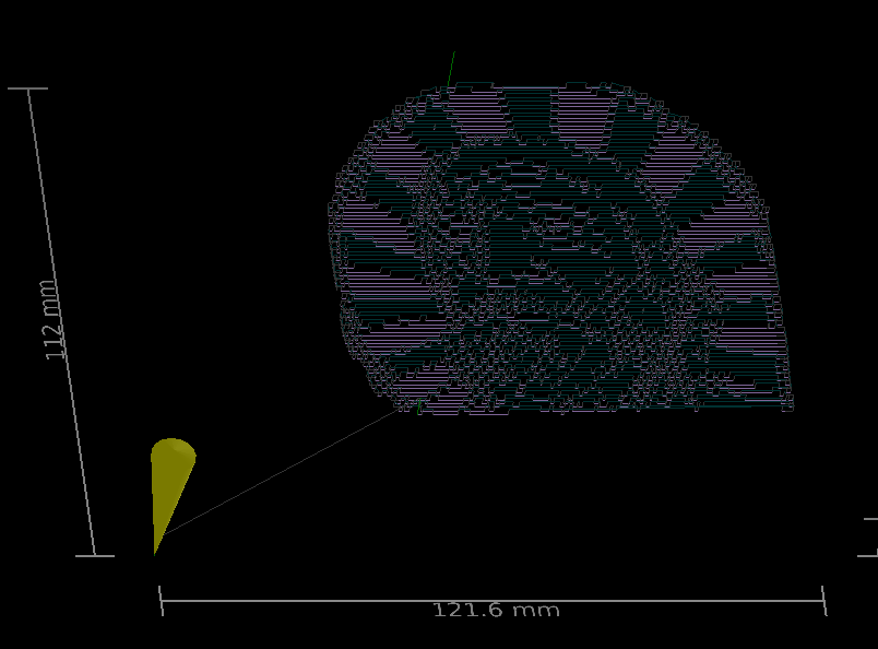

But it didnt help for the raster move… so just draw shapes, choose “fill” in layer, save the g-code and run it through the script above. then run g-code. (sadly Lightburn cannot preview the gcode, so i use UGS to check if all is ok)
