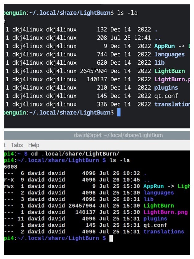

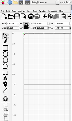

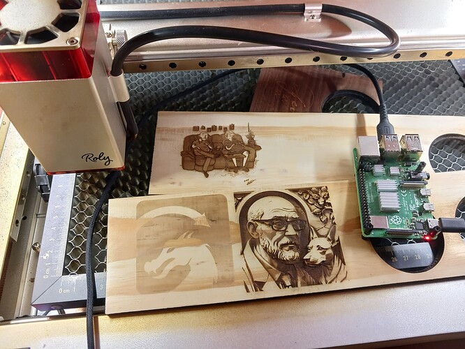

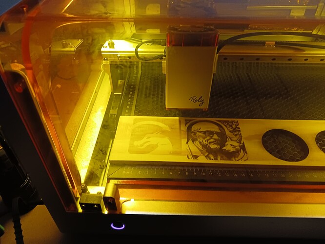

LightBurn running on Raspberry Pi - Now working

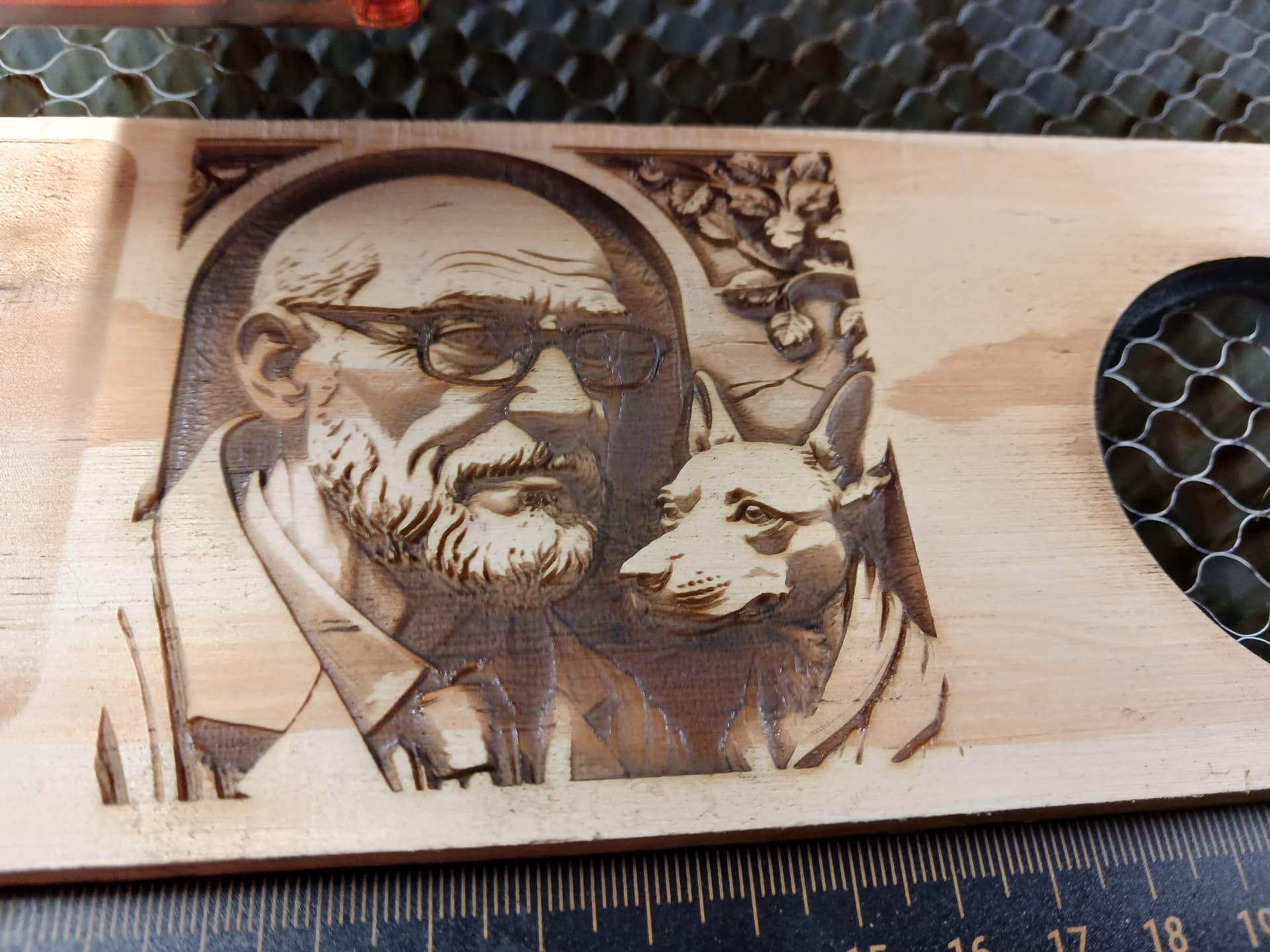

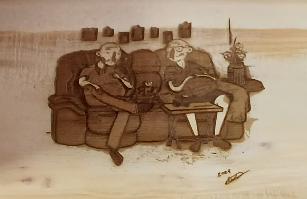

I successfully burnt my first image, ran off the pi. something I have yet been able to do thru virtual here, are you still working on getting the camera function to work? I can see my camera, and select it. but there’s just something missing in the middle, it’s way over my head, and really when I need the camera it won’t be an image so I can just swap pi’s. but it would be amazing to have it all. I can’t get over how good LB runs on a pi. thank you
I am not actively working on this. I don’t have a Pi that’s sufficiently fast enough to make that sort of troubleshooting tolerable and I suspect will take some deep analysis to understand what’s going on.
I know there’s also some work being done on the camera subsystem and some open issues with camera support on the Linux builds so I’m content to see how those changes affect the camera in the future.
I’d be thrilled if someone else were to run with this to see if they can sort it out, however. I just don’t have any immediate plans to look at it unless something fundamental changes or prompts a review.

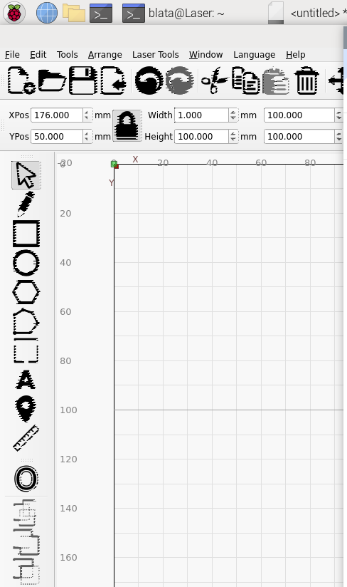

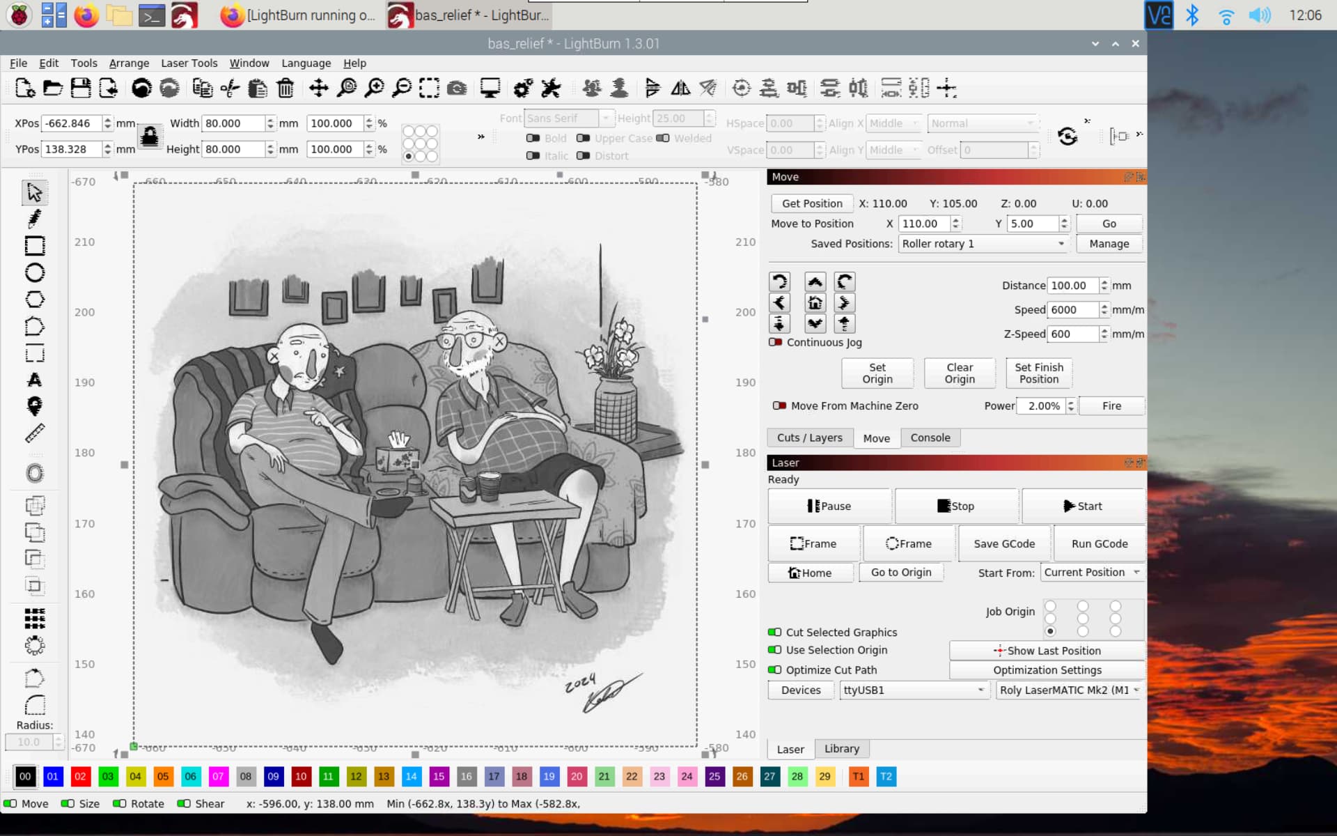

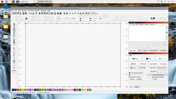

Hello, Thanks for these instructions. I have successfully gotten everything installed and working (sort of). At least for the first run.
I’m using a pi4 and as I said was successful at installing box64, and lightburn. I have used both the 1.6.04 and 1.4.03 versions of Lightburn and I get the same behavior from both. I start it up the first time and it loads and runs. I can activate the trial, and setup and control the Ortur laser.
The problem comes when I close and reopen Lightburn. It will load and than crashes with this in the terminal window.

I’m wondering if this might be related to the update check that LightBurn does on startup.
What OS version are you using? And are you current on updates to the OS?
Also, can you capture the full log from launch to segfault and paste here?
First of all, I don’t spend a ton of time on the forums anymore so I completely missed this! I had no idea you had gotten LB to run via box64, that’s really cool! Nice work @berainlb :slight_smile:
I realize this is on the tail of us dropping Linux but please be assured I do actually really like seeing this… I’ve been pondering getting it working on the Pi (officially) for years. So it’s cool to see it working in any capacity.
The update check happens 2 seconds after the main window is shown so if it’s not launching at all it seems unlikely to be the culprit.
One good way to check is to open the prefs.ini file in your preferences directory and set AutoCheckForUpdates to false - then it won’t check at start up and you can rule that in or out.
I got that message the first time I ran the 1.6 v or LB but havent seen it since.
Itls also funny you should say the update check is 2sec after the main LB window opens. Just long enugh to be excited about it working. Then you see the segfult in the term window :slight_smile:
I will edit the prefs.ini see what happens and report back hopefully also with the log.
[Update]
disabling the AutoCheckForUpdates in the prefs.ini file stopped the crash.

LightBurn on RPi4, displaying grand-daughter’s sketch of my “baby” brother and me at his 75th birthday get-together
Daughter’s Roly LaserMATIC Mk2 30w laser engraver
Fun project! :wink:
– David
That’s fantastic that you were able to get this to work.
To be clear, did you reference post #32 where I list out the overall steps to make this work?
At the time I deliberately left it at a high level for a couple of reasons:
  1. to ensure that people attempting this would be sufficiently skilled as to reduce any sort of support burden on the LightBurn team given that this was entirely experimental
  2. at the initial time of release there were a number of limitations that would make this method somewhat impractical. Specifically, the need for offline activation. That no longer exists but was one of the initial drivers.
Looking at your screenshot it’s not apparent to me that you used the provided archive files.
I’m nearly 78 years old, long retired, and really slowing down… and have forgotten way more Linux than I ever knew. I usually can “muddle” my way through however, given enough time… so please forgive if/when I’m not as technically correct as I should be.
Your post #32 wasn’t enough for me and I wondered about the LB and libs version differences, so I used a bit of BOTH @bhimio’s post#1 in this thread and your post #32. I was using LB v1.3.01 so downloaded the same .run file that matches the latest LB update my license allows for. After getting Box64 installed, I ran the .run and all files extracted to the .local/share/LightBurn directory as shown on both the Chromebook and the RPi4… both are running Debian 11 “bullseye”. It also added a LightBurn launcher icon in the applications menu.
I’m not certain but I think I downloaded either the tar files from @bhimio’s step3 (or your’s from post#32) and extracted it into a “lib2” directory alongside the “lib” in the .local/share/LightBurn directory. Using @bhimio’s BOX64_ALLOWMISSINGLIBS=1 BOX64_LD_LIBRARY_PATH=lib2 ./LightBurn from the command line, I actually got LB to launch and display on screen. I’m not certain what, if anything, I did to get enough libs “seen” so that BOX64_LD_LIBRARY_PATH=lib2 ./LightBurn was then enough to launch LB. Then I simply moved the “lib2” contents into “lib” and was able to launch simply with ./LightBurn… and from the LB launcher icon in the menus. Once everything seemed stable, I was able to activate the license and connect to my laser engraver.
somewhere I have a script I wrote which takes an rPi SD image( 2 directories ) and compresses them into an X.img.gz file so getting a working version of what was on the disk was just extracting the image like you normally do with rPi images.
It’s just so much easier for people setting up a new image for a particular project, like a laser engraving or CNC machine when it’s already been done before instead of everyone going through all the girations.
I have done the same with Lubuntu customized images for running MakerBots, 3D printers, teaching Arduino or IoT projects etc. If I ever get LightBurn running on the rPi, I’ll do the same and post a link to my gDrive folder for download.

I’ve never seen that issue with the icons before. If you change the size of the icons in Edit->Settings does this change anything?
I’ve not seen this in my limited testing. What version of Pi OS are you running, are you up to date on updates, and have you used the instructions on post #32 to setup LightBurn?
This is at “Large” setting. It looks the same at any setting.
As for the crashing. I’m running 6.6.40 with all packages updated. Of course this time 1.6 fired up with no problem. Oh well.
