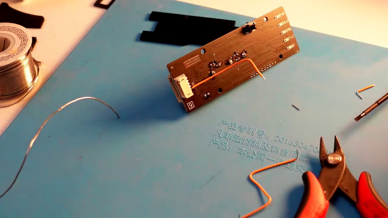

July 15, 2018 is Probably about right. We may need to look at a detail on the control board itself. There was a batch of early boards that needs a jumper-wire to work with GRBL.
These are the ‘Build Options’ that were selected for the controller when the Firmware was compiled and flashed. It can be changed but it can be tough.
