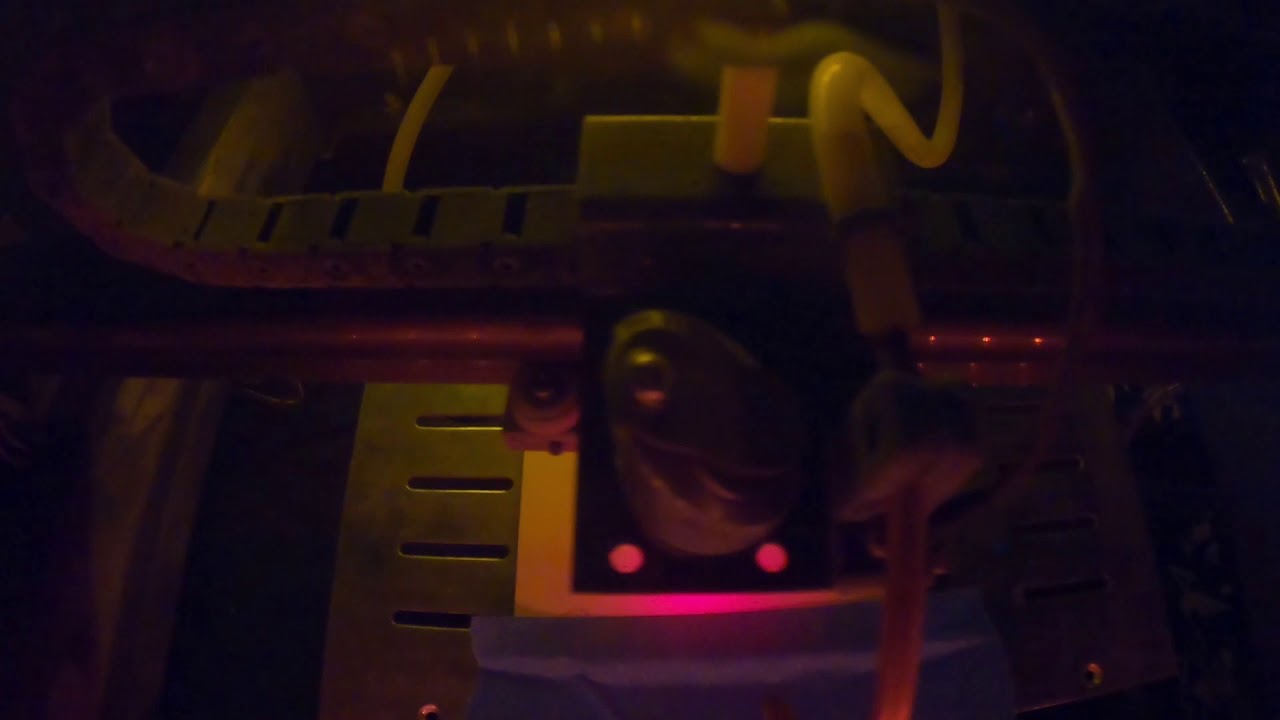

Since then I’ve done a lot of testing. Dropping the DPI and speed has helped quite a bit, but I’m still having issues at (what I think are) reasonable settings.
At .1 Interval at 150 mm/s, I’m still getting stuttering and slowing down, which leads to uneven engraving. This is with text, it’s worse depending on what’s being engraved. I also have a problem with it printing slanted, but that’s reduced when I reduced the speed. Please see below:
Picture of the settings:
So my question is, is this normal? Is this just how it is or is there something wrong?

I should have specified, All of the problems listed above are with the Cohesion3d LaserBoard and included power supply. The only thing the original power supply seems to be running is the laser itself, and all of the problems remain even if the laser power set to 0.
The Laserboard does pull more current than I would have thought at rest (if the DC power connector is unplugged/plugged in it sparks like a mofo.)
I’m using the same software as you are with Clustering and I absolutely can’t even get close to 300 mm/s at .05. I’ve adjusted the power settings up to 1.0 in the config with no change. Something seems wrong and I have a absolutely no idea what it is. I just can’t imagine that this board is so much more limiting than the one that came with it.

If you update the firmware to enable clustered gcode, it will improve the performance a lot.
Hi Oz,
It has the latest firmware and clustering is enabled, but I’ll re-flash it just to be sure.
Not the latest, but the specific cluster mode from C3D
It will run a bunch of firmware, but only that one will support cluster mode
