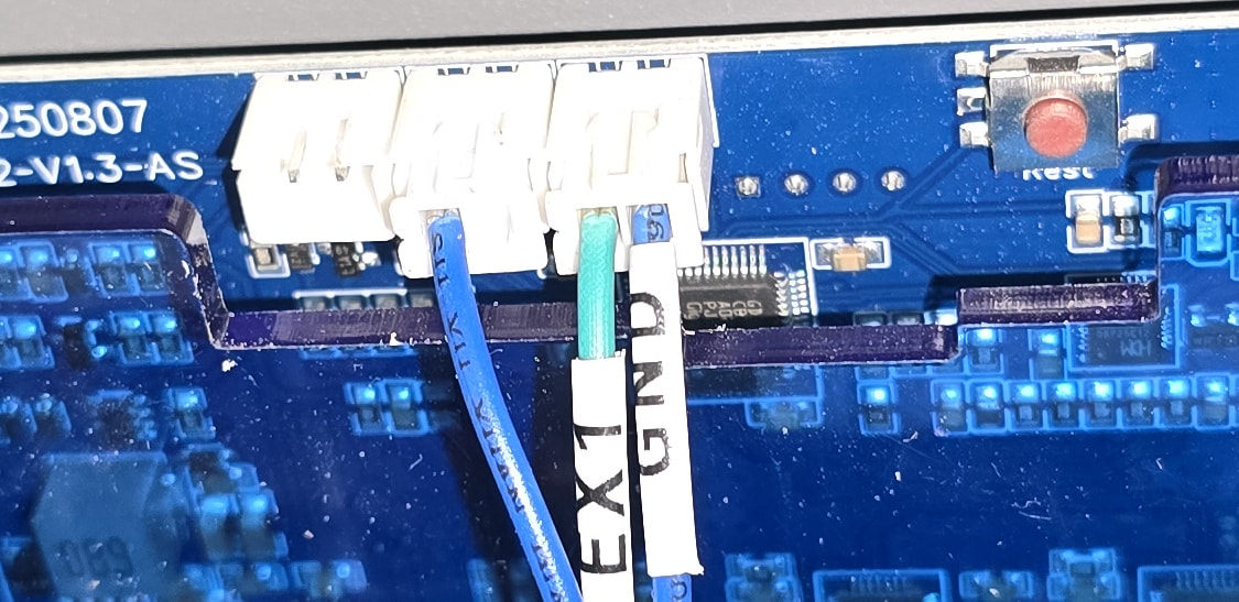

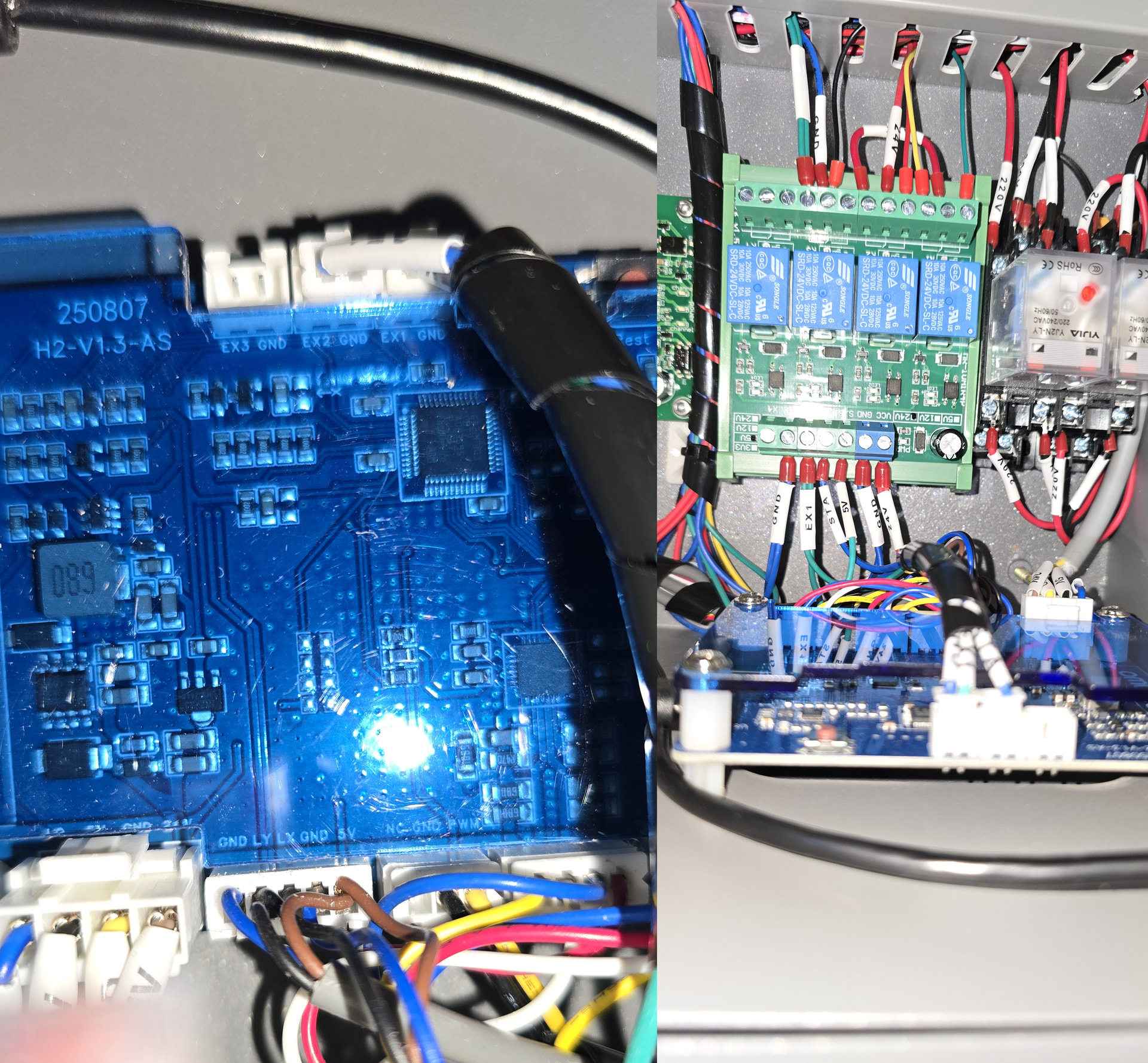

I have a little omtech K40+ that uses a GRBL controller that talks to lightburn, but as it comes from the factory the air pump and exhaust fan run all the time the machine is powered up.
The controller on these machines is pretty much unknown it seems, i’ve seem pictures where they have evolved a little adding more outputs, and the one i have has 3 ext. outputs, 2 of which are in use but they seem to be used for the complicated interlock omtech uses on their machines (that needs you to press a reset button every time you’ve opened and closed the lid, which is extra annoying to say the least)
photo below showing my controller board with it’s 3 external outputs, and then the relay board they are switching.
As there are so many different GRBL controllers out there on the smaller laser cutters that use the GRBL method of control, i know it’s impossible to get lightburn to talk to all of them beyond the basic machine controls (axis moves and laser power)

What is even more annoying, my board has 3 aux outputs:
But from what i can tell they are used with triggers from the lid switch interlock board to lock the laser out if you lift the lid, making you press the reset button on the laser before it will reset after closing the lid.
Of course there is no info i can find about this board, so it’s very likely those 3 aux outputs could be repurposed to trigger from G-code commands, but without knowing how to change the firmware running on the board we can’t do that,
as you can see from the photo above of my boards 3 aux outputs, i have one free, but i can’t find anything that triggers it yet,
the other 2 go to the relay board that cuts power to the mains relays feeding the HV psu and exhaust fan, but they only seem to trigger when the lid switches are opened.

EX1 is an output, but EX2 seems more an input. The circuitry behind those three pins may not be able to do what you want, even if you could tweak the firmware.
