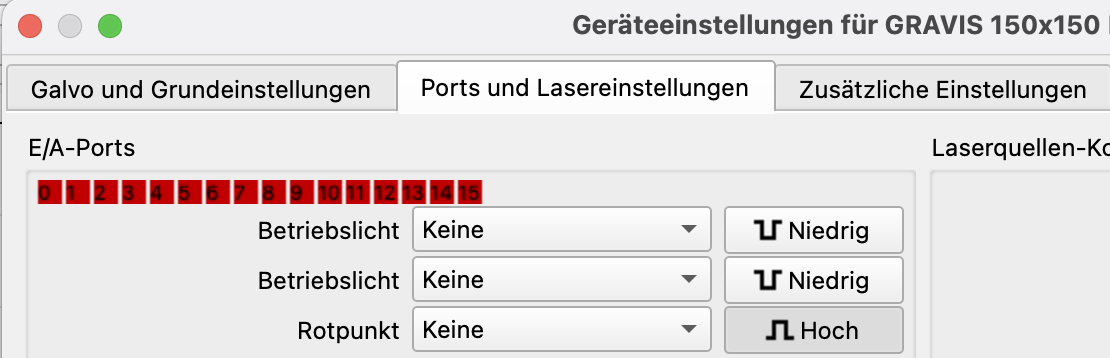

Dont know what language update means but when you select german as language you have the same string twice in port settings. This is confusing and this error maintained through out a few releases
String “Betriebslicht”
Thank you for reporting. Investigating further. :slight_smile:
Thank you for reporting. Share the steps you are taking and a few screenshots to help us see what you are observing. :slight_smile:

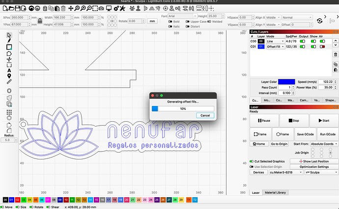

I was just trying the RC-9 and immediately had some issues while trying to preview an offset fill if I try to cancel it with the button or esc button it just opens again over and over.
Thank you for reporting. Investigating further… Please share a screenshot of the Cut settings for that layer. In particular, I want to check the Interval setting. :slight_smile: With that, I will generate a report. I have seen reports of the Preview taking some time to complete when the Line Interval is set high.
Interval is right there 0.1
Well, yes it is, thank you @Javo01. :slight_smile: I need more coffee, it appears.
What is your reasoning for using ‘Offset Fill’ for this job. I ask because Offset Fill is not intended for “general use”. Offset Fill is intended for designs with a lot of space between graphics, to cut down on the amount of travel time necessary to fill large, hollow shapes. For the work you share, I suggest you use ‘Fill Shapes Individually’ with a normal Fill.
I have generated an internal report.
@Rick This one in particular doesn’t really need the offset, but I’m used to see how the offset fill would handle the time because if there’s a big differences in time between offset and just the normal fill I would use then there should be a way to arrange the groups to improve the engraving times
There are several options available for how the fills are done. The following short explains:

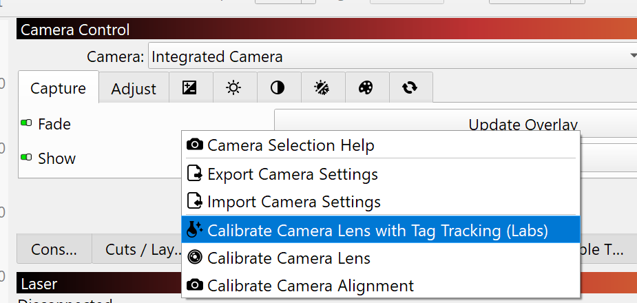

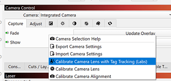

@Rick I found the experimental, it used to have an item within the lasertool menu for experimental calibration, now I see it is only on right click on the camera panel.
Oh, yes, the Labs feature with Lens Tracking.
Some great wizard put a lot of work into this. It’s the future!
Please report any bugs or issues.
