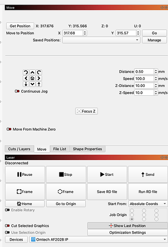

In version 1.7 if you move the head to any position of the laser using the control panel then go into LB and hit the Get Position button it would move the show last position on the screen with the little cross (don’t know what it is called) , worked great. Now with 2.0, the get position button when clicked shows the coordinates but the little cross does not move. If you hit the arrow keys in LB to move the head, it will update the location.
Are you experiencing any issues running LightBurn through Rosetta?
Tony - Get Position is a GBRL ! query, it will always report the current machine coordinates.
So the behaviour is the same on 1.7 to 2.0
Maybe you are referring to “go to Origin” on Laser Panel?

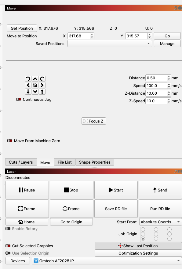

I am talking about when you hit the get position button with version 1.7 it moved the cross hairs to the exact location on the screen where the laser head is on the bed.
With version 2.0, that button only gives the coordinates but does not move the cross hairs on the screen to the exact location of the laser head.
In order to get the cross hairs to move is by using the 4 arrow keys and then the cross hair is moved in LB to the location of the head.
I have toggled on the show last position on.

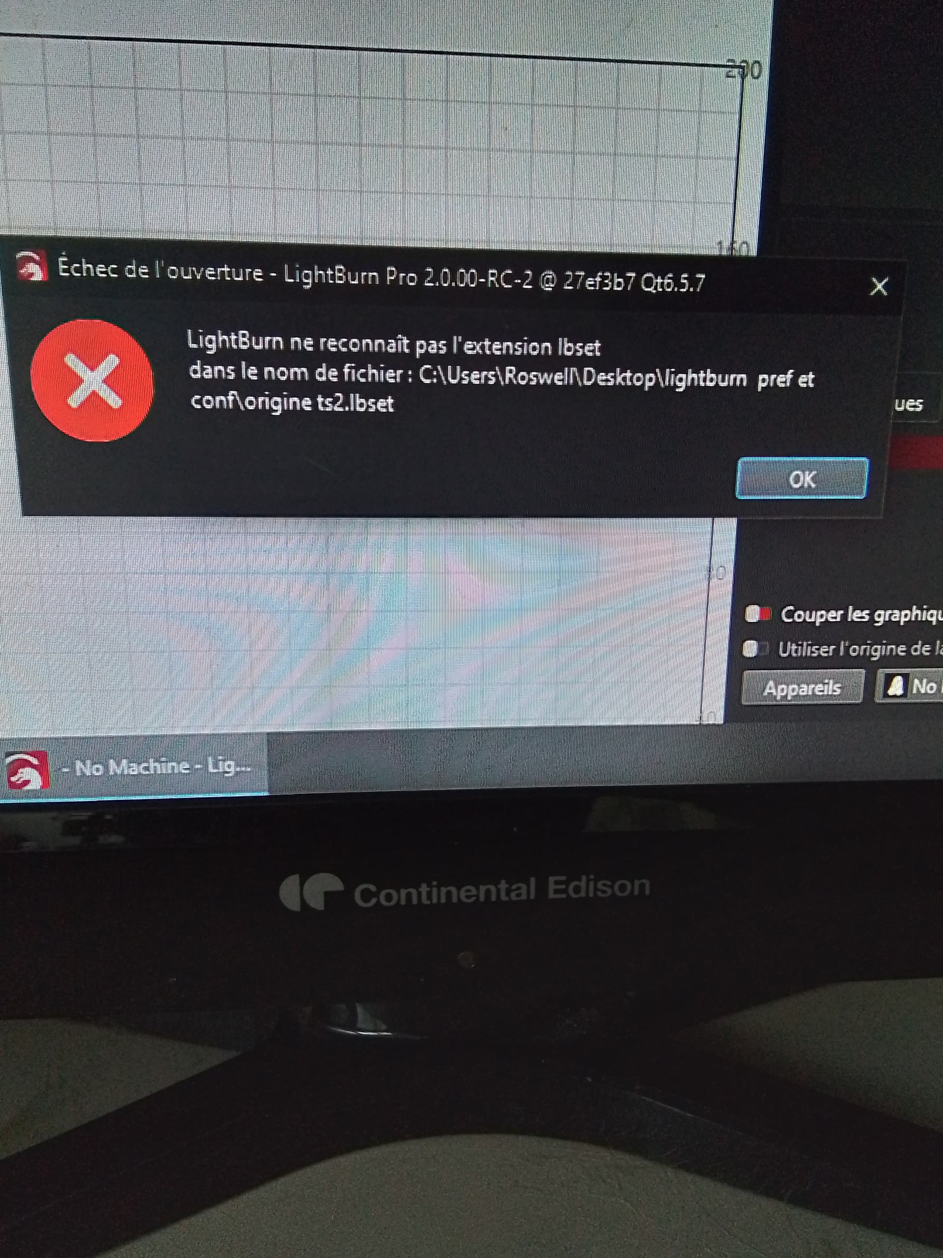

lightburn 2 does not recognize its own files!!!
Wtf!

Do you have enable the experimental parameters?
