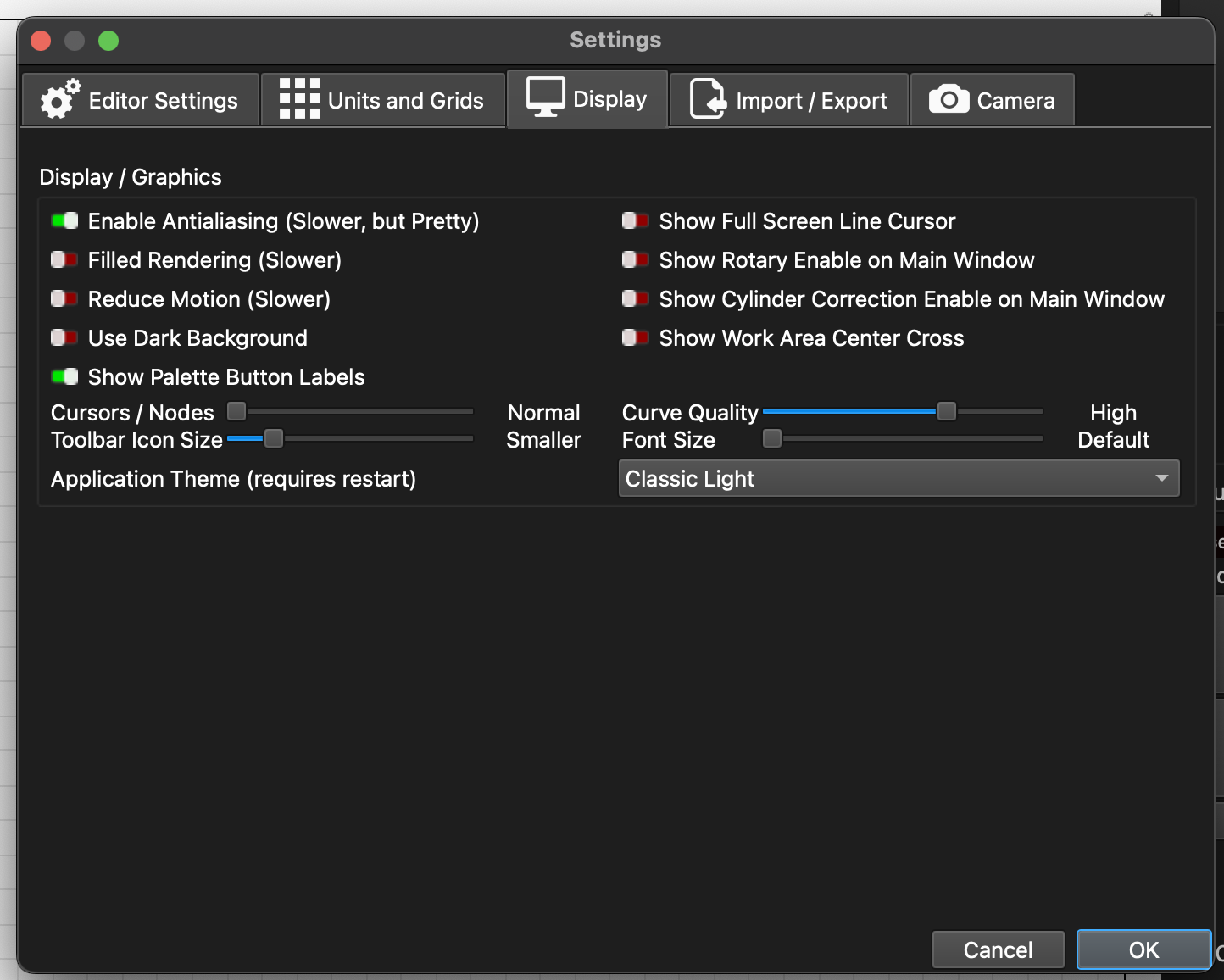

Steps to reproduce (100%): I change it, I note that it says it will require a Lightburn restart, I restart Lightburn, it’s dark again, and the setting has reverted to System Theme.
I can’t believe this is a common issue as there’s no way it would have reached RC3.
In case it helps…
Not here, i.e. I can’t reproduce it.
(MacOS 15.3.1, LB CR3)
Are you running through the wizard JUST to change the device units?
If so, don’t do that. Go to device settings and change it there. There is logic in the wizard that is only meant to be run once.

No. It’s only happening when you create a new device. If you edit the device the same way, the bug is not there.
Thank you for your interest, Adam. When my post was moved by admin it lost its title, it was RC3 reverts to “System Theme” when I try and change it to Light or Dark.
Which hopefully is self explanatory.
My knuckles have been rapped for making the title a critical part of the post. Lesson learnt and apologies all round.
Yes, that was me and I forgot to include the post title. Appoliges @adammhaile :raising_hand_man:
Cannot reproduce. RC3 on 13.7.4.
I’m able to freely change between System, Light, and Dark and the change will persist between application restart.
Perhaps a prefs file access issue?
It seems this is an issue - already identified and corrected for RC4 - that only affects newer MacOs versions
@bdge Next RC will have this corrected.
Thank you for reporting

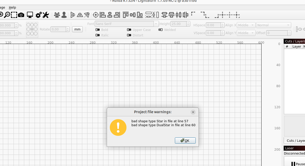

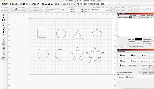

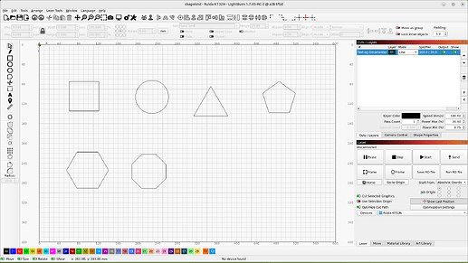

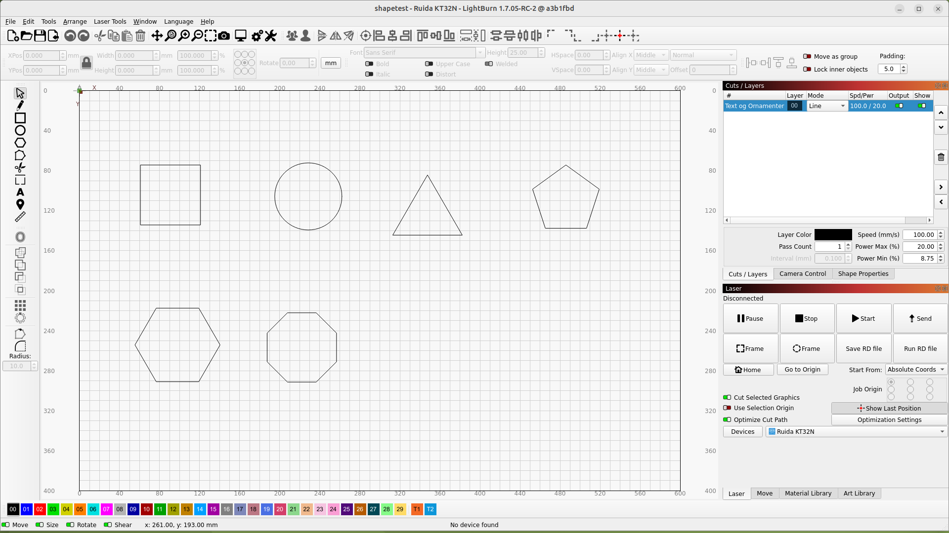

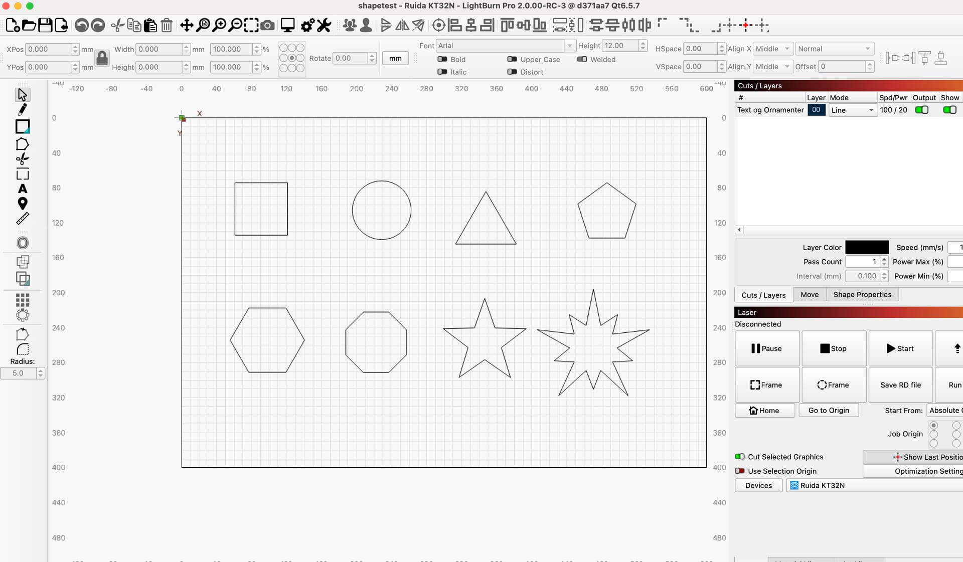

Here’s another problem, a bit ugly.
Shapes, some of the new prefabs in LightBurn, are not recognized in the latest Linux version.
It’s the original, made in RC3 on a Macbook.
Here is the message when opening the imported file for ver.1.7 on Linux
…and the result
export/import file:
shapetest.lbrn2 (14.8 KB)
Hello Bernd
This is a known issue - the way to override it is to convert the shapes to path first.
As they are primitives that do not exist in 1.7.0x, the older versions of LightBurn wont know what to do with the XML data on the LBRN
