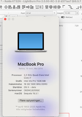

Could I confirm with the 3 of you
a) What Mac Type exactly? Macbook Pro? what Processor type?
b) OS version
c) The behaviour is repeatable on 2.0 saving to local desktop - and not repeatable doing the same on 1.7?
d) Any network drive attached, even if not in use to save files?
e) Important as well, when doing a Save As, does the delay happen also when browsing files and folders, or Only at the save time?
f) Maybe less important but any security software? Antivirus?
Lastly - What lasers you guys have selected when trying this. DSP via network by any chance?
Hi Gil,

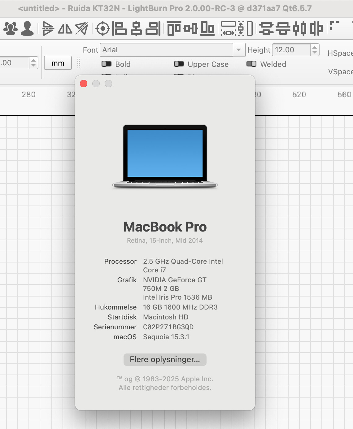

On Macbook 1:
A+B: see picture
C: Thatâs correct, there are no delays of this kind in version 1.7.
D: No
C: The delay with the colored pause wheel is there periodically, depending on autosave, itâs there when starting LB by retrieving a file, also the last used one, and the delay with the spinning wheel is there when exiting LB, also when I donât ask to save the current project.
F: No, no Antivirus

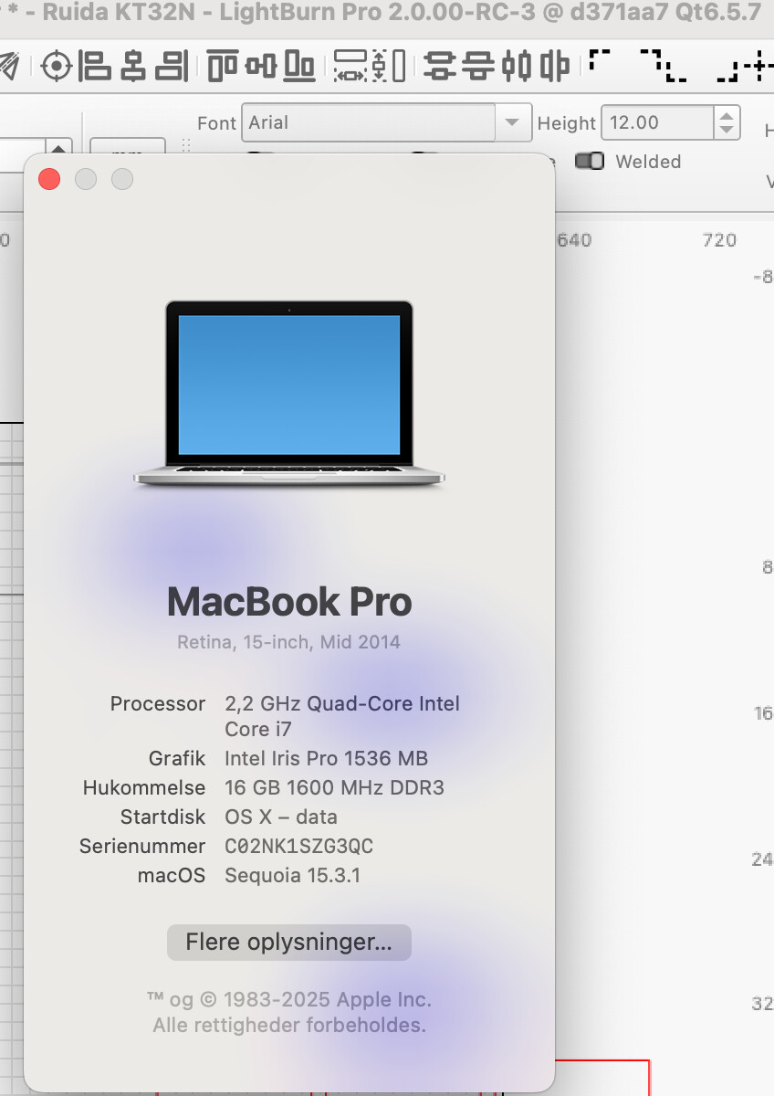

Here is my second MacBook, when it is online with my laser there are no delays either.
It is only a small test I have done but it seems to be related to whether the laser is âonlineâ or not.
It could also be interesting to try a fictitious or no laser in the setupâŠ, but that will not be until tomorrow ![]()
I am now able to replicate it by using a dummy Ruida controller and Network.
There seems to be a change in the behaviour of file handling between 1.7 and 2.0 that causes this latency.
I am investigating and will let you guys know when I get updates.

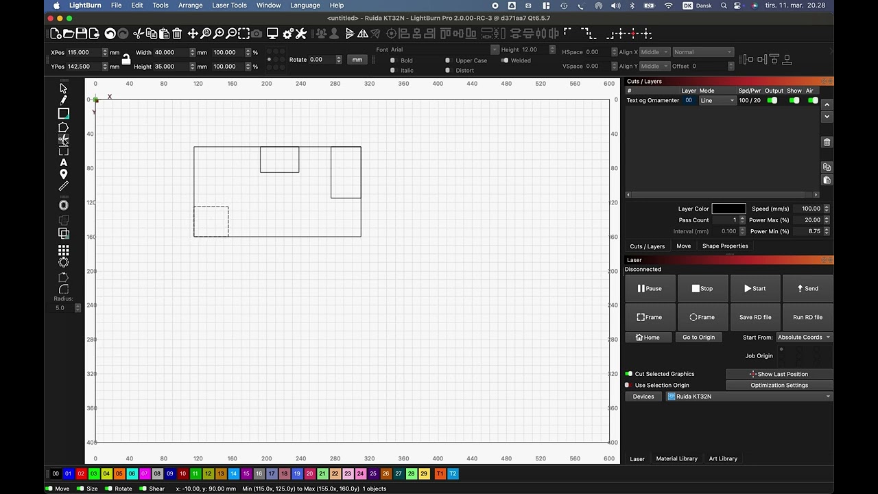

Scissors tool âmismatchâ
The video is made to explain a small problem in LB
I donât know if this is a known or new âproblemâ, but I just wanted to point it out.
Thanks for drawing our attention, @bernd.dk. Digging into it⊠![]()
Update: Report generated. Oz or Adam will look into this. Iâll update again once we have their feedback.

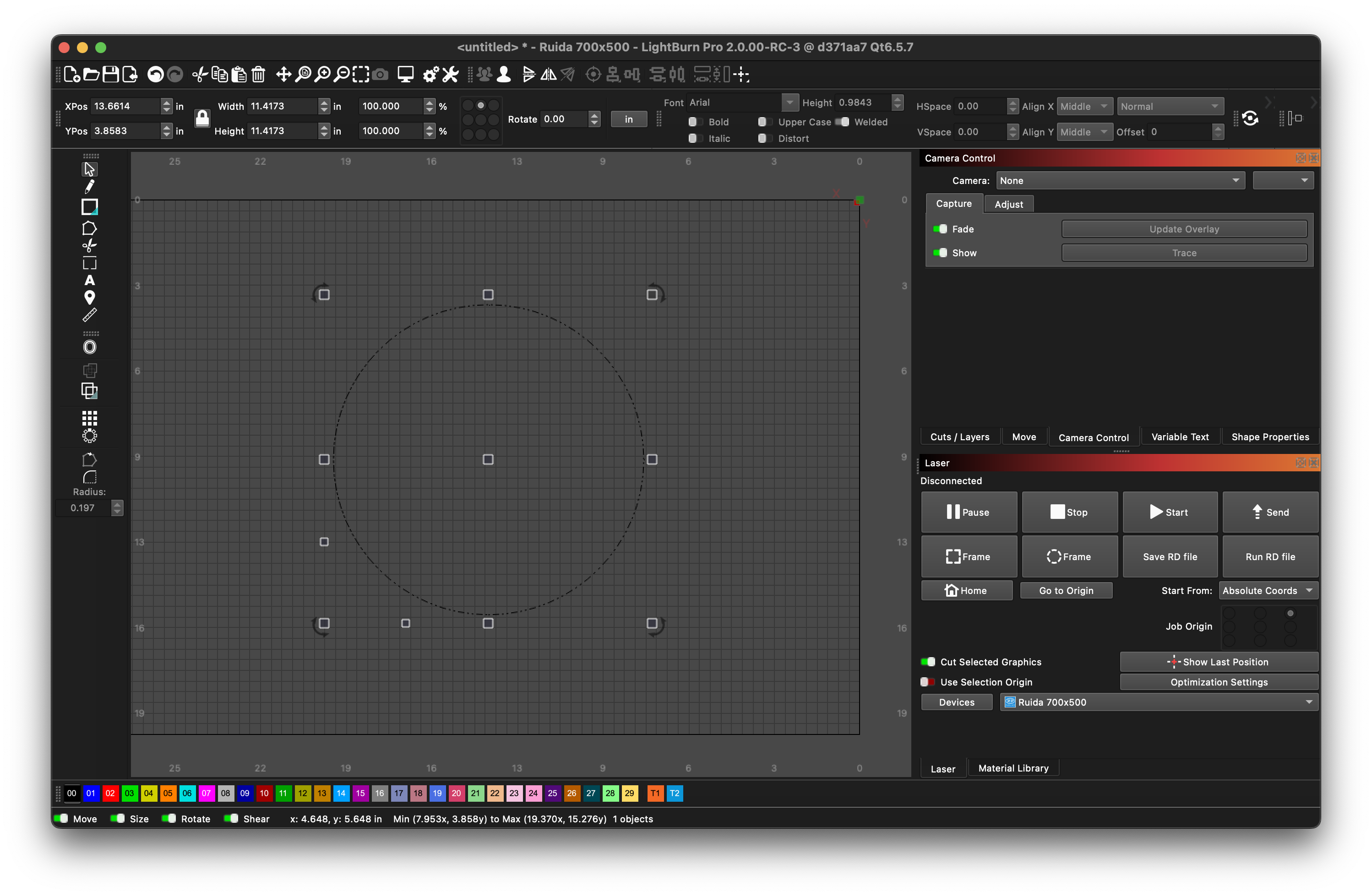

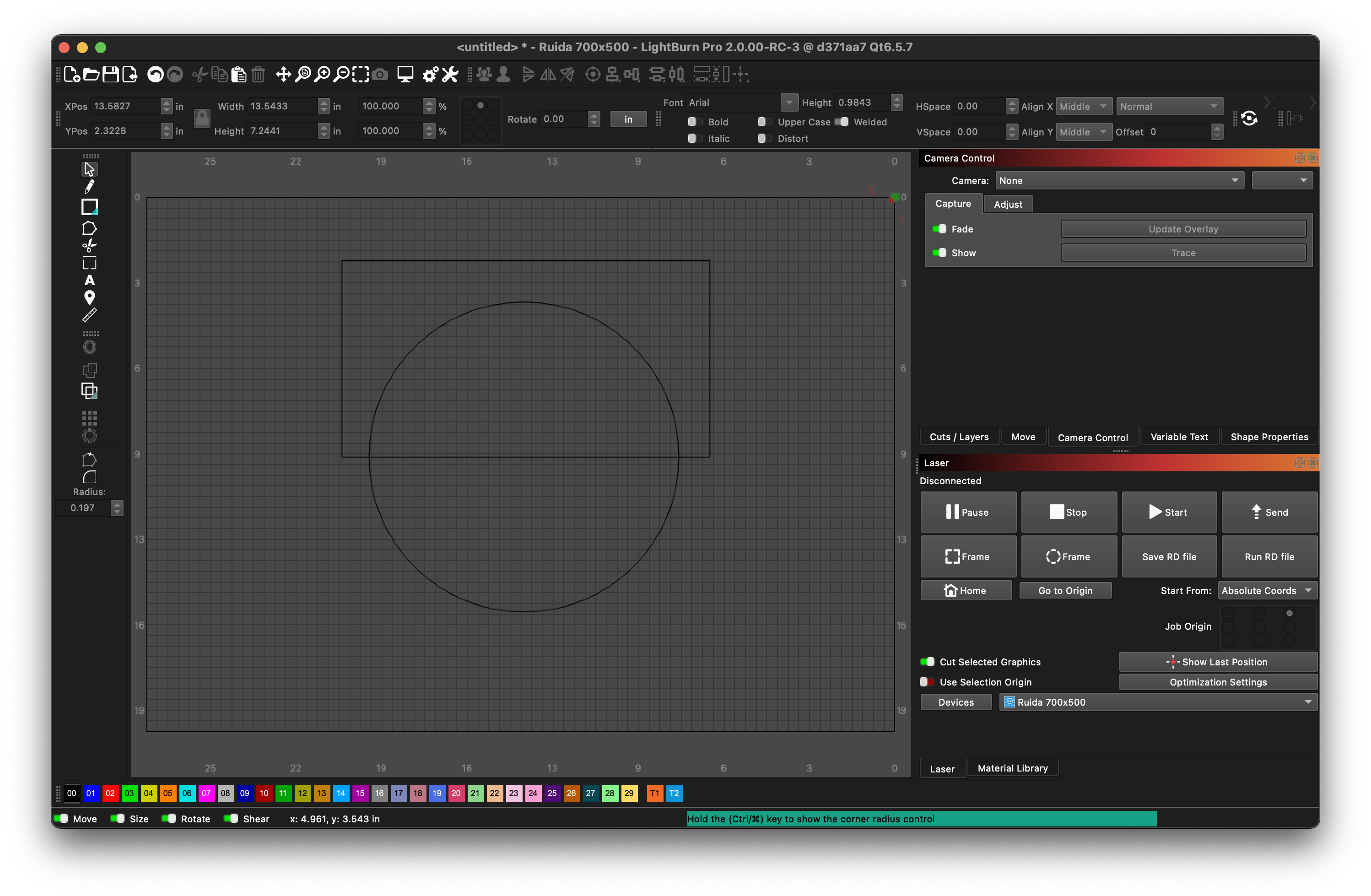

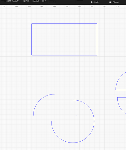

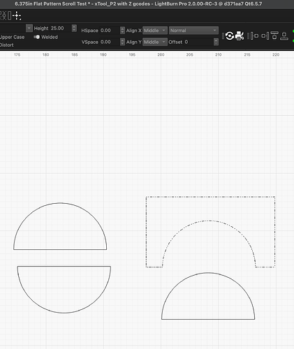

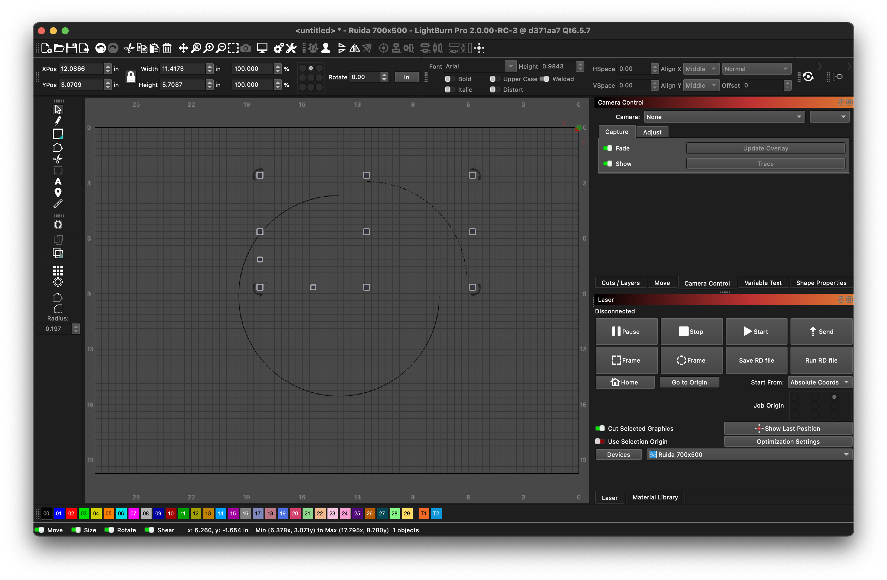

Iâm noticing a problem with Cut Shapes behavior under specific conditions. The resulting cut shape does not match expectations.
Before:
After:
The resulting cut shape doesnât match the semi-circle expected and instead results in a quarter circle plus what looks like 2 corners of orphaned nodes.
Similarly, this setup results in what looks like no change:
After:
It seems that these issues occur any time that the center of an ellipse intersects with any portion of a rectangle.
Iâve tested this also on 1.7.07 with the same results. I did not test on other versions but I donât recall this being an issue previously.
On macOS 13.7.4 in these tests.
It looks like you may have been using Fill mode. After testing, seems like this issue only exists in Line mode.
Can you retest with Line mode?
I can confirm the issue also exists on Windows.

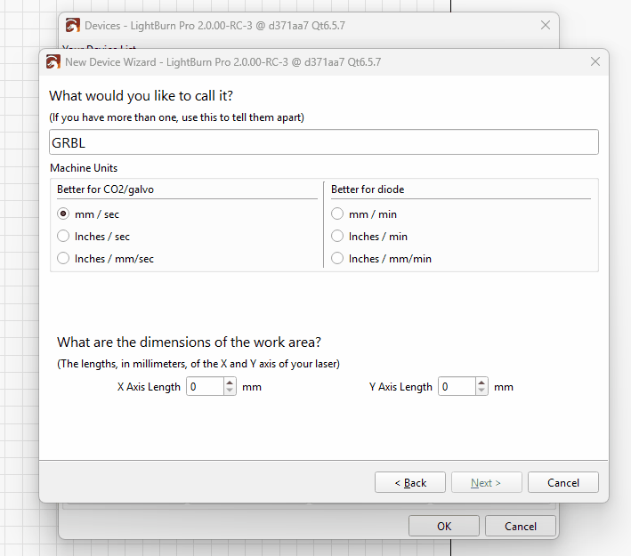

on my galvo mopa, if i go to laser tools, device settings, the time base always changes to mm/min. going back to device settings and selecting mm/sec will not change it back
had to close and restart lb
Following my last post: I now found out why every so often my devices are renamed to the default name again. I thought it was randomly, but itâs because the name is reset if you switch units:
Since I usually start from top to bottom, I name the device, and then change the units. If you do so, the name is reset if you make any change to the units. So sometimes it happened, and sometimes it didnât.
I can Definitely replicate this.
Reporting internally.
