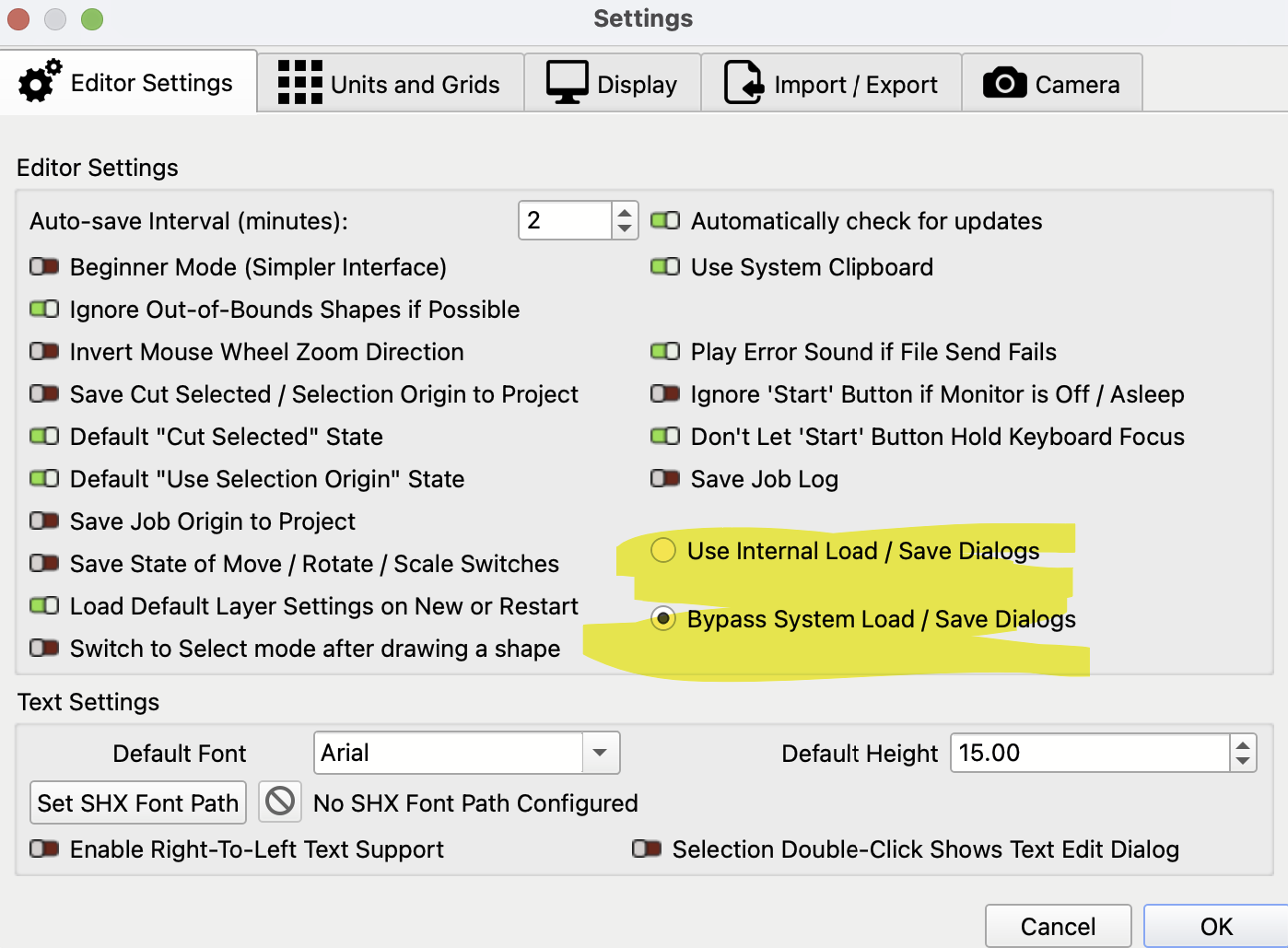

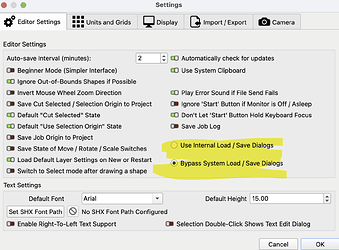

I’ve tried with both settings for Load / Save Dialogs- “Use Internal”
and “Bypass”
Might be a shot in the dark, but can you see if changing this helps?

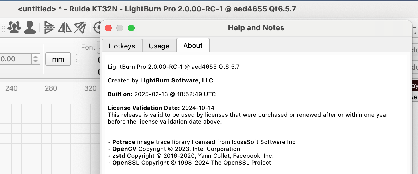

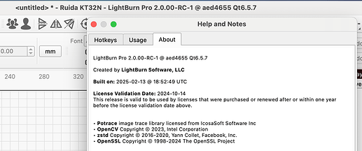

I downloaded and installed RC1, but during installation I couldn’t see exactly if RC1 and RC2 are merged, hence my screenshot. I will download RC2 and try again.
It has no effect, the interruption occurs at the autosave rate (but it’s more of a feeling, I haven’t measured the time).
RC2 has the same problem as RC3, here at my place.

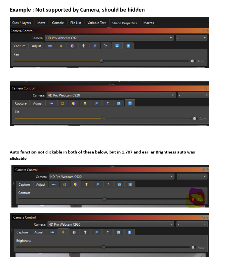

@gilaraujo Regarding hiding functions for the camera, just like zoom, tilt, pan - if the camera does not support them, they should not be in the camera app panel. I know zoom works with my camera regardless of the use case, but the function does not work in the camera app. As well as the auto function does not work for brightness and contrast, as this is confusing to end-users who will try to click it, and they are non-clickable - thus I get emails about this, these should be hidden just like the functions that do not work with the camera. Regarding sharpness, when doing intricate engraving as an example on jewelry, the sharpness aids in the the smallest details when zooming.

I am also experiencing the spinning beach ball on a Mac when saving files in RC3. I used a new empty file saved to my hard drive for testing. I was able to get screen recordings with the beach ball and sent them to the betasupport email address. I am getting the same results with both settings for Load / Save Dialogs.

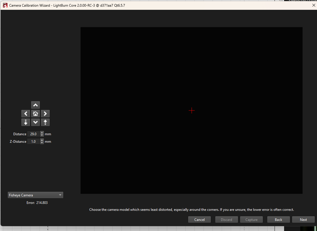

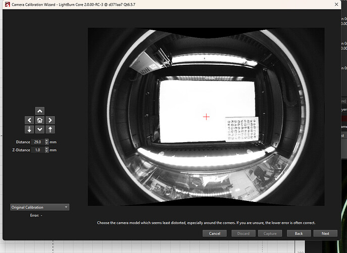

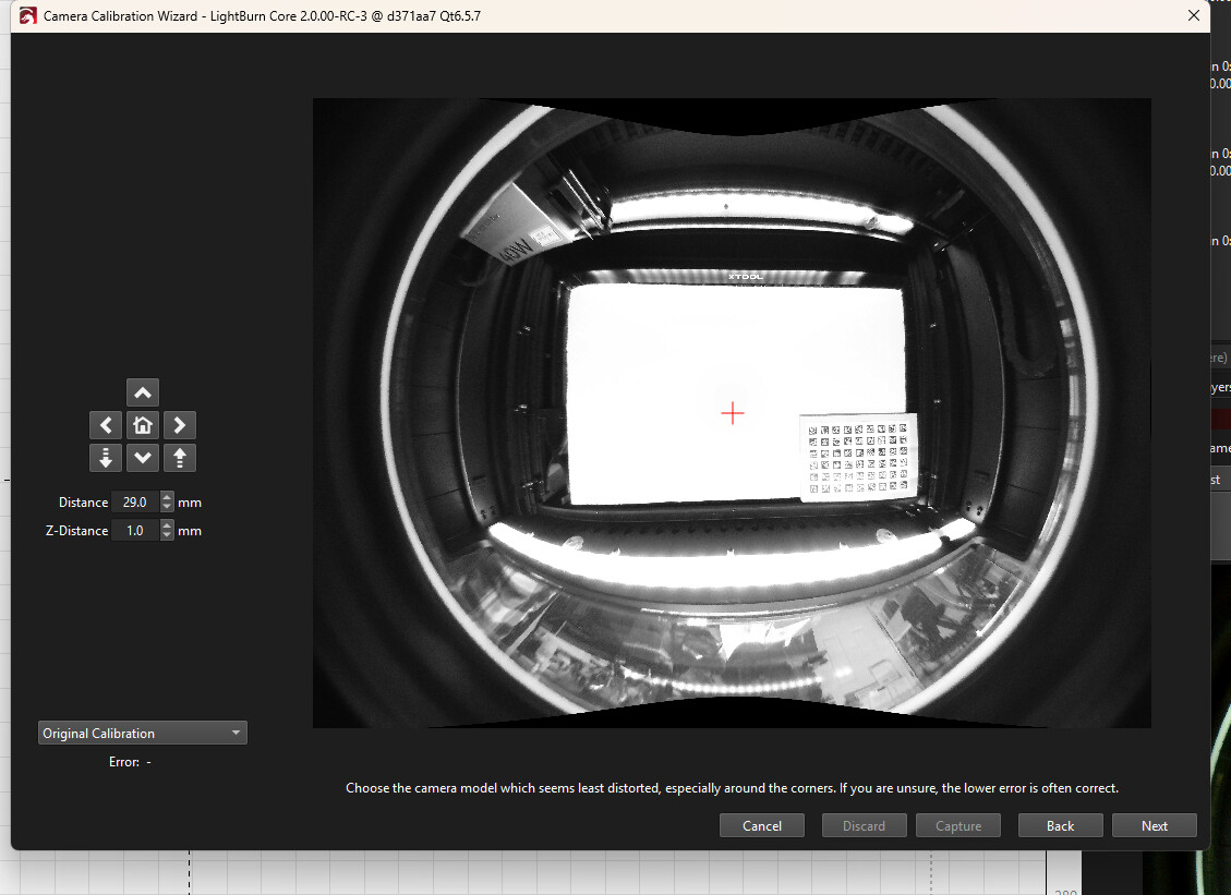

@Aaron.F @gilaraujo I tried the new experimental camera lens calibration tool. The beginning works great, took 38 samples, then hit next, and it shows building standard camera model", then the system crashes, non responsive. I let it run for 10 minutes, How long should it take?

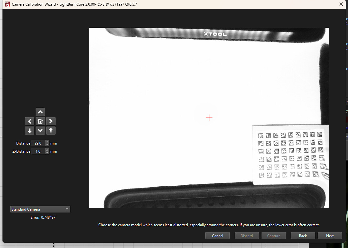

Ran the experimental calibration lens tool again, this time with 14 samples, Standard calibration was way off. When selecting the fisheye selection the screen was blank

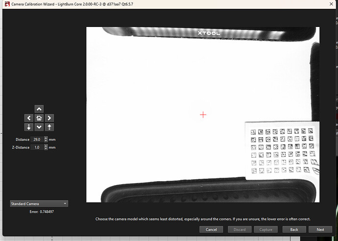

Ran the experimental calibration lens tool again, this time with 12 samples. Same result, see screen shots below:
