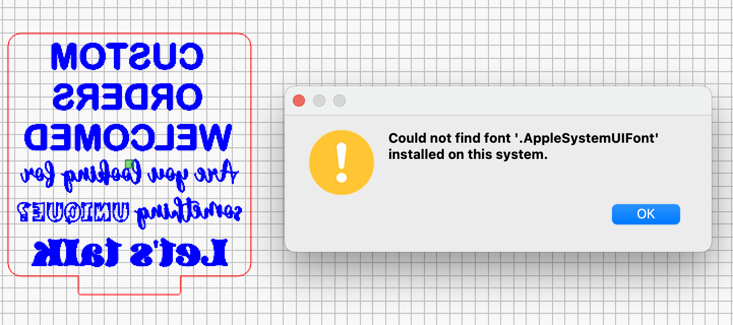

I have a file I created in RC2. I opened it in 1.7.06 and got the usual message about being from a newer version. I clicked on through that dialog and then received this message.
I click OK and am not able to edit the text. I can open the text editor dialog and make changes in there but no changes appear on the design.
If I open it in RC2 or RC3 text editing works fine.
This is a “no font found” in the computer error.
Are you opening the file on the same computer?
When the font is missing from the computer, LightBurn will hold the text as a shape, to preserve the designs.
However, it will be locked for editing.
It is on the same computer that it was created on. It is still seen as text otherwise it wouldn’t pull up the text editor, would it? Shapes wouldn’t allow the edit dialog. There are 4 different fonts in this file and none of them respond to edits in the editor.
Edit: ‘.AppleSystemUIFont’ is not a font that shows up in my font list, at least not by that name. I’ll include the file here if it helps.

This is interesting. Thank you for the LBRN let me take a look!
Was able to replicate the behaviour - reporting internally.
It has to do - as far as I can tell - with the font sub system.
Will report back when I know more

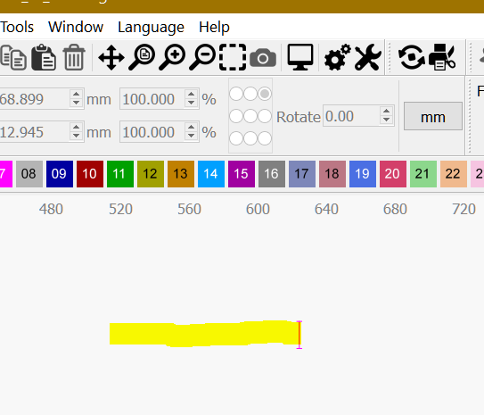

With the above file in WIN10 and 1.7.06 the shapes are Grouped. After Ungroup I can edit text normally.
Odd thing that happens after opening this file, I select Create Text tool write some random text and the text is invisible. After quitting the tool the text appears. If I retry everything is normal.
This happened 3 other times but only now I was able to find a way to replicate and so I tested.
In 1.7.06 I get no warnings about the fonts and after I ungroup the text is textimage
, but when I open the file in 2.0.00RC3:
