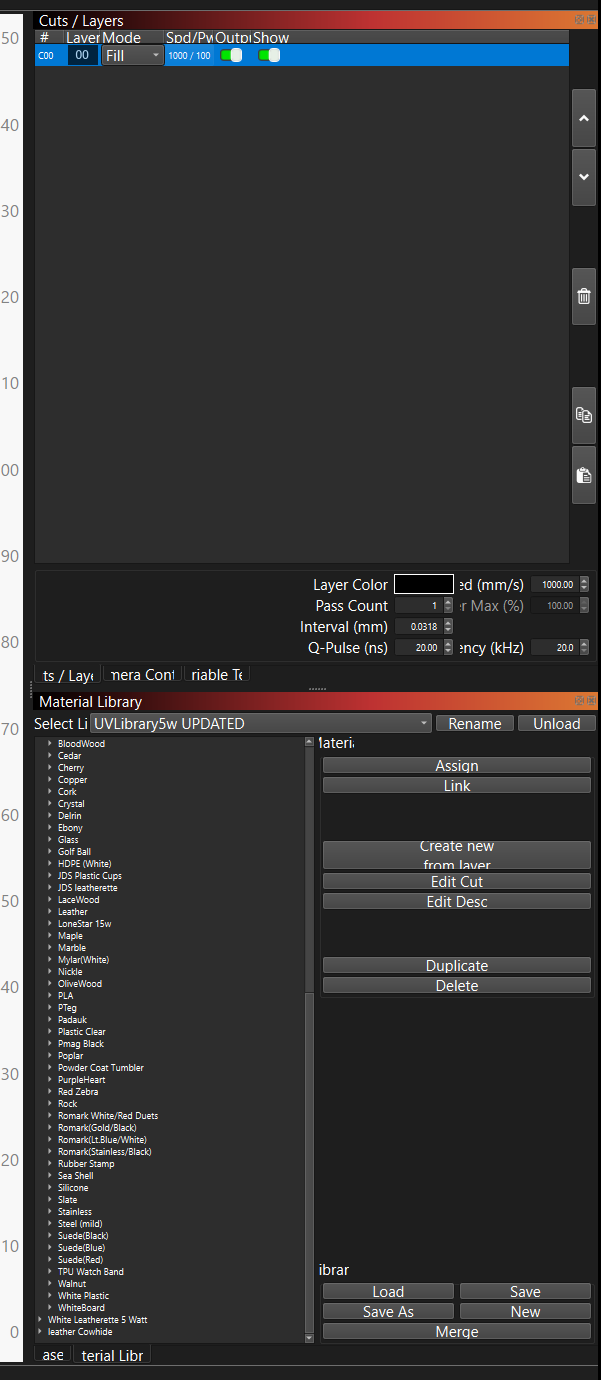

I’m finding issues related to screen scaling in Windows 11.
My laptop runs 2560x1600 @ 150% scaling by default (recommended setting) With this setting I’m seeing tabs overlapping the content making certain parts of the windows unusable. See the material library below where I cannot select values at the bottom of the list.
If I change to 125%, the overlap goes away but the text on the tabs becomes truncated.
I can’t use it at 100%. Too small for my eyes to tell you if all is well or not.
150% - Tabs overlap the content
125% - Text on the tabs is truncated but the tabs do not overlap.

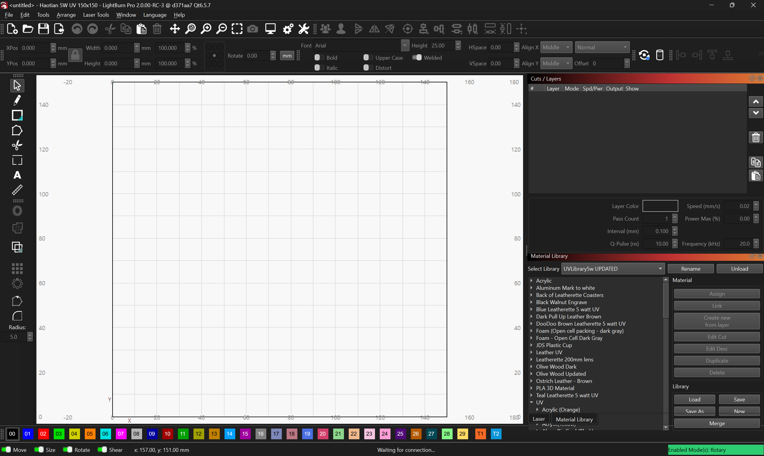

  2. Have you tried toggling the High DPI scaling options in the Display tab of the settings menu (shown below) and is there a combination that fixes some or all of the issues?
Yes, setting to 125% and then starting LB does resolve the truncated text and the window tabs overlapping.
I switched back to 150% (default) and turned off High DPI mode and sure enough everything looks sooooo much better now. All of the icons and windows don’t encroach on the workspace anymore.
This is the way.
High DPI Scaling OFF. Looks much better and I was able to scale the icons to a much more pleasing proportion.
High DPI Scaling On. Icons were HUGE initially and had to scale them almost all the way down to be usable.

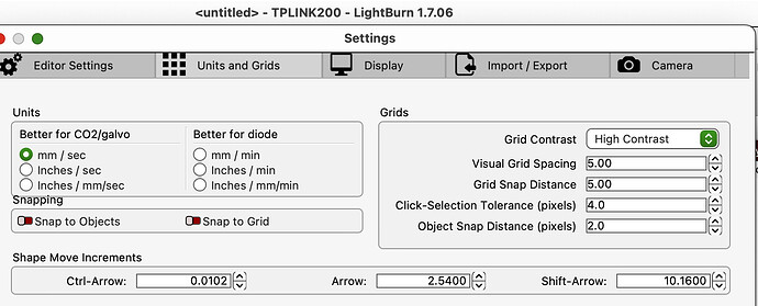

Mismatch of measurement units?
Unless I have missed something, setting mm/sec in device settings, is not reflected in Laser Tools> Material Test Generator
LightBurn Pro 2.0.00-RC-3 @ d371aa7 Qt6.5.7
MacBook Pro OS 15.3.1
See attached screen caps:

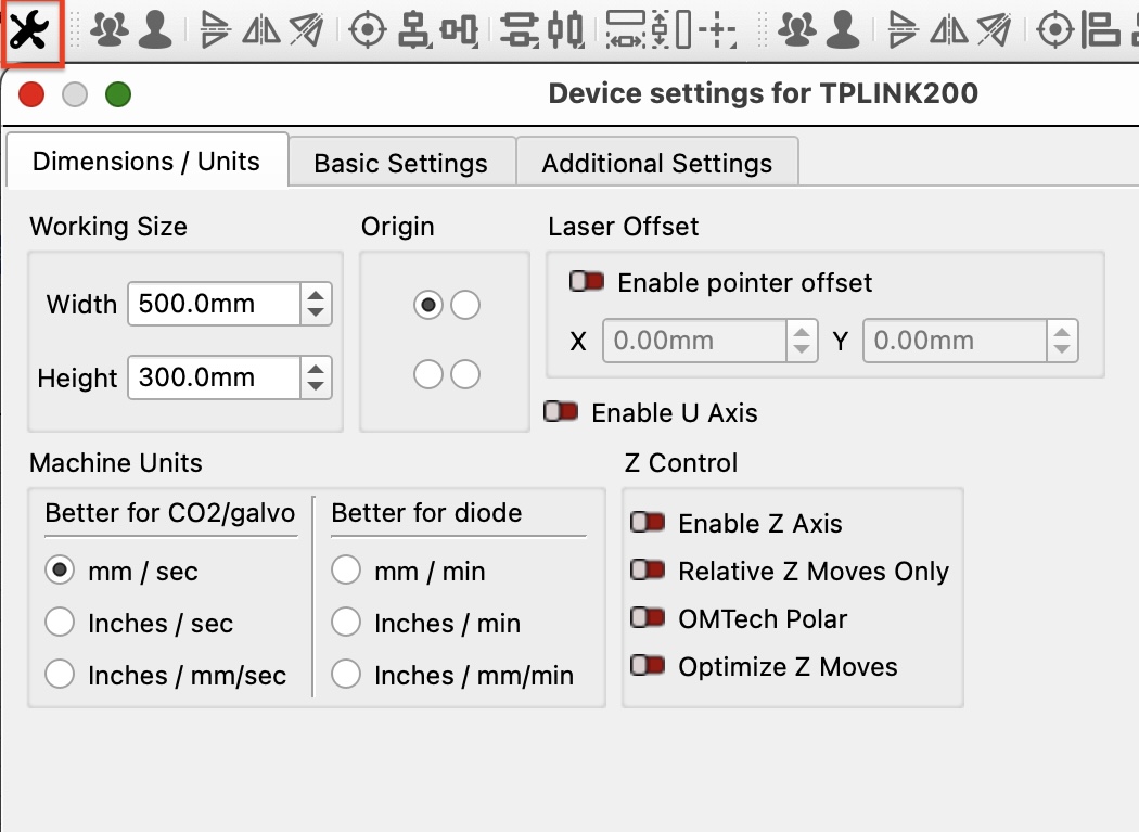

I tried it again, this time while in the Material Test Generator, I clicked on Edit Material Setting, which had the proper units mm/s. When I clicked out of that and back to Material Test Generator, the mm/m had changed to the proper mm/s. Thanks for giving me a reason to try something different, though I don’t think that is the intended method to get the measurements correct.
Do this, if willing… Change the ‘Machine Units’ on the ‘Device Settings’ page to something other than currently set and save. Check the Material Test again. Now go back and reset to your normal setting and see if that resolves.
I will have the devs check. I did see similar, but found that if I flip the current setting, then reset to my original config, things work as I’d expect. More digging to do. Thanks for reporting @patricr. :slight_smile:
Yes, and thanks for the follow on. This is not the way it should work, and thus… :slight_smile:
I wonder if changing the location of the “Machine Units” to a different location caused the momentary hiccup. I overwrote the app when I installed RC3 over RC2, maybe it had a read error over the previous setting?
