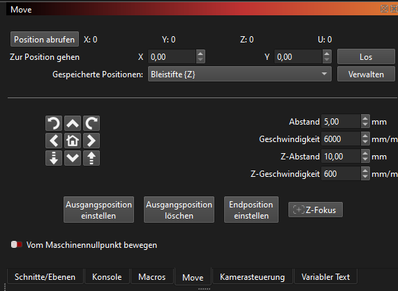

When will Sculpfun G9 be supported?
Leider funktioniert die Funktion Position abrufen nicht.
Unfortunately, the Get Position function does not work.
According to Sculpfun’s website it is already supported.
On what kind of laser?
xTool S1 :slight_smile:
Ok, we’re looking into it.
