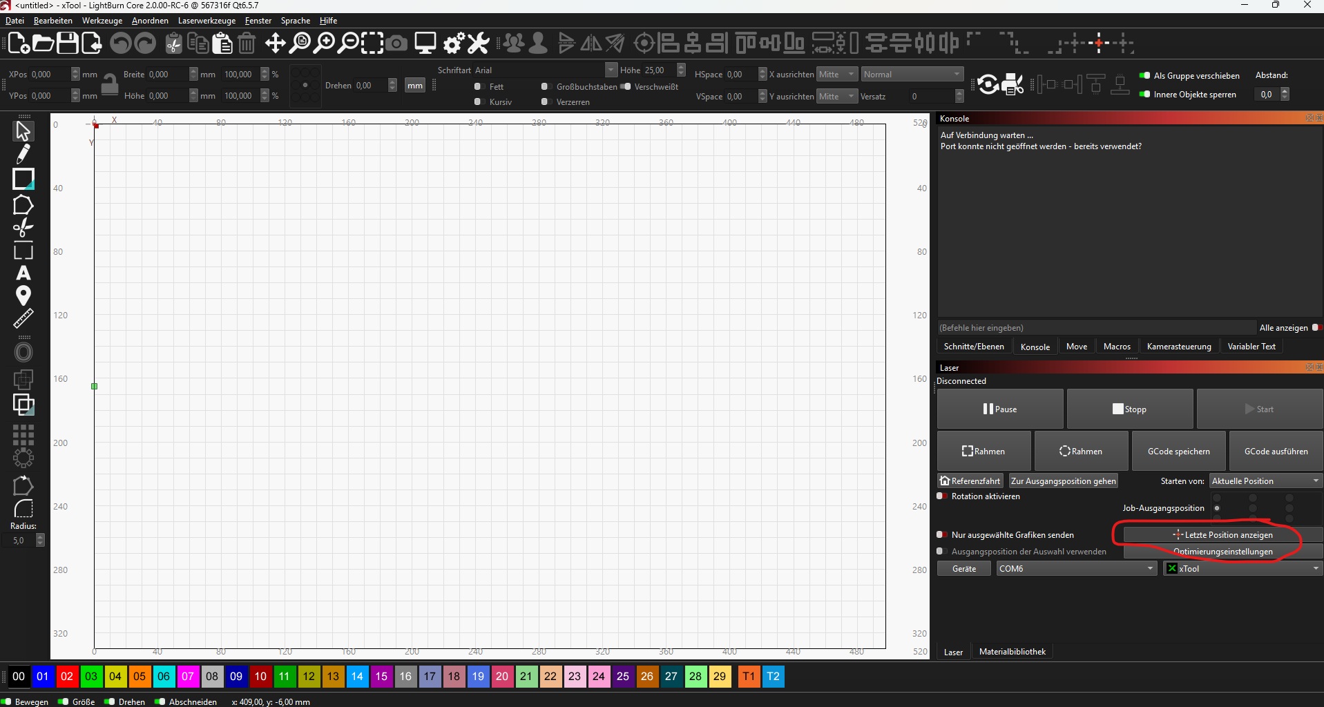

Unfortunately, in RC6 I still can’t display the last position of the laser. Even when it‘s activated nothing happen.
It must be a GRBL version thing, here at my place with my dsp version of LB, there have been no problems with it.

Since this laser is not using standard GRBL and does not respond to the ? command for reporting the MPos, I’m not sure, how easy / possible this is.
Or!: It’s already supported and you only need to set it up by following these instructions:
Yes that is me :slight_smile:
The ? command works, when i type it in the console Lightburn says in wich position the Laser is. Also the Tab where i query the position works. But not the cross.
To be sure: Are you using an Xtool S1?
Did you set it up following Joe’s instructions from the link I sent?
So, the command in the console and the “Get Position” button work.
What is “the cross?”

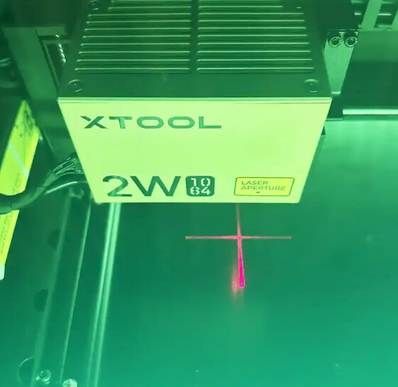

I believe the equivalent of a red dot, for the S1 - its a cross instead of a dot.

Ja genau, ich habe einen xTool S1. Der Laser ist wie angegeben eingerichtet worden.
Es geht nicht um das Kreuz des Lasers sondern das Kreuz in Lightburn, um die letzte Position des Lasern anzuzeigen. Die Fonktion klappt leider nicht.
Yes, exactly, I have an xTool S1. The laser was set up as described.
It’s not the laser’s cross that’s the issue, but the cross in Lightburn that indicates the last position of the laser. Unfortunately, that function doesn’t work.
any idea? :slight_smile:
Kann mir jemand helfen? Die Funktion fehlt sehr.
Aber es sollte ja funktionieren. Hast du im Bewegen-Fenster auf Position abrufen geklickt und da auch was zurück bekommen? Hast du mal neu installiert?
Wozu brauchst du das genau? Ich habe das noch nie gebraucht :slight_smile:
But it should work. Did you click on get position in the Move window and did you get anything back? Have you reinstalled?
What exactly do you need it for? I’ve never needed it :slight_smile:
For the Xtool S1 Camera Kit, and others.
