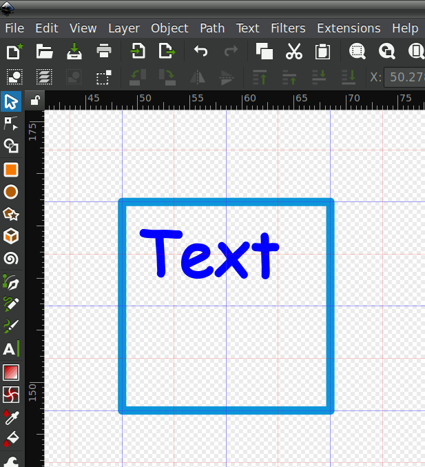

A problem with importing an Inkscape SVG with text that’s common to all the V 2.0 versions. I haven’t tried it with the 1.7 series.
The (simplest failing) Inkscape layout:
The result looks identical to that image in all the usual browsers, image editors, and image viewers. The problem occurs when it’s saved as either a standard SVG or an Inkscape SVG, so I think the hole isn’t in the Inkscape end of the boat.

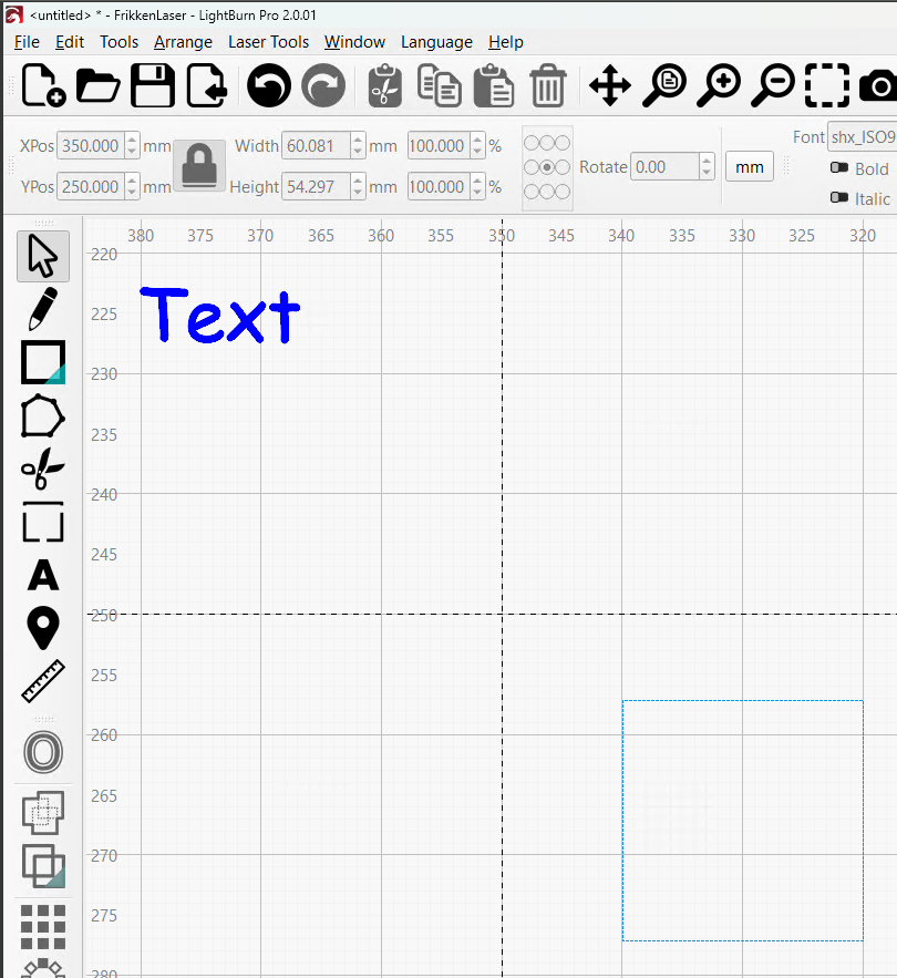

Importing either of those files into LightBurn, however, causes the text field to float off toward the upper left:
The file in standard SVG:
LightBurn 2.0.01 - Inkscape text layout
And Inkscape SVG:
LightBurn 2.0.01 - Inkscape text layout - Inkscape SVG
The LightBurn file after the import:
LightBurn 2.0.01 - SVG text offset.lbrn2 (14.4 KB)
This problem popped up in a set of programmatically generated SVGs, each sporting a label identifying which one of 16 Inkscape layers it was. The text field must be within the bounding box set by the rest of the image to let me snap it into position in a template, but it refuses to stay inside the box. The SVGs get stacked in LightBurn, but must go in a specific order that’s impossible (for me, anyhow) to get right without their labels.
I can verify I see the same on Windows 11. Will try on Mac later this afternoon.
Thank you, @ednisley and @CarlFisher. I have added this to another, existing report currently being investigated. :slight_smile:
Works correctly in 1.7.06
Just because I said I would, I verified this is also the case on Mac. Works in 1.7.08, not in 2.x

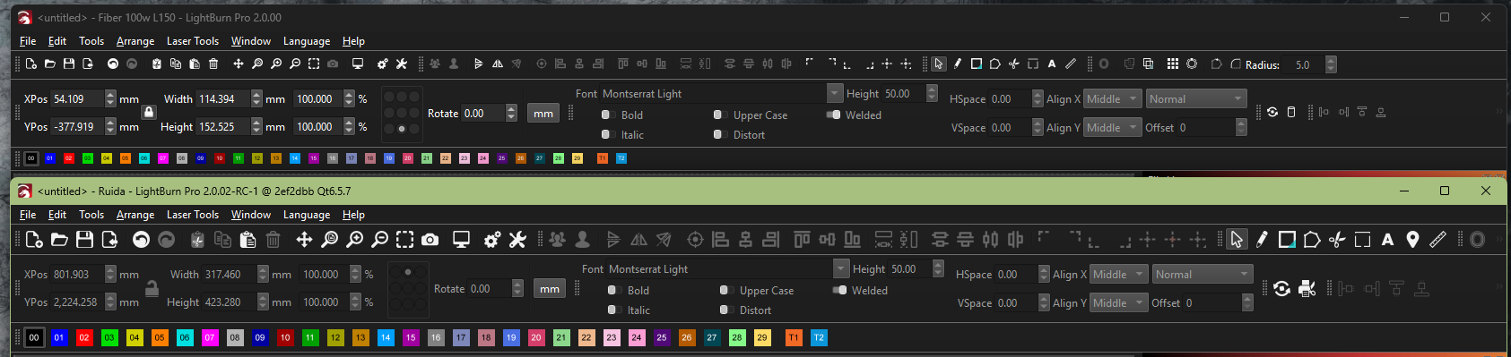

2.0 vs 2.0.0.2 RC (in front).
The iconsize is set to smallest(max left) on 2.0 and to -5 (max left) on 2.002 RC.
an error/bug? or is no longer possible to go with small icons like in 2.0 and previosu releases?
