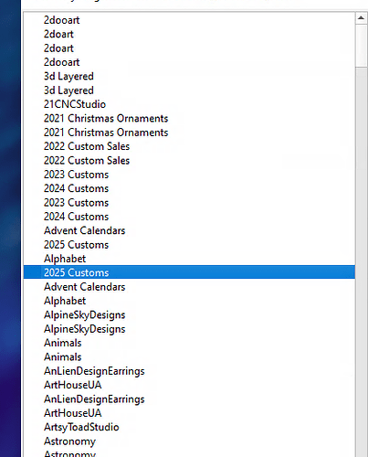

Something I just noticed is that my art lib’s are duplicated and sometimes even triplicated. Because I have multiple computers with instances of LB, I sometimes need to refresh the library list by Loading all of them again. under 1.07.08 this works well and adds the missing libraries. 2.0 seems to add them all again to the list.. Now my libraries live on a external drive, that drive is linux shared to my windows computer and mac. I fixed it by, editing the prefs.ini and removing the art libraries completely. Maybe we need to add a button to Unload ALL along with that Print option
Hello Colten
So I can report this correctly, would you be able to provide a step by step on the method you use to ā€œloading them all againā€ That leads to the libraries to become duplicated.
Want to be sure I follow your steps for replication
Use the Load button, Ctrl select first one, scroll down to bottom and Shift select the last one. Hit Load and wait. Since it’s on a network drive, it can take awhile to load all of them
