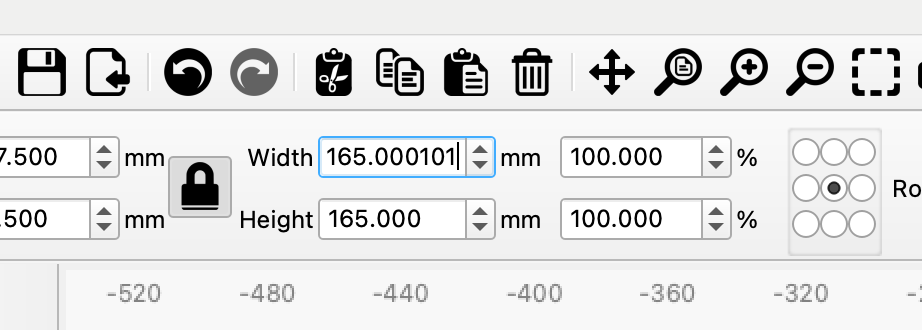

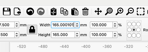

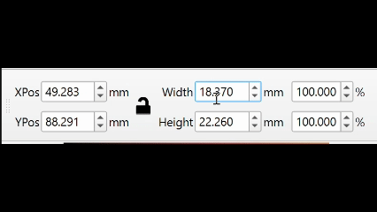

Would it be possible to place the input cursor at the start position when activating for entering new values?, preferably on all the fields that act in this way. Having to clear the old values ​​before entering new ones is not practical.
Everything is possible. But you can already do these things:
  • use the left and right arrow keys on the keyboard to move the cursor
  • place the cursor where you want with a single mouse click.
  • double click to select each number until the comma
  • triple click the entry box to select everything
    LB_Entry-box-select
Does that work for you on MacOS to achieve what you are asking for?

That’s not exactly what I was thinking, but a little faster than deleting the existing content manually before being able to type a new value.
My idea was more of a click in the data field and then typing new content, without detours.
But, the triple click function is a useful compromise :wink:
Thanks for the response
Yes, when the numbers are selected, you don’t need to press the delete button. Typing anything does that for you.

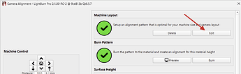

1 - Before 2.1 sometimes when opening a new window the camera output goes to the new window and after closing don´t return to the first window, Don´t know if this is already fixed or it´s random but it´s not happening now.
2 - Three time in a row I double-click an entry on the Cuts/Layers window and it took 10 seconds to open the Cut settings editor.

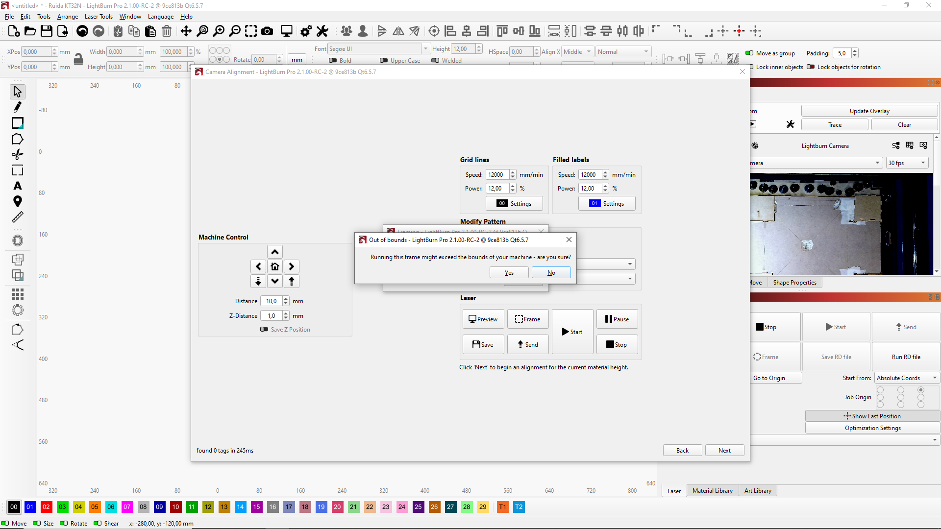

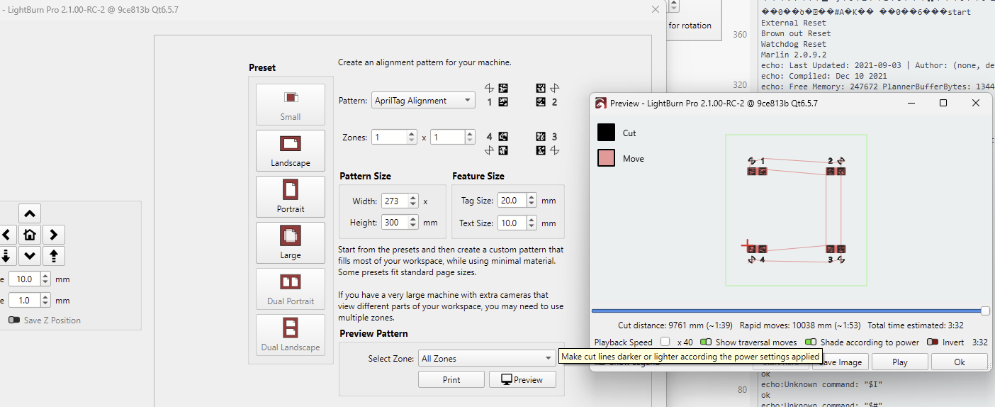

Forgot yesterday: 2.1 has set a very unusual Fast White scan speed of 59mm/m.
LightBurn hangs in a loop and can only be terminated with the kill command.
(in preview, see image)

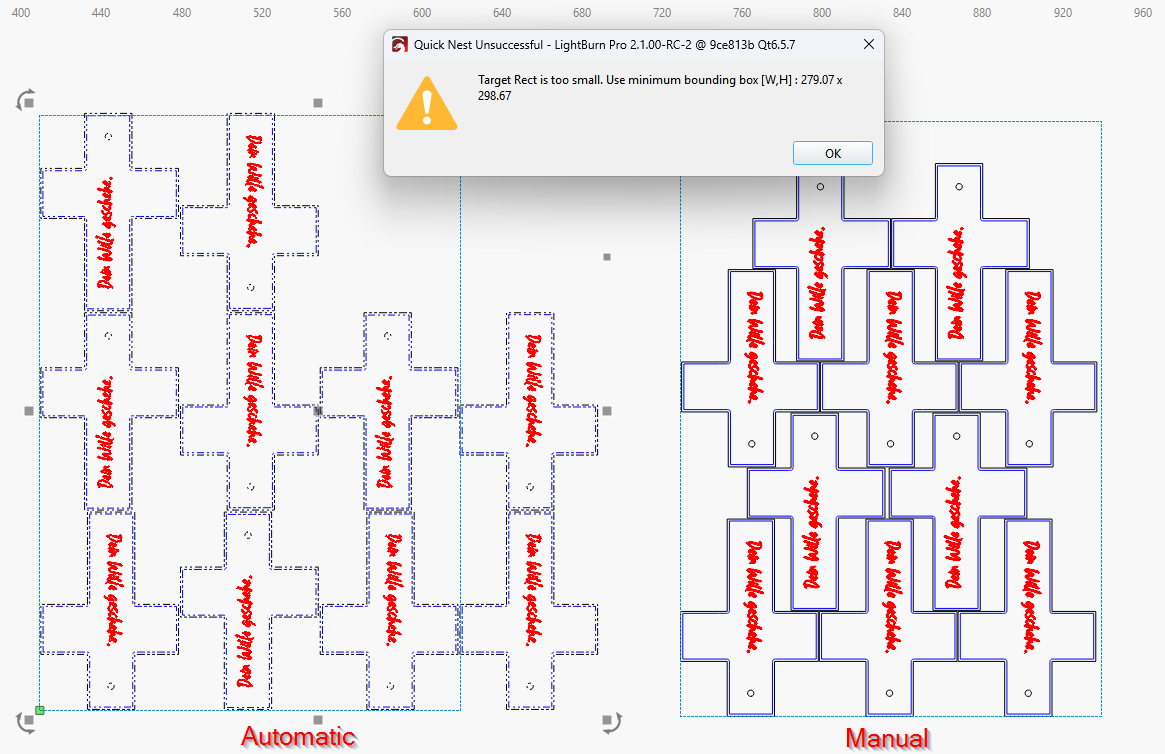

I just tested the quick nest feature with a (ok, difficult) task, and it failed (manual positioning on the right):
I know it’s not the easiest algorithm, but I still wanted to show this kind of case.

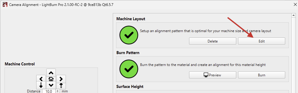

Hi Bernd,
I was unable to reproduce exactly what you describe with “hangs in a loop”.
Can you make it happen repeatedly, and what are the exact steps you took?
Did you try changing the Machine Layout here?
You might need to decrease the “Pattern Size” here to make it fit on the workarea.
It still should not “hang in a loop”. Please share more details on what you mean by this.

I agree that the crosses should fit in this bounding box! But the algorithm doesn’t seem to be testing all possible placement variations yet.
We are still working on refining Quick Nest and making it smarter.
I’m afraid that might be the best it can do at the moment. But I’m looking forward to reviewing your file and forwarding it to @girish
That’s the biggest understatement ever :slight_smile:
Nesting is surprisingly complex, and some of the industrial solutions are priced in the five-digit range.
2026-02NestingChallenge.lbrn2 (102.0 KB)
Here it is.
Yep, I know, nesting is a really nice computational problem :slight_smile: I was surprised that it’s really that fast right now.
