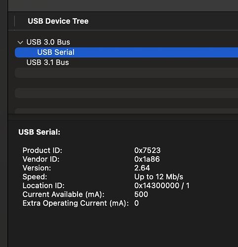

Ok I know this has been asked a ton of times but I am still having an issue. I have a Mac Air with M1 and able to connect to Xtool. I recently purchased a Mac Pro with Intel chip. I cannot connect to the Mac Pro. Steps I have followed based on all the research I have found:
Connect to Xtool through XCS (Cannot connect with USB but was able to with WiFi)
Install config file into Lightburn.
Installed CH34xVCP Driver
Verified in system report Serial port is showing up when plugged in
No other program is consuming the port. I do have a power cord plugged into one USB-C and Xtool in the other one.
Multiple restarts and LB will not detect device.
Attempted to setup manually using GRBL. Choose setup and it will not show in the available devices. (screenshot is all that is ever in the list).
The weirdest thing is it showed up yesterday and worked all day. Today I went to plug in and it will not detect anymore. I am at a loss.
Screenshot 2023-10-03 at 2.18.48 PM

It’s unusual for the device to show up in System Report but not be made available as a serial device in LightBurn.
Can you check to see if a serial port is created in Terminal?
ls -l /dev/*usb*
If a port is not being created then there’s a gap between device detection and serial port creation. This would normally be an issue with the driver. It may be that you’re having a driver conflict but let’s address one issue at a time.

This explains why LightBurn doesn’t see the serial device.
I’d suggest going through this page and using it to help identify if you have a driver conflict and how to potentially address:
