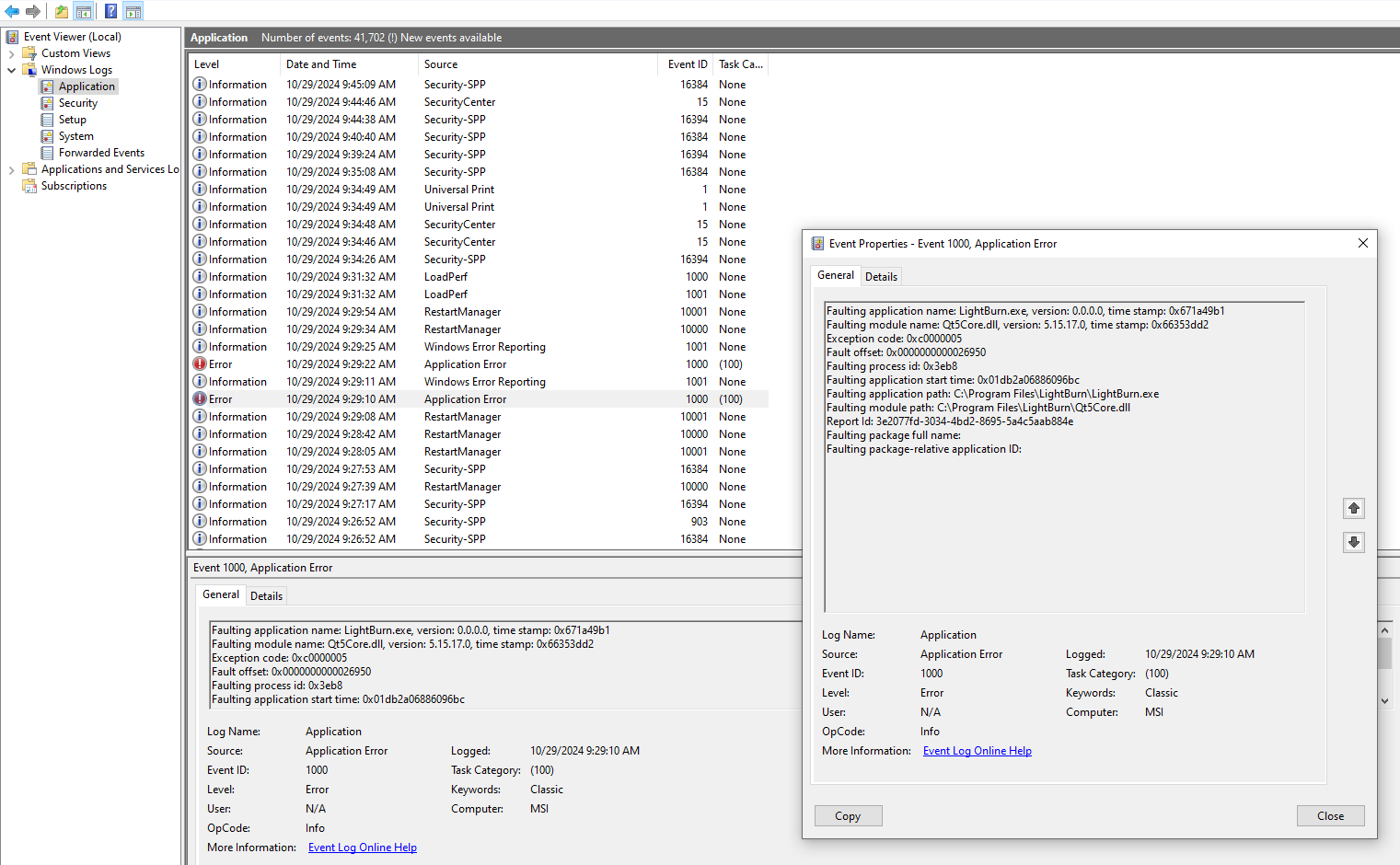

If it doesn’t work - could you please go to the Start Menu and type
Event Viewer
On the left side of Event viewer, click Windows Logs, then Applications
Do you see any Big Red error related to Lightburn.exe? If so, could you share some screenshots of the “general tab” below the list that describes the error?
Easier to maximize the full Event viewer so all is readable.

I am still having this problem. Here are the windows event viewer logs. Hopefully this helps!
Does this help?

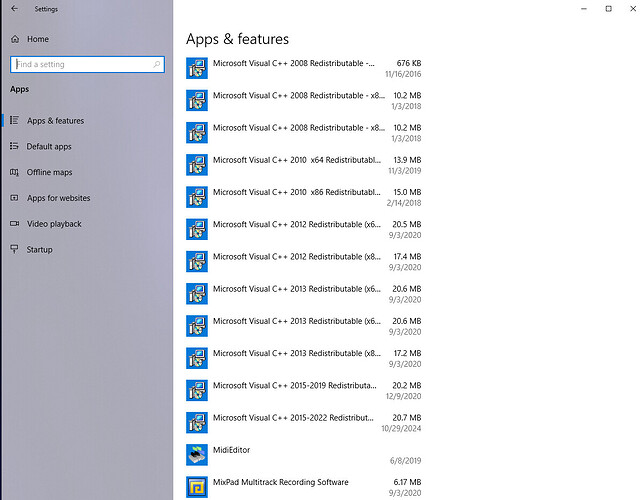

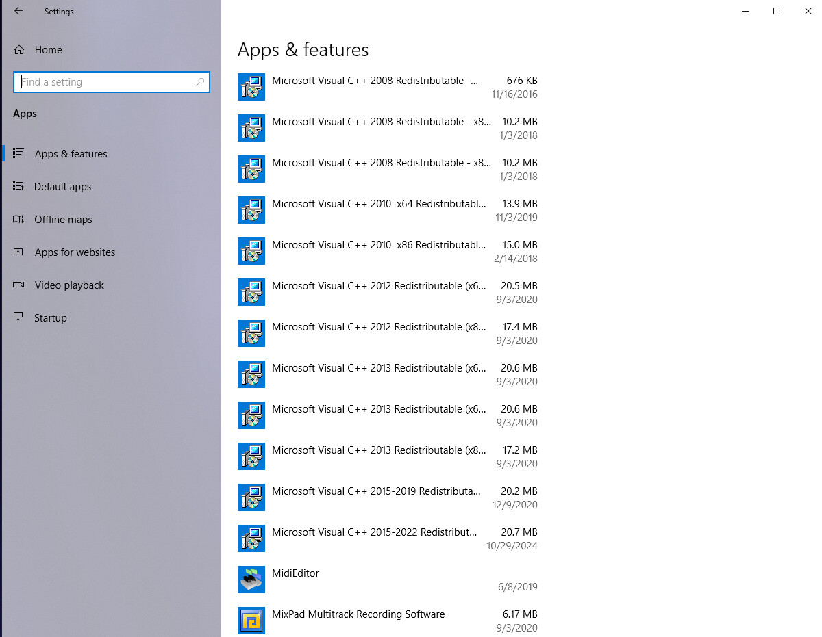

Try removing the previous Visual Studio redistributables from your computer, then installing the posted version. There have been a couple of users who’ve had to do that to make it work.
Thanks, I’ll try that soon!
I am having the same issue and removing all previous VS Distributables and reinstalling 1.7.01 has not fixed the issue. v1.6.03 works fine.

Same experience as smellyboy; 1.7.00 and 1.7.01 will not launch for me. I tried uninstalling all VS redists and reinstalling them, latest version. Also rebooted etc, simply can’t get LB 1.7.00/01 to launch :frowning: reverted back to 1.6.03 now.

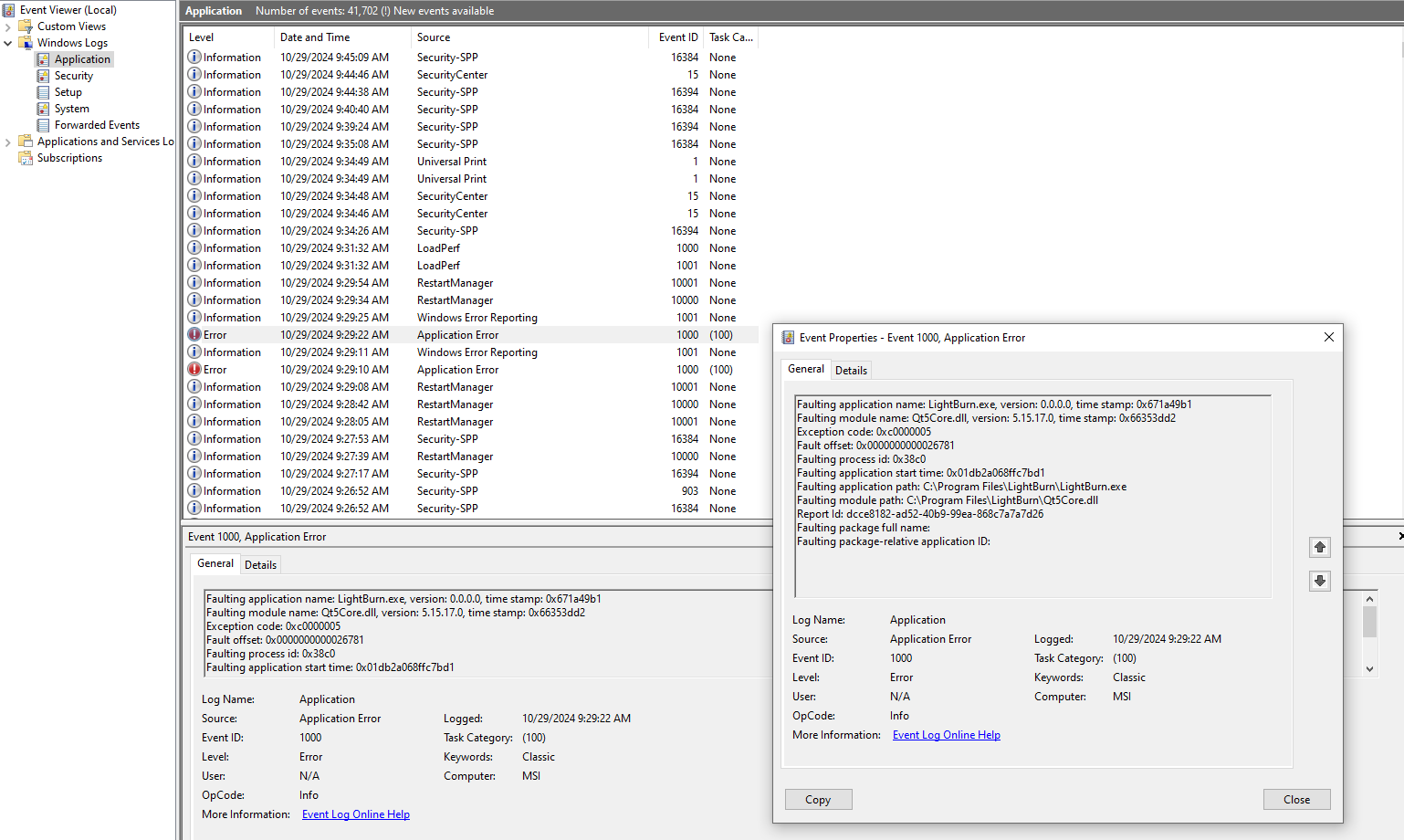

My lightburn also wont open after update. I looked in the event viewer and it also has a red error on lightburn 2 times. What should I do?
We have seen situations where updating C++ will not work
Suggestion
c:\Program Files\Lightburn
Delete all content of the installer folder above
Then install it again; it “should” clear everything and prevent the error.
that was the solution. Deleted the entire lightburn folder. I installed and started no problem
