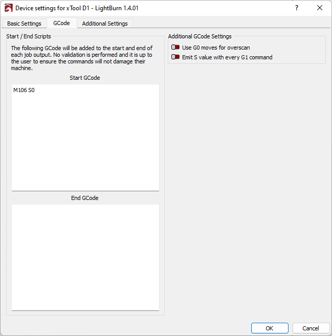

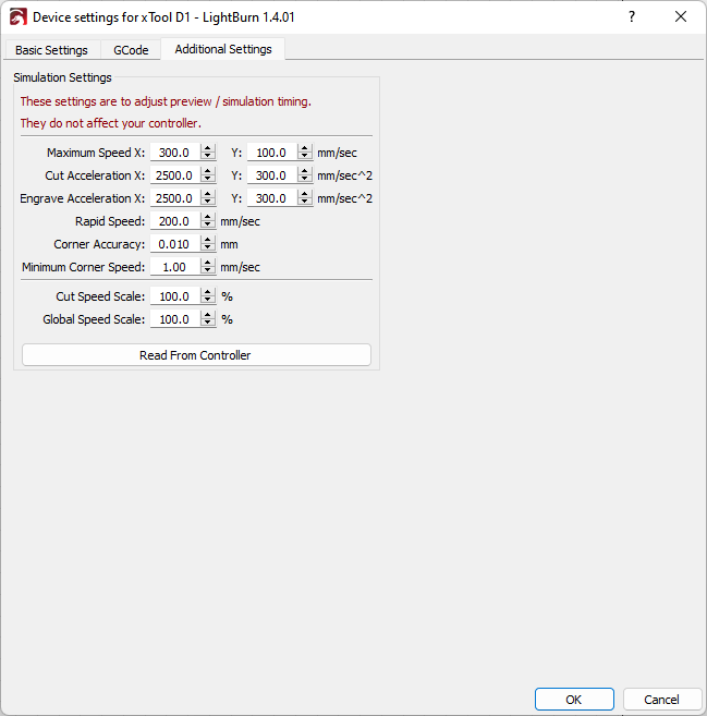

Post a screenshot of your settings window for the device if you don’t mind.

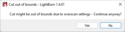

getting this now, its is not jogging in the wrong direction any longer because I toggled off the “Auto Home on Start-up” switch.

that fix was provided by Lightburn support after sending in data file. yes one moment please.
