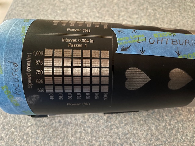

Lines in my images on a powder coated tumblr

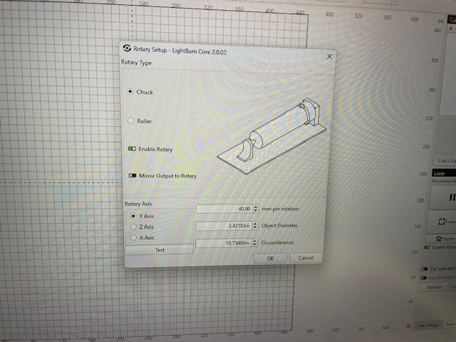

Can you post a screenshot of your rotary settings window?

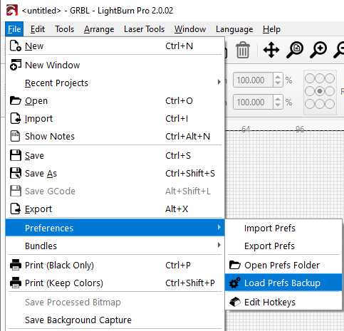

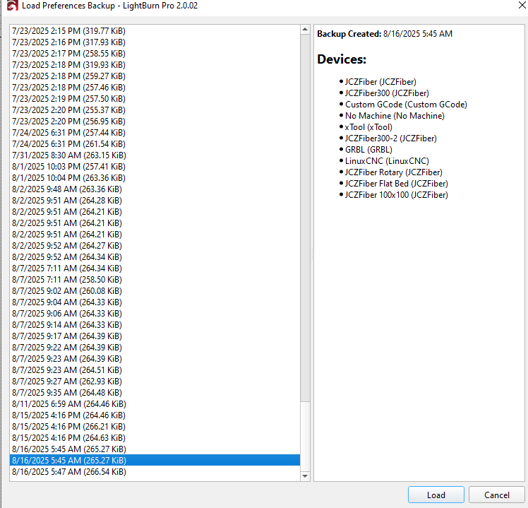

Have you tried loading an older preferences file?

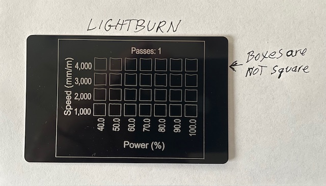

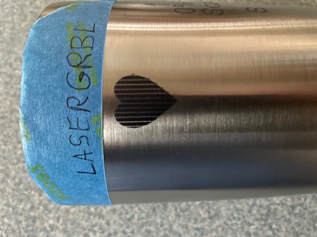

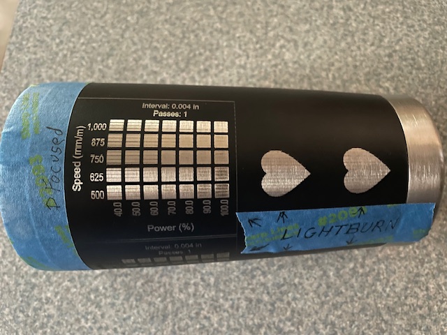

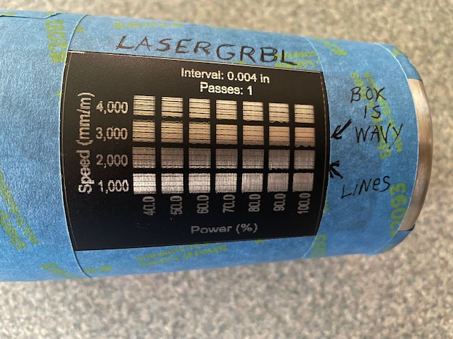

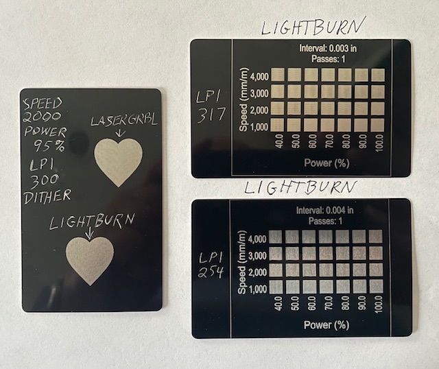

I ran some more test today with laserGRBL and with lightburn. I’m still getting lines with both programs on the rotary chuck. With out the chuck the lines are almost comletely gone unless you have a magnifying glass, But the edges of the materials test grid boxes have waves in them. Here are some more photos.
More Photos
Here are the settings for the Rotary.

What do you mean by older preferences files?
I posted some materials test today

When you hit test do you get 1 full rotation of the chuck?
When you change to flat, are you sure you are turning off the rotary?

Your main issue seems to be only really be showing at the rotary (the skipped lines), which appear to be regular despite changing line interval or scan angle - is the interval of the problem the same as gear gogs/belt teeth at the rotary?
The other pic (IMG_1669) on the flat with the ‘boxes not square’ and where you labelled the ‘Box is wavy’, is possible a secondary or downstream issue since it also seems to appear at the rotary (IMG_1664), so you may want to check the laser module - mount/head assembly/optics, for any looseness that might contribute to a front-back wobble.
It might be useful if you ran this backlash test program (on the flat):
Backlash.lbrn2 (73.5 KB)
Post the results here please.
Check for the hallmarks of a sloppy Y-axis.

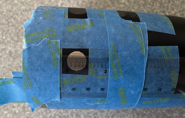

Try running the Test on the Chuck. The Chuck should make one complete rotation, then reverse direction and end up where it started. If this doesn’t come out right then change your mm/rotation till it does. I take a magic marker and make a little mark on top of the rotating part of the chuck so i know where it started.
Yes when I push test on the rotary set up page I get 1 full rotation 390*. I have also created a 4 inch line in lightburn and had the rotary engrave it. The rotary produced a perfect 4 inch line
