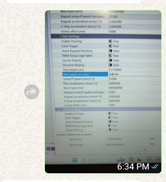

Hi I have the same laser, had the same type of issue from day one, no one could help, finally support at gweike cloud understood and got me to change the y max speed from 1000 to 100 this solved my issues, you can still engrave at high speeds on the x axis when burning images etc, but my machine does not seem to like anything faster than 100 on the y when framing marking shapes etc it gets all out of shape, I can only think it’s the weight of the gantry with the laser tube on it, even though there are two stepper motors on the y, that was the only thing that worked for me in the end, I guess it’s just a gweike cloud pro 55w thing. here is a screen shot from gweike
I don’t think you understand the scope of what they changed. You told it not to exceed 100mm/s in the Y direction.
This is the maximum speed limit on the Y axes under any circumstances. Any component of movement using the Y axes will be limited to 100mm/s.
The values interact with the acceleration values. Here is a graph from one of the on-line calculators showing it will take 60mm to reach 600mm/s. Anywhere there are corners you aren’t going to make speed. Especially with the vertical parts as that part of movement is restricted to 100mm/s.

If maximum Y speed from the factory, was 1000mm/s, that’s pretty deluded in my estimation…

I think the problem is acceleration, not maximum speed. They kind of go hand in hand… the acceleration is based on the amount of mass it’s moving… More mass more acceleration… however the limit is the motors power ability.
Lower acceleration takes more time/distance to achieve speed, but requires less powerful motors.

Jack the original max acceleration for the Y was 3000 mm/sec they are the only 2 settings I changed
I remembered I slowed it to 1000
