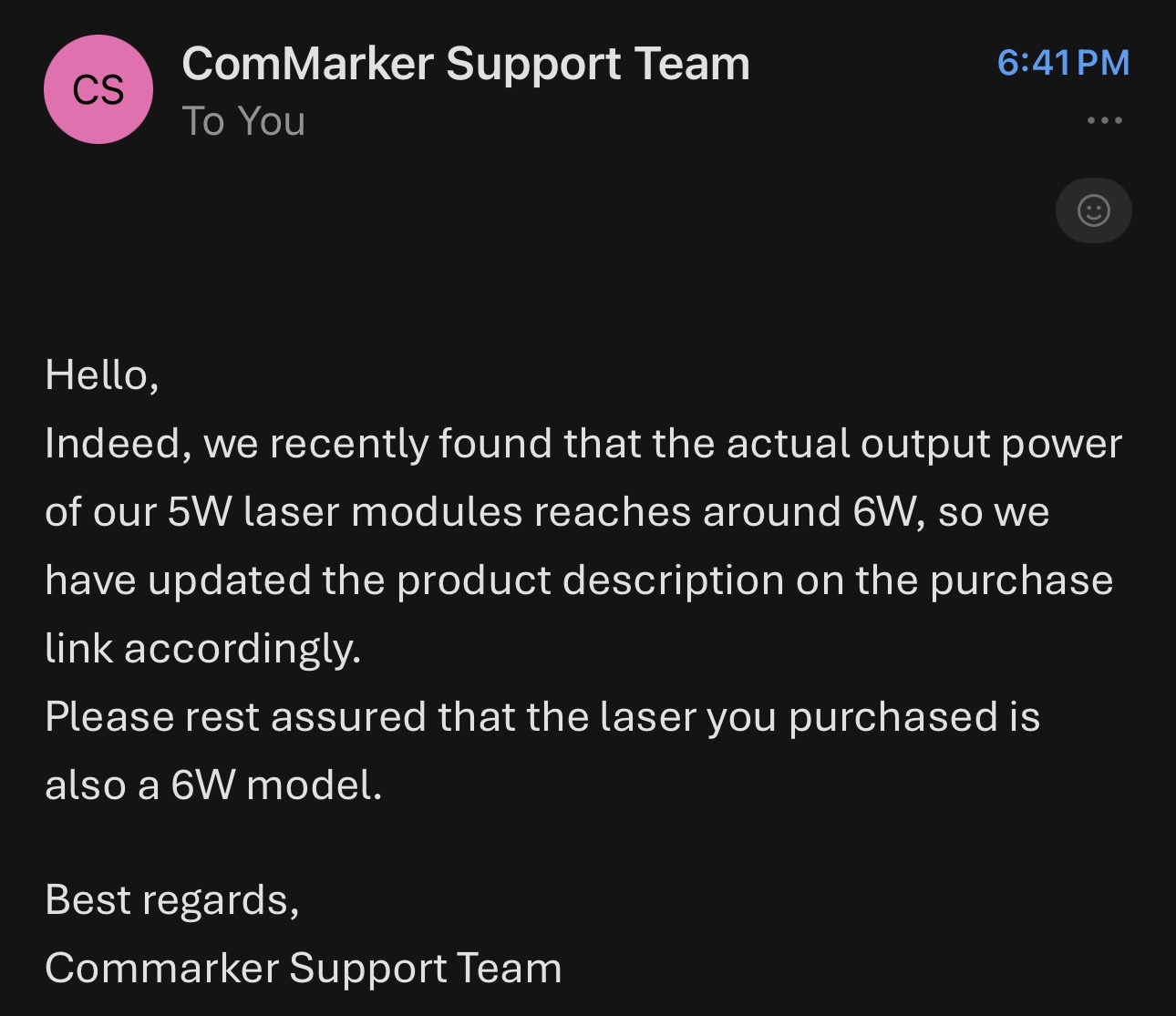

I wonder if it’s related to a change in hardware. Now they are advertising 6 and 12 on the site. I’m emailing them to know more about that as I just got this thing, ridiculous.
False alarm, they are measuring 6 watts now so the specs have updated.

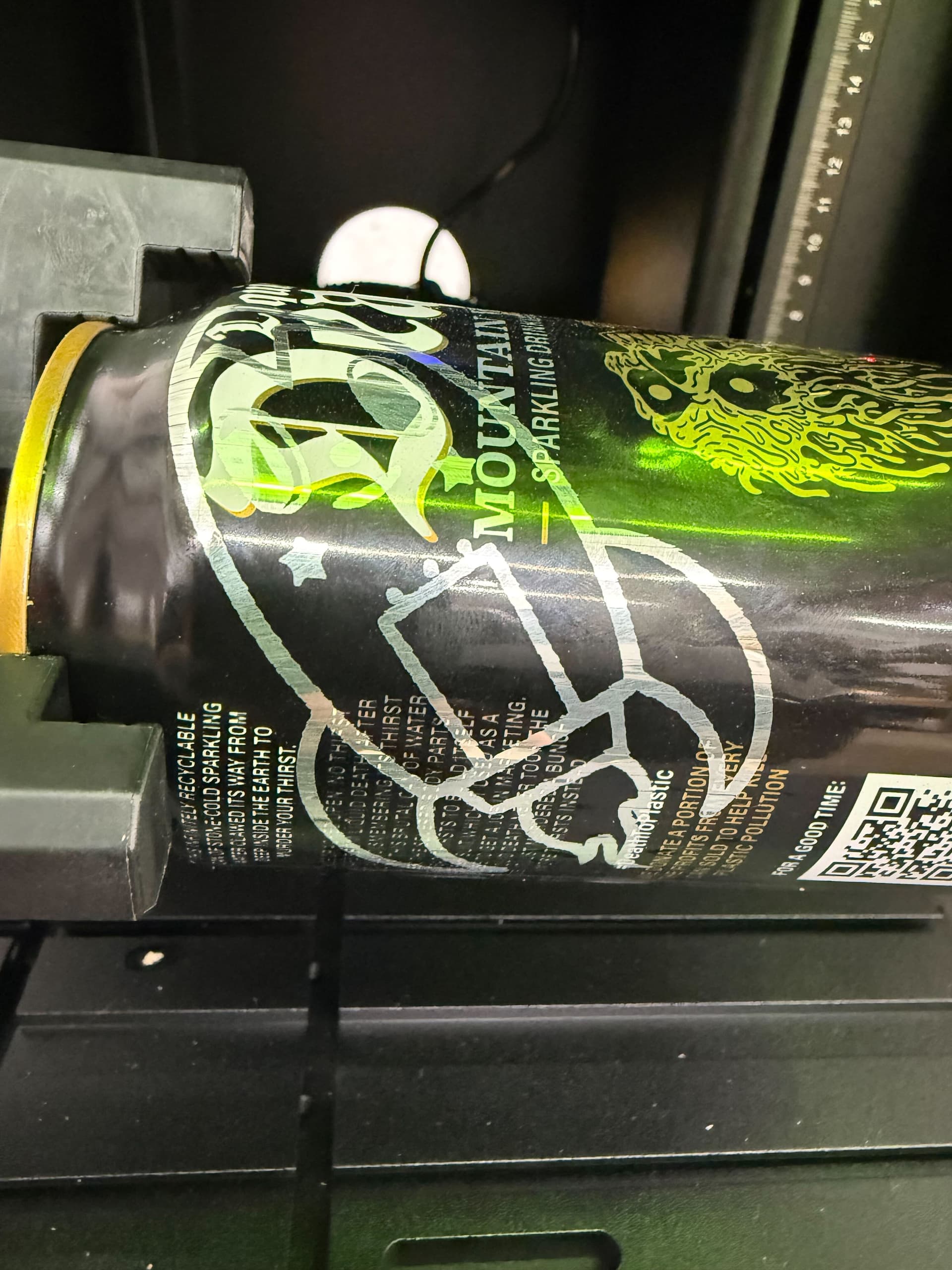

I just tried with thouse settings and got random results. Inconsistent. It is better. It starts engraving ok, but sometimes in the middle of the work start engraving gibberish and random spinning. After that, i try the same project , the same material, it engrave whole but with inconsisten lines. I mean distance between mark lines somewhere are spectacular, somewhere are disaster. Can someone check also and see? Thanks a lot everyone!

We got another Omni X, and I ran some rotary tests.
The stepper motor barely has any torque and briefly turns off in between the slices.
It worked well with a light Sharpie if it’s mounted perfectly axially in the chuck.
But not with a heavier glass! It showed the same, seemingly random, gibberish movements.
With this heavy, unbalanced hex wrench, you can see the issue:

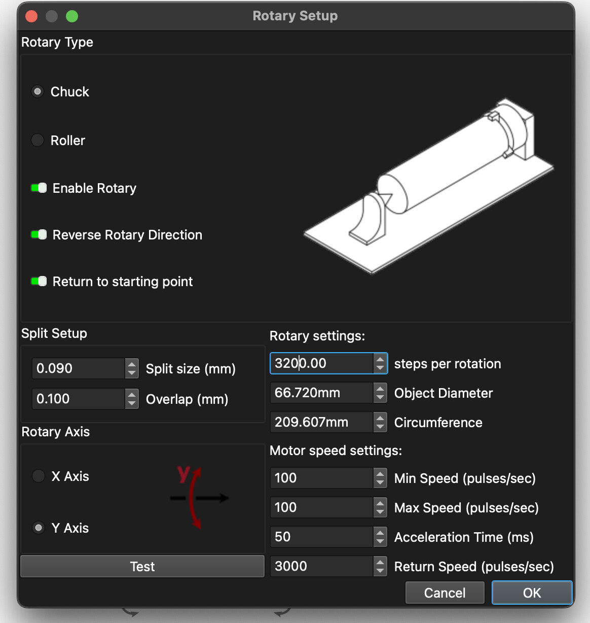

Just jumping in to mention I have the exact same problem as OP. I have the Omni X 5w along with their rotary. Works (mostly) fine using the Commarker Studio software. I say mostly because no matter what I do, I end up with consistent tiny “skipped” lines when engraving tumblers. So I downloaded Lightburn and followed ComMarkers guidance on adding both the Omni X and the rotary tool (although their manual insists steps should be 12800, when in fact to only get one rotation in Test steps should actually equal 3200). Flat engraving works fine. Rotary tool seems to get the results as OP - I probably engraved “Hello” 15 times and got 15 different results. The only difference in our situations is that I have not contacted ComMarker about potentially needing a new motherboard. Seeing as I’ve had the tool 10 days or so, I hope that’s not needed. Thanks and let me know what info you need from me if I can be any help solving this

So… I successfully changed motherboard and now… rotary WORKS! For now i have 0 slippage and all is working ok on 3200 steps per rotation. Big thanks for Samuel Sanchez who sent me video from commmarker how to change mb. Also thank you all for helping me to resolve this. Muito obrigado!
