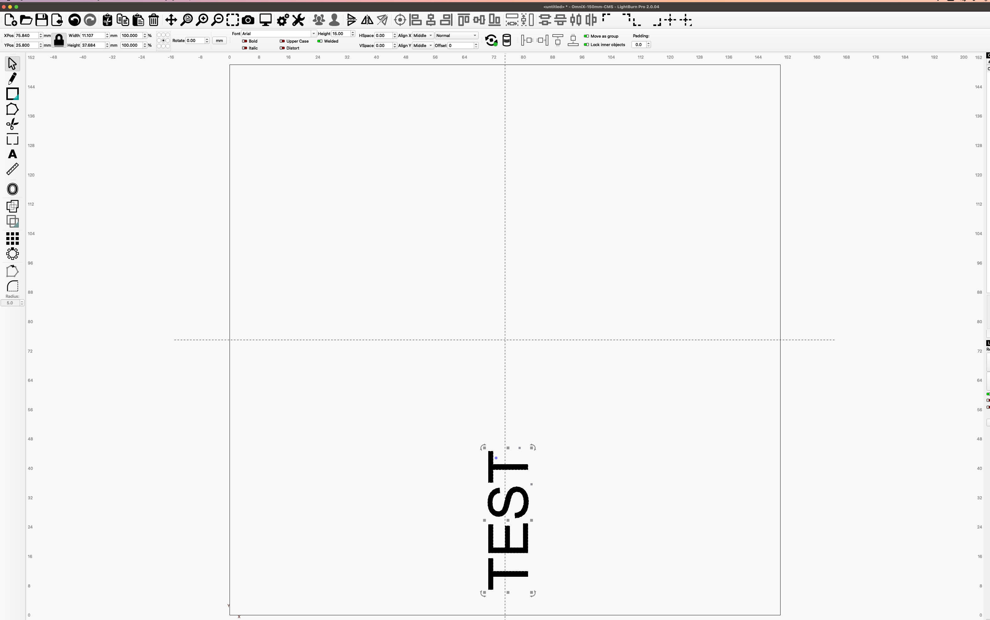

Precisely, I have Commarker OmniX, with commarker r5 rotary. Laser works well, i managed to calibrate everything, because there is no .cor file from commarker. Commarker studio is ridiculous piece of software and I bought lightburn pro. Rotary works perfectly in Commarker studio, but in Lightburn I can not manage to use it. I checked, double checked an triple checked all parameters from the manual and from the internet, and all seems to be ok. Precisely, when i press Test buttom, rotary works, but when i start the job it engrave nonsense and moving strangely. I have tried every possible orientation, X and Y axis, everything. In the start i put steps per rotation to 12800, split size 0.1 . Nothing works… I will try to upload link with a short video clip so you can see the behavior and what is happening.

P.S. I tried to engrave just a word TEST, nothing more.

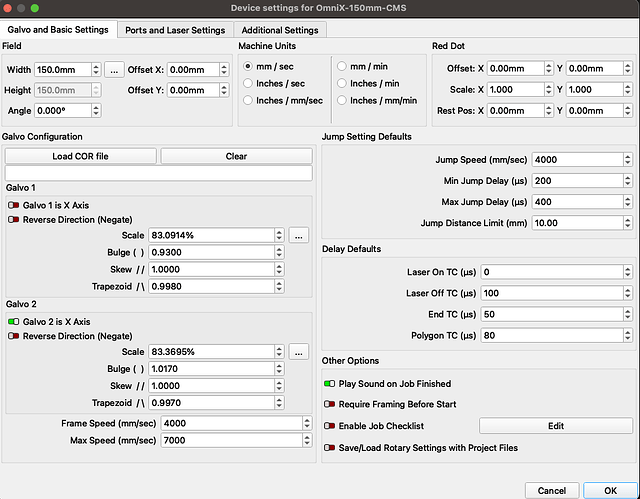

That’s good. If your engraving is not mirrored, the .cor file can’t be the problem here. This lens correction file corrects the scale, trapezoid, bulge and skew values of a particular lens.
A screenshot of the first two tabs of “Laser Tools > Device Settings” could provide insights.

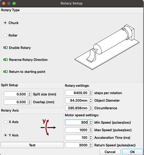

If the results are inconsistent, your rotary might be skipping steps. → Try decreasing the min- and Max speed in the Rotary Setup.
Can you share a screenshot showing your design and the Rotary Settings? Possibly with another video of the outcome, if it is different to the first one.

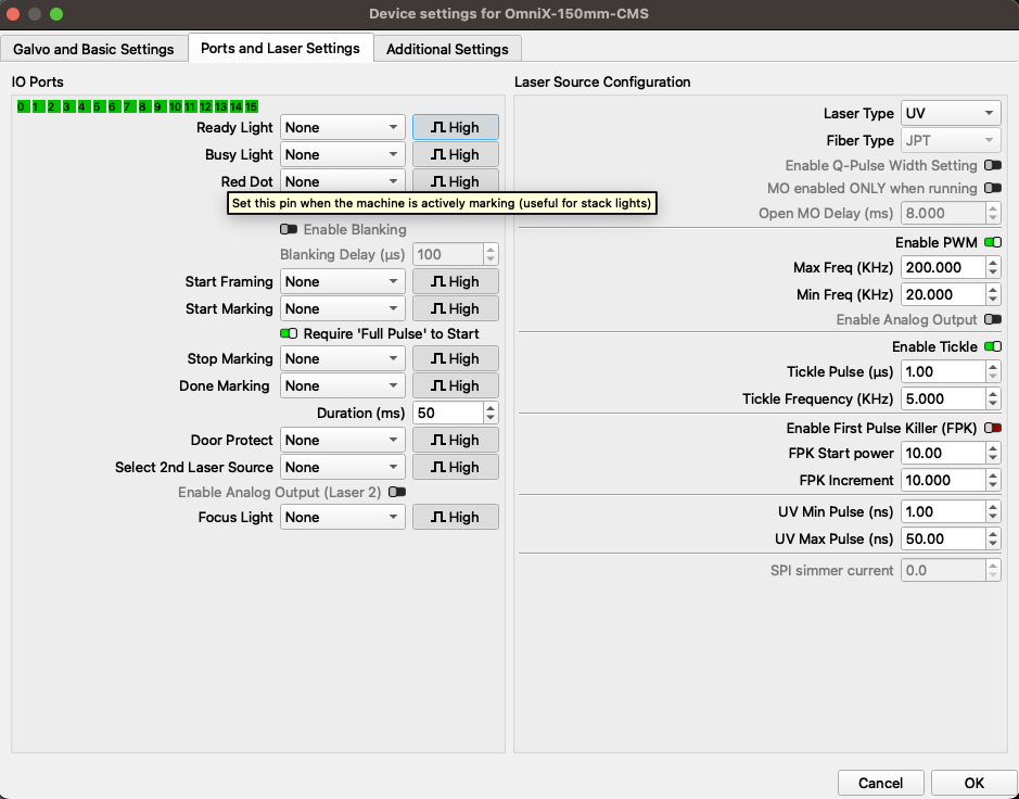

The device settings mostly match what ComMarker shows in the manual. Apparently, you changed the default values for bulge, skew… Leave them if you are happy, and don’t worry about the .cor file for now. This can’t be the issue here.
One part that’s missing in your Port settings is the “Door Protect”. Set this to 1 as in the manual. (I’m not sure, how that’s supposed to make a difference, and whether you can still close the door when the rotary is in place)

The Fiber Source is different! They show “RAYCUS” in the manual.
Here are video and screenshots of latest try. Just to notify that I also tried with Reverse rotary swithced off, and the result is the same, rotary uncontrolably spinning and engraving jibberish. Is it possible that something is broken between Lightburn and OmniX or I am crazy? I am also sending a link with the video of test button. Ignore that it is missaligned precisely from the start, but with test button it spins 360 degrees.

yes i know it was raycus and the beheviar was the same. When i choose UV that field is greyd out ,

It’s hard to tell what the laser is engraving in the video. Increasing the split size to 5mm will likely make it clearer.
What was the result when you enabled “Reverse Rotary Direction”?

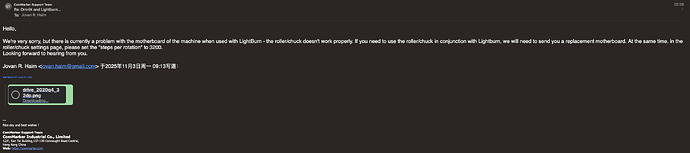

Just quick update for potential owners of Omni X. I got a response from ComMarker. and i will put screenshot here. The biggest question for me is should i change it or is it something that guys from Lightburn development team can resolve without me pulling cables and risk ruining something :slight_smile:
Sorry for the delayed response,
I have tried and I confirm that rotary on the OMNI X does NOT work with lightburn and have the same erratic beheaviour as reported earlier in this post.
(it works with their software, and it works with lightburn on the OMNI 1)

We’ve sent a follow up email to Commarker for some more info, and are working to create a Bundle for the Omni X that will ease the setup process.
So to wait Lightburn update or to change motherboard when it arrives? :slight_smile:
