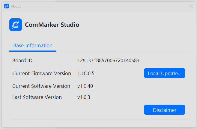

  • Omni XE firmware 1.18.0.5, ComMarker Studio v1.0.40 — ComMarker have confirmed in writing that my machine already has the latest mainboard

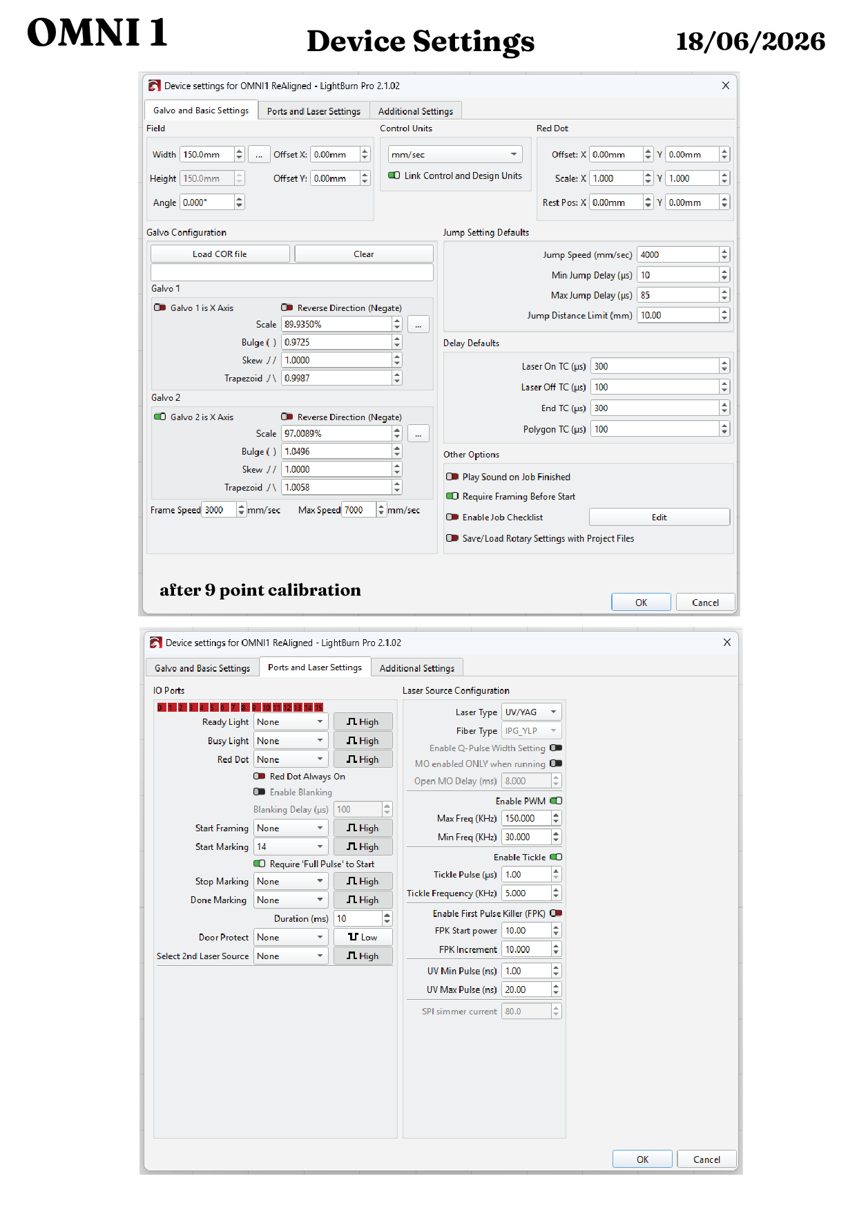

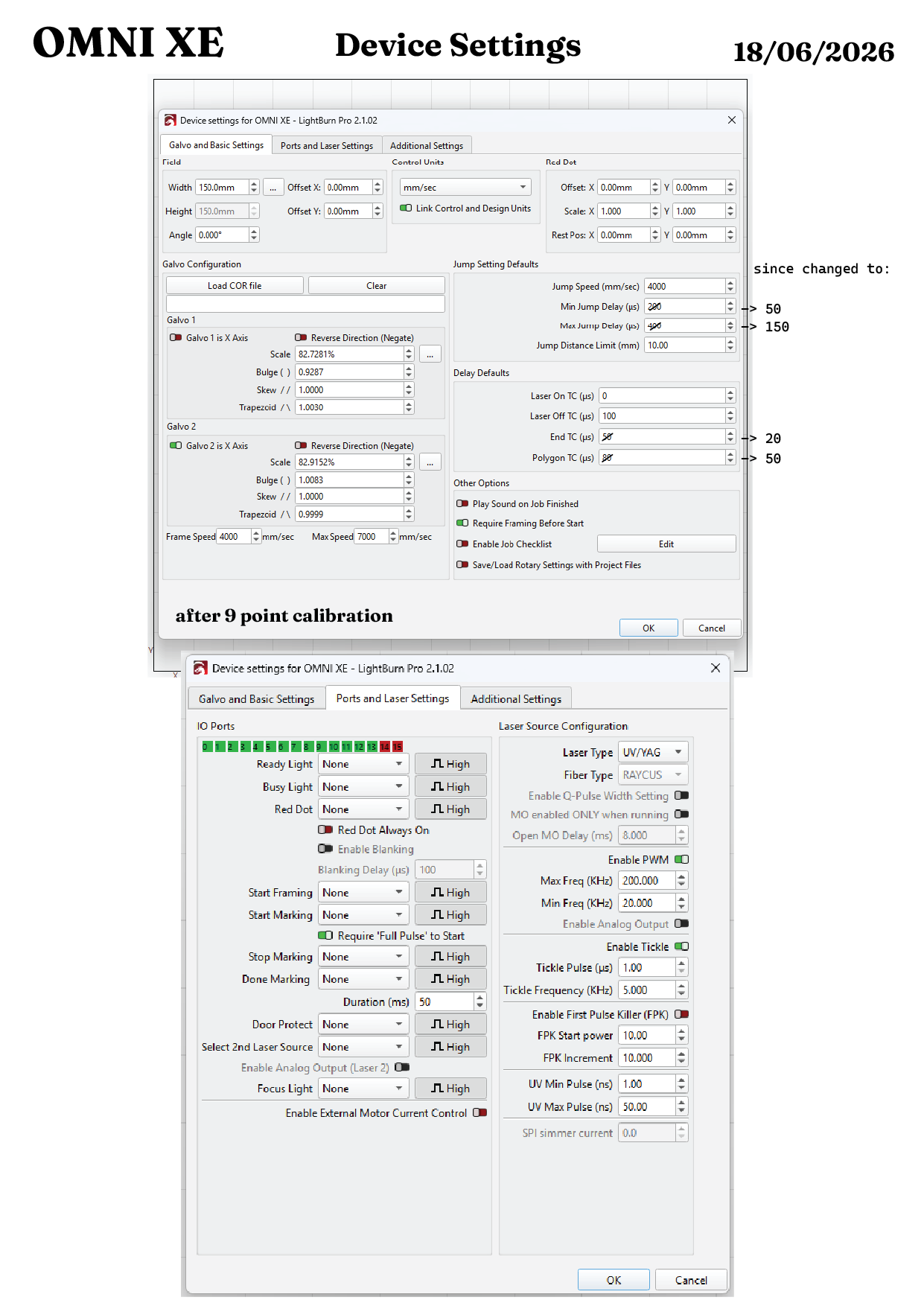

  • 9-point calibration done on both; flat engraving is perfect and correctly aligned on both machines

  • Latest mainboard — confirmed by ComMarker, so this isn’t the older-board torque/slippage problem from the other thread. Crucially, I get no slippage — my engraving comes out correct every time, it’s purely a speed/efficiency problem.

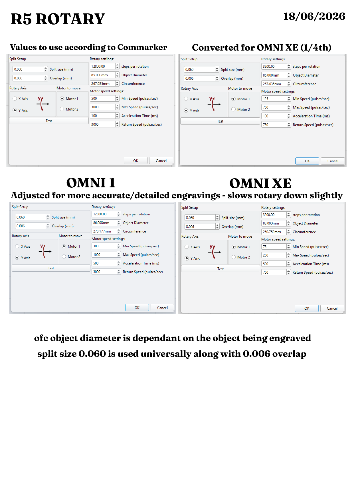

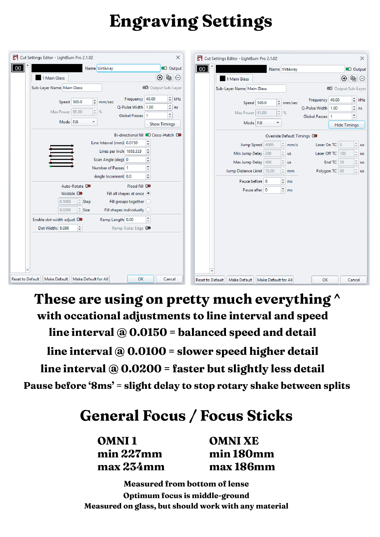

  • Steps per rotation — 3200 gives exactly one turn on the Test button (the manual’s 12800 is wrong for this machine, as others in the other thread also found). I’ve tried other values too; none change the return-to-centre behaviour.
  • Settings — I’ve experimented with various settings, including jump delays, TC / delay defaults, etc.. and rotary speed settings, to no effect.

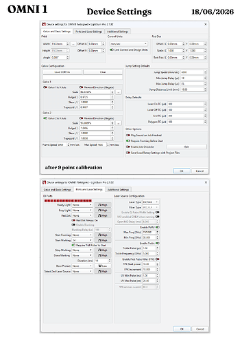

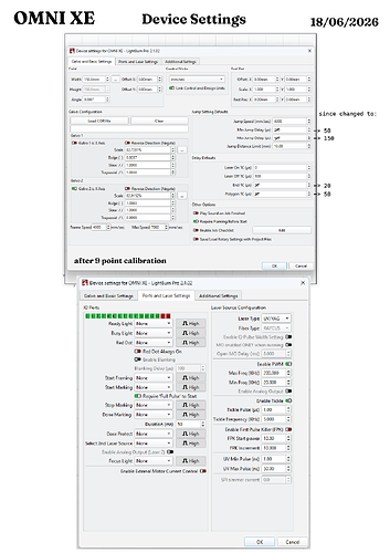

Attaching some images below showing my settings (this is my own internal backup, you can ignore some of the additional text on there)
  • Device Settings screenshots — both machines, both tabs
  • R5 rotary settings — Omni 1 and my XE conversion
  • Material settings — used on both machines
  • ComMarker Studio version/board info
