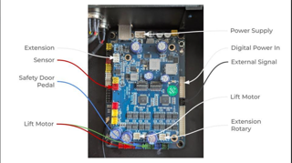

I’ve been emailing back and forth with Com Marker about probably needing a new motherboard. I had the 6w Omni X but swapped it out for the 12w for the larger cutting area. The switch has been rough - 2 steps forward and 1 7/8 steps back lol. I know the rotary setting changed from whatever it was in the Com Marker manual to 1600 now. Still having the same issues I had before I swapped lasers as far as jumping around. Slowly experimenting in the dark…
Same issue here 3200 for me but a lot of slippage
What do I need to tell them to send me the new board. the translation can be hard

Definite resolve of rotary problem with lightburn (for now) is to change the motherboard. I did it, one guy from here also did it. Now everything works perfect. For over a month I had 0 problems. Guys from Lightburn working of software solution but as for now, changing the MB fixing it instantly. It is not huge deal to change it, some leap of faith and it can be done.

As @jrhaim mentioned, the motherboard swap is a proven fix.
We also noticed, that the rotary has ample holding torque, if you use ComMarker’s program first, and then switch to LightBurn without restarting the laser!
We are in the process of determining what to send to the laser to adjust the motor current via software.

New motherboard received and installed. Went back and forth with support as their idea of install instructions was a couple pictures with instructions to be careful… after several back and forth did get a better picture with details for what each wire bundle was connected to . Hope this helps others.
By the way, motherboard fixed rotary issue. Now just working the parameters for the Omni X to get a silver finish engrave on a makerflo tumbler… have gotten beautiful variants of Bronze…
