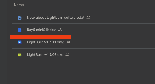

Your laser manufacturer has included an .lbdev file that you can import into LightBurn’s devices menu.

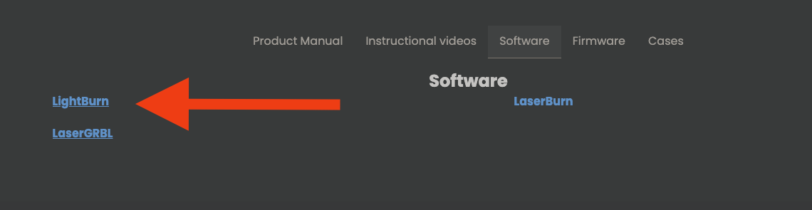

I used “NanoDuo.lbdev,” which is recommended in the manual and also on the official website.
Everything is without errors and without alarms. The focus is set to the manufacturer’s recommended distance of 150 mm, with manual fine adjustment so that the aiming points overlap into a single point, again according to the manufacturer’s recommendation.
One more important thing. Engraving works in LaserBurn. I couldn’t find any significant difference in the settings or anything critical. I also verified the license validity and checked other things to make sure I didn’t overlook anything.

I thought this was a typo, but I see it is their proprietary software. This means they have access to communication details not shared with the Lightburn developers. so yes, it is going to do things Lightburn cannot. Your “just sits there” also suggests it is not really Lightburn compatible.
Maybe you can try reinstalling this file. If I remember right, you just drag it into the Lightburn grid area to load it.
Hi, I reinstalled everything and it looks like everything should work now :slight_smile:
