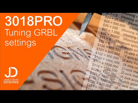

There are a number of videos on how to tune up a grbl machine. I got mine running so fast I thought it would self destruct when it did a job…
Although this is for a cnc with a spindle the basic idea is the same…
