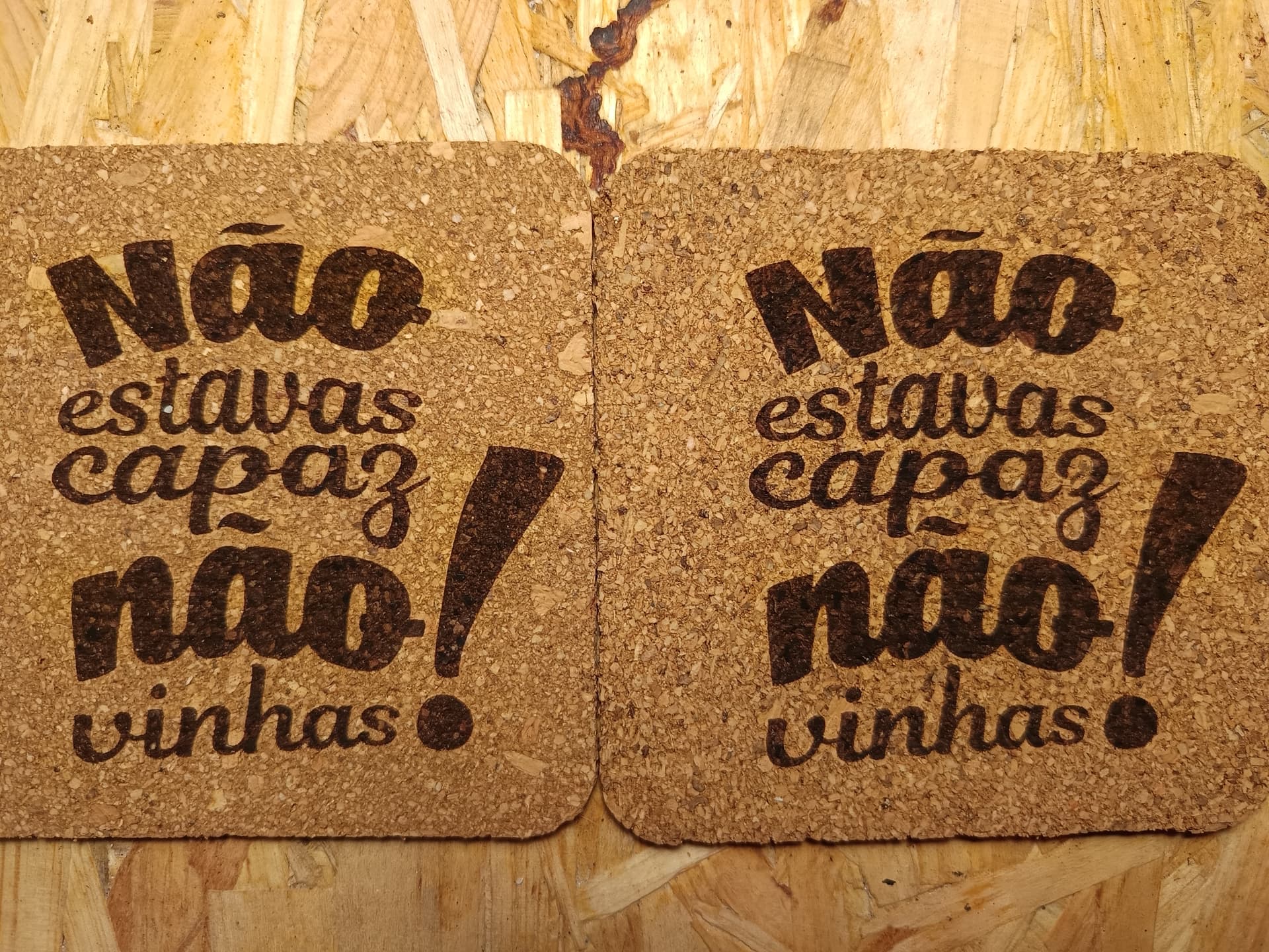

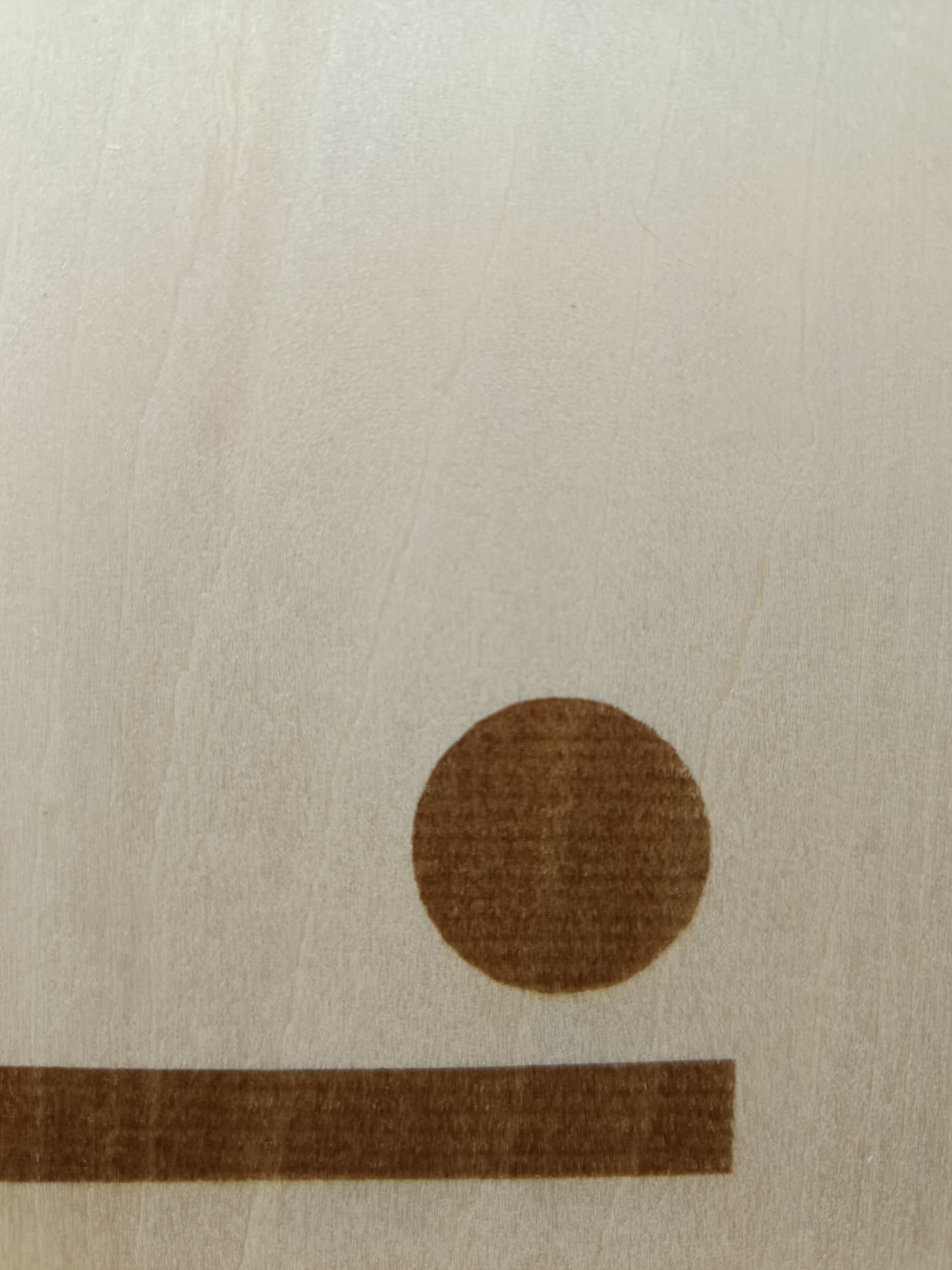

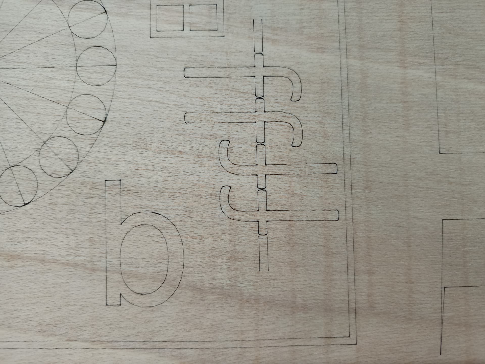

I’m new to laser engraving and just started testing different materials. Everything was fine with the material test results, but when I began engraving pieces, the problem started.
When I engrave two cork pieces with the Fill All at Once setting, I get visible lines on the engraving. However, if I engrave just one piece, or two pieces but using Fill Shapes Individually, the engraving quality is good.
Am I doing something wrong? Could this be a machine issue, or is it just a configuration problem? I even tried reducing the line spacing, but the problem still persists.
Any help would be greatly appreciated.
Thanks in advance.
Machine: Longer Ray5 10W Software: LightBurn Pro 2.0.03

The big difference between the two types of “Fill” you mentioned, as already mentioned, is that while you run both jobs at once, the laser, in addition to the laser module speed issue, also has the issue of the opposite end of the laser head having more time to cool. With organic materials, it’s easy to see (I think) that the temperature they reach during engraving can be crucial to the final result.

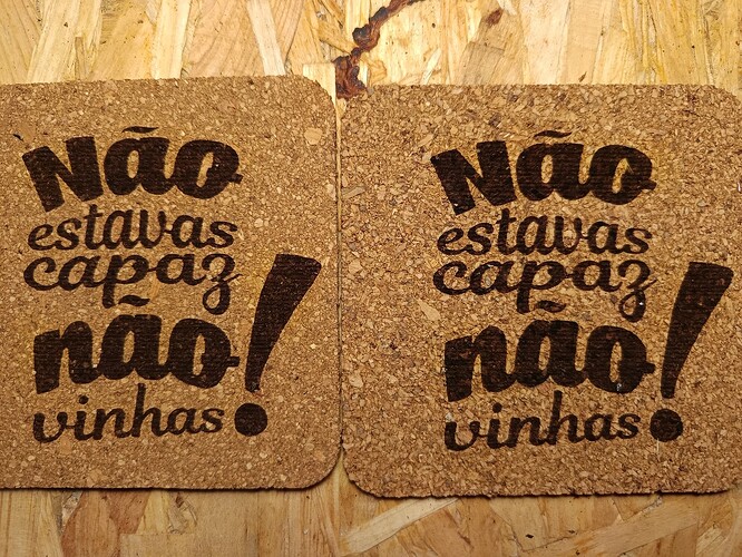

I tested reducing the speed, increasing the power, with and without dynamic power, using different materials and different projects, but the result is always the same. I even drew a rectangle about 10x150 mm so the laser would engrave continuously, and the problem still appears. What’s strange is that with this rectangle, the laser doesn’t even have time to cool down.

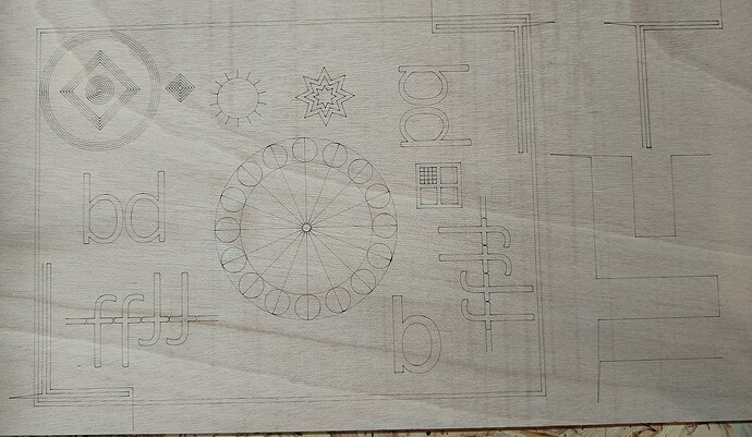

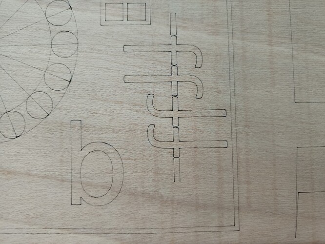

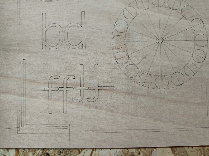

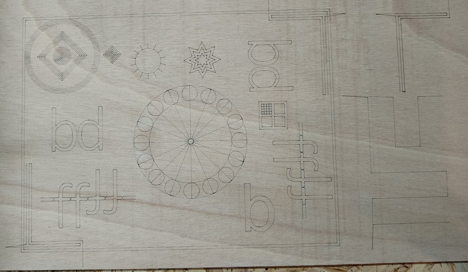

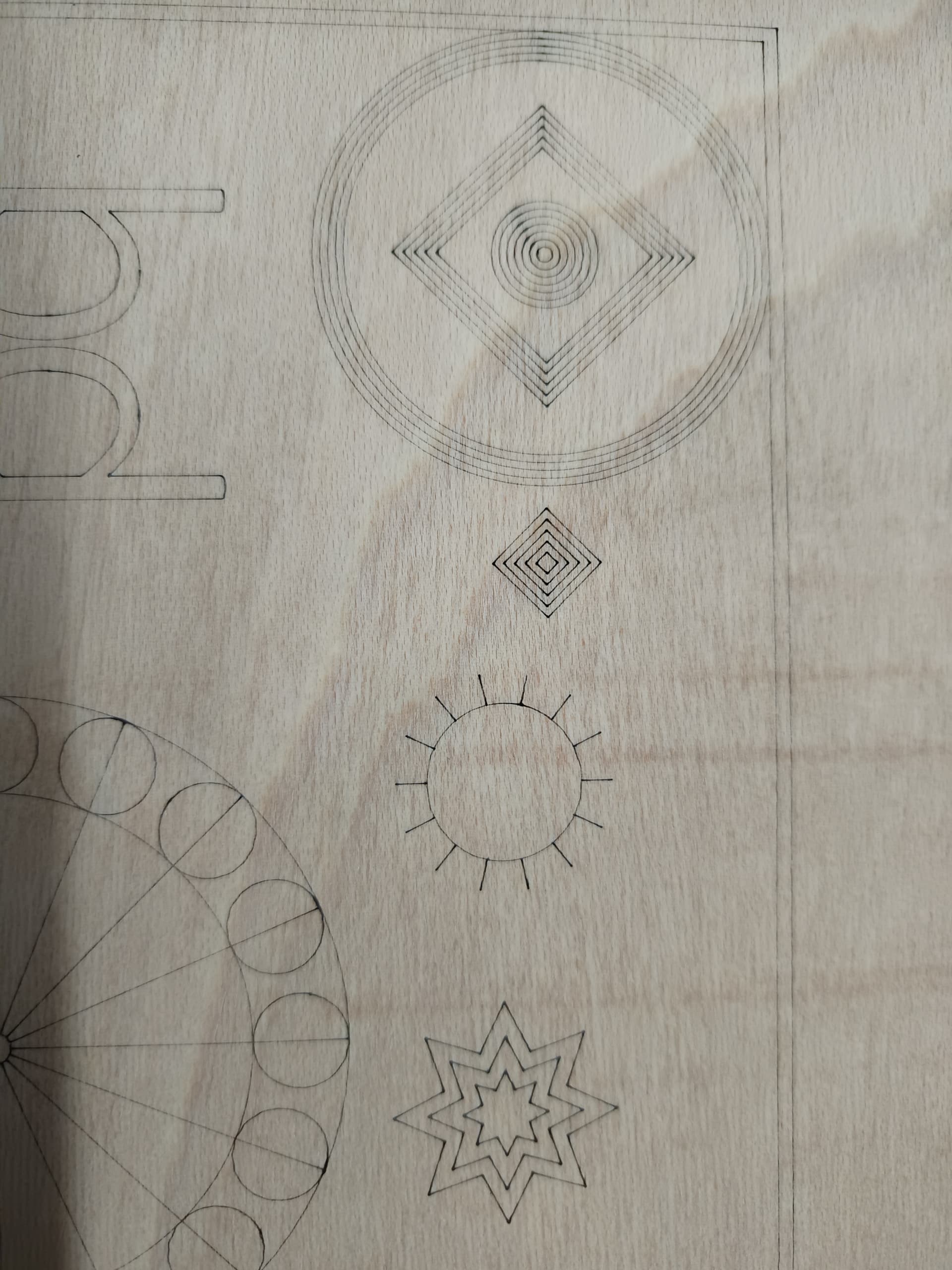

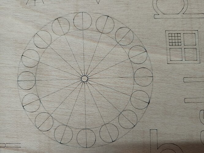

So after you suggested a hardware problem, I went to check the whole machine. I adjusted the rollers and belt tension, and I found that the eccentric roller for the X axis was loose. I tightened this roller and checked all the others. After that, I started getting better results, still with lines, but much better. However, now the engraving looks sloppy on the edges.

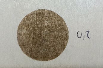

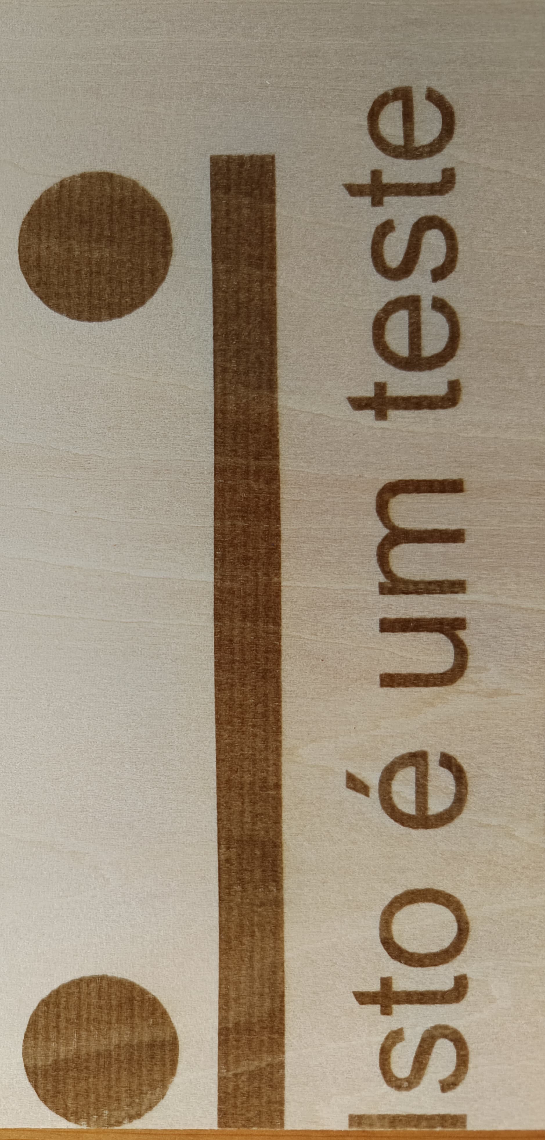

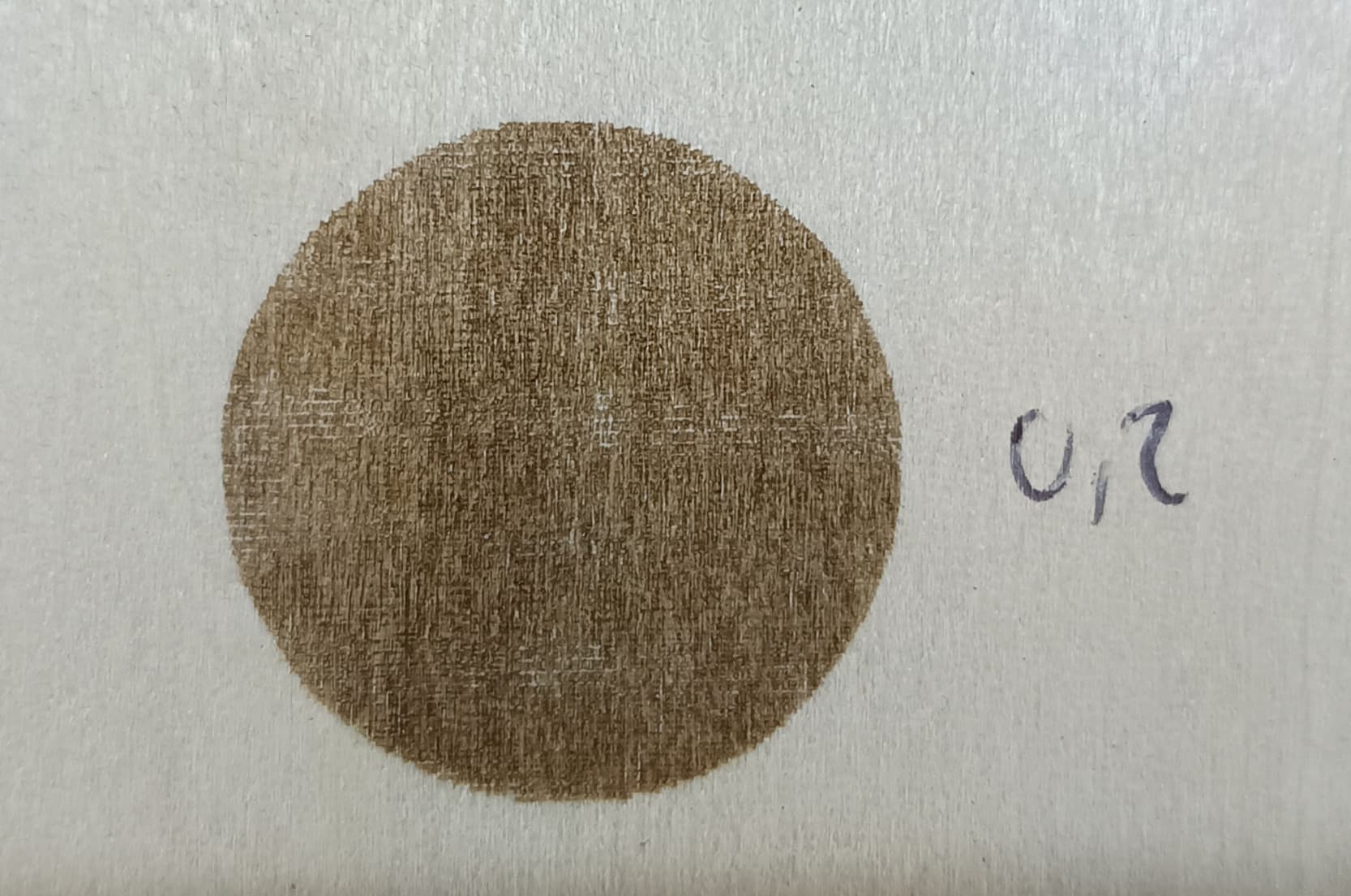

I followed all the steps from @MikeyH’s link, and afterwards I ran an engraving test at 6000 mm/min and 30% power, keeping the rest of the parameters unchanged. Here’s the result.
I do not see a problem at that speed, but the Mfg says max speed is 10,000mm/m. I also see nothing indicating the size of the burned image. However, I do not expect to see something needing a fix.

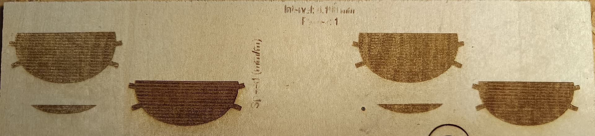

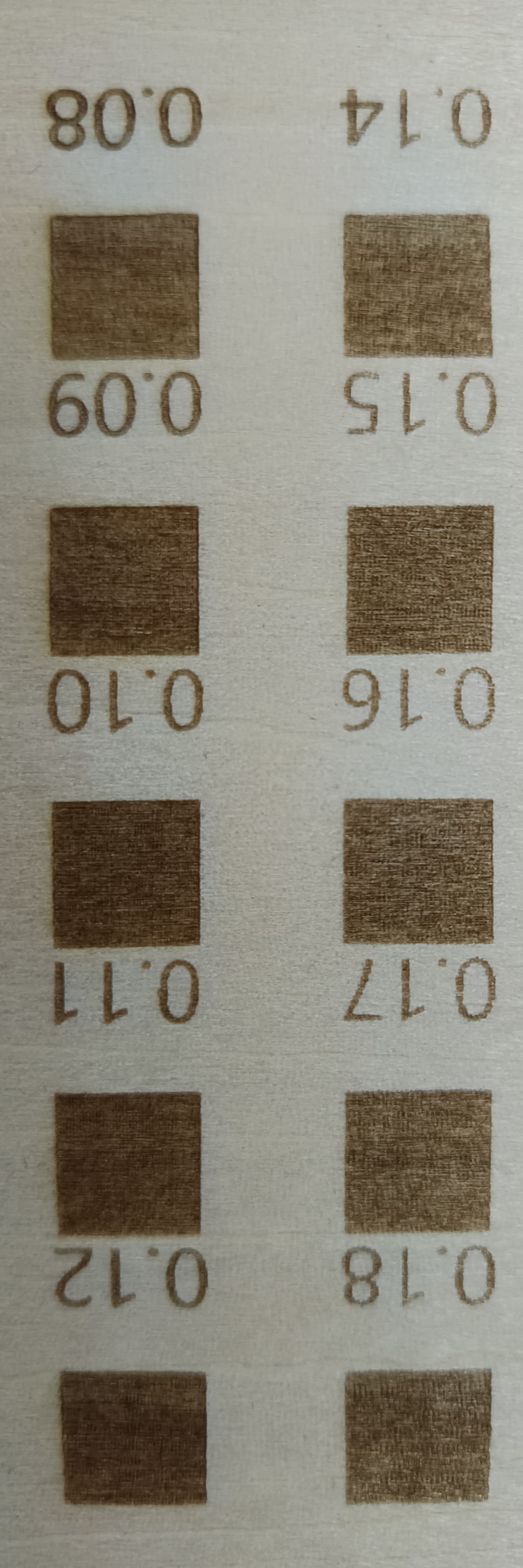

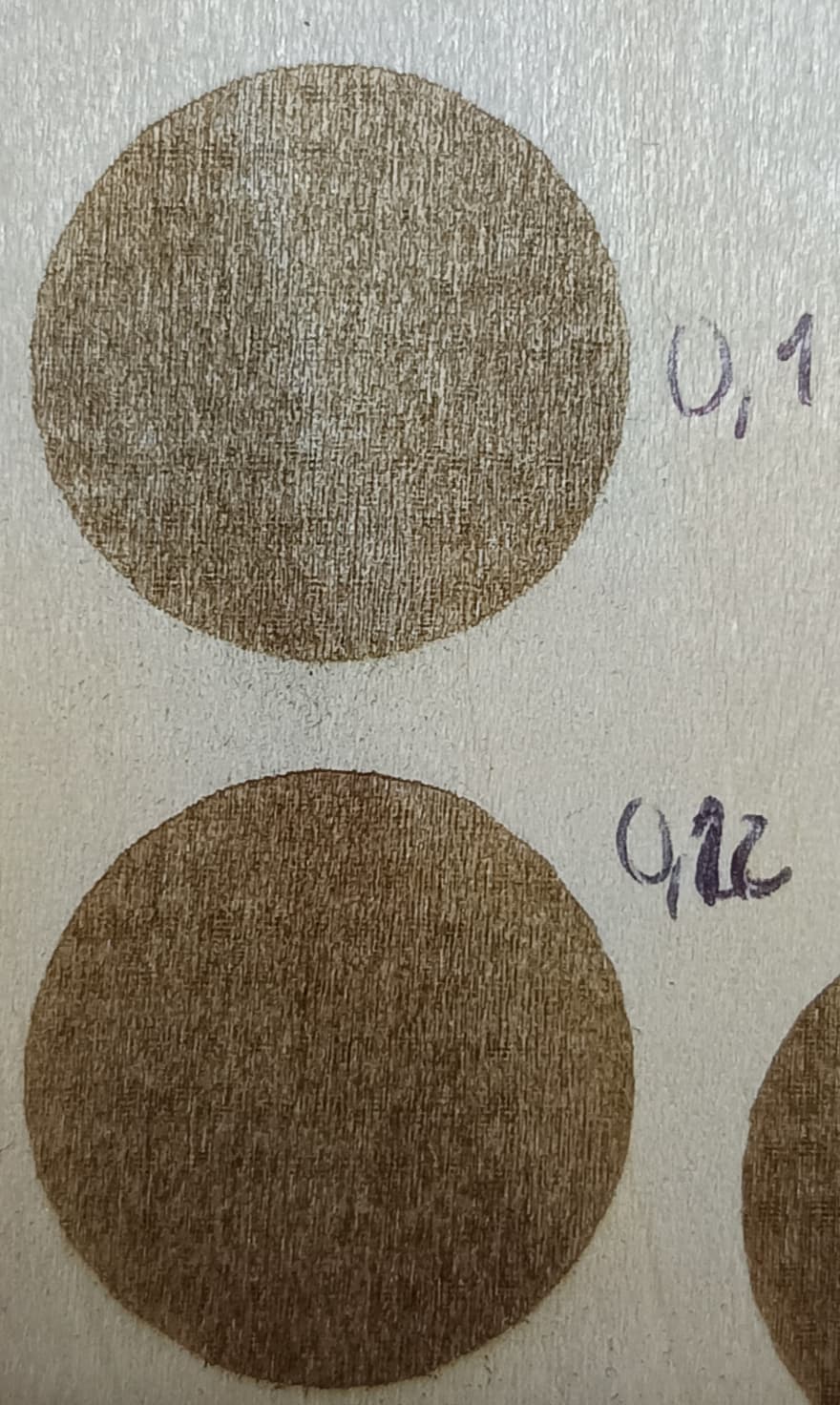

In your earlier image (see below) I see what could be overlapping burn lines. In other words, pretend your dot size is 0.10mm, but your line interval is 0.07mm. In more other words, one pass covers part of a previous pass already made. Try reducing your LPI by 20% or so and see what happens.
Looks like .12mm LPI does the best from here. I doubt you will see any better with wood. If you want to really dial it in (fine tune the adjustments), buy some black anodized aluminum cards.
