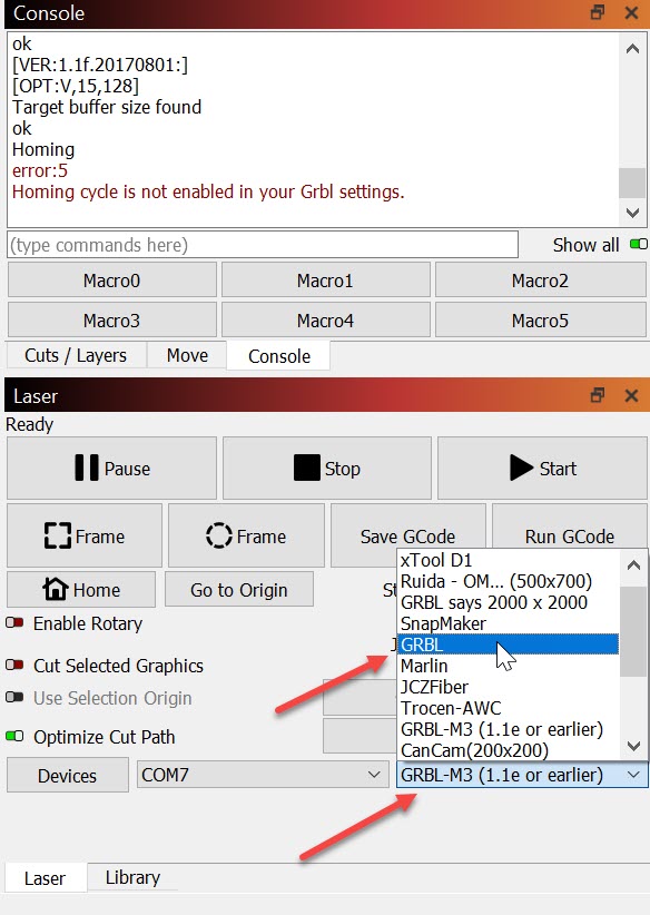

Change your device from GRBL-M3 (1.1e or earlier) to this GRBL
Iâd advise that you go ahead and make the GRBL-M3 â GRBL change that Jim has suggested. Thatâs likely not the root cause of this particular issue but will cause you other issues.

Iâd also encourage you to change your device profile to GRBL. You can do this by going to Devices and editing your current device.

Open the Laser window and Click the GRBL-M3 box lower right hand corner.
Click GRBL, this will change it to the other device profile.
In the Console window you should see the connection message again.
Save File, and Click Save and call it, Alvin GRBL
If the GRBL profile is still shown in the bottom right hand corner of the laser window, feel free to send it to the engraver.
If you Save GCode now, (it will probably use the new filename) you should see the change in the Device Profile and in the âflavorâ of the GCode.

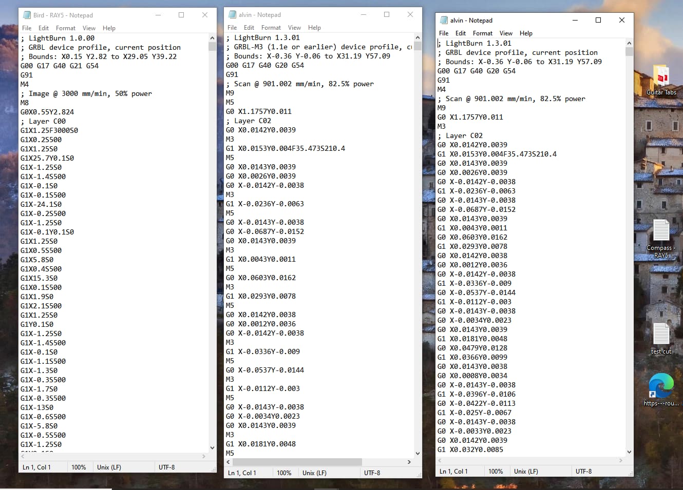

I went ahead and made the changes to my laser settings I saved the alvin file as alvin GRBL ran it with no change I sent screenshots of my settings and also opened the files in notepad to verify the changes were made maybe you can see something I might of missed.

Itâs not clear what files are what. I assume the file at left is the original file from Longer, middle is before changes, and right is after changes?
Please confirm.
If so, itâs good that the device type was changed to âGRBLâ. However, it looks like youâre still using âinchesâ for units. Can you push the âinâ button on the Numeric Edits Toolbar so that it switches to millimeters? Then save gcode again and try running on laser.

I think you did it I did a quick test cut saved in mm itran and I could reframe it. So I decided to resave alvin in mm it ran and I was able to re frame it. So basically what your saying is I can design and work in inches but have to remember to save in mm. I can deal with that.
