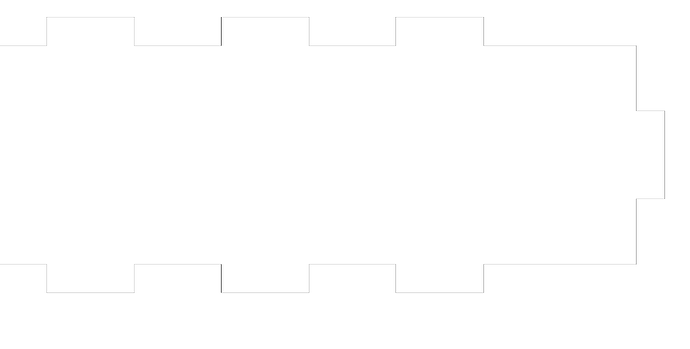

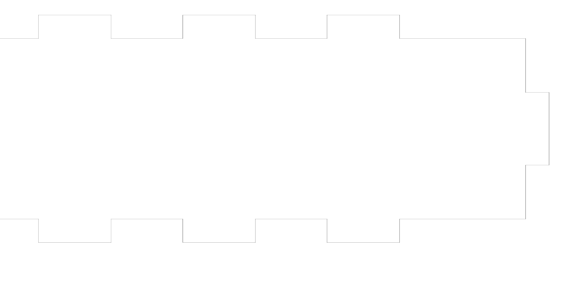

RE full length fingers: Here’s the output from cuttle, it & the others eliminate partial fingers as you can see on the right side of this image:
, where-as if I’m doing it on my table saw, I would have a half finger on the right side instead of that extra long flat space.
Here’s a correct box joint:
Of course, this one was done on a table saw, with the finger joints cut to come out evenly.

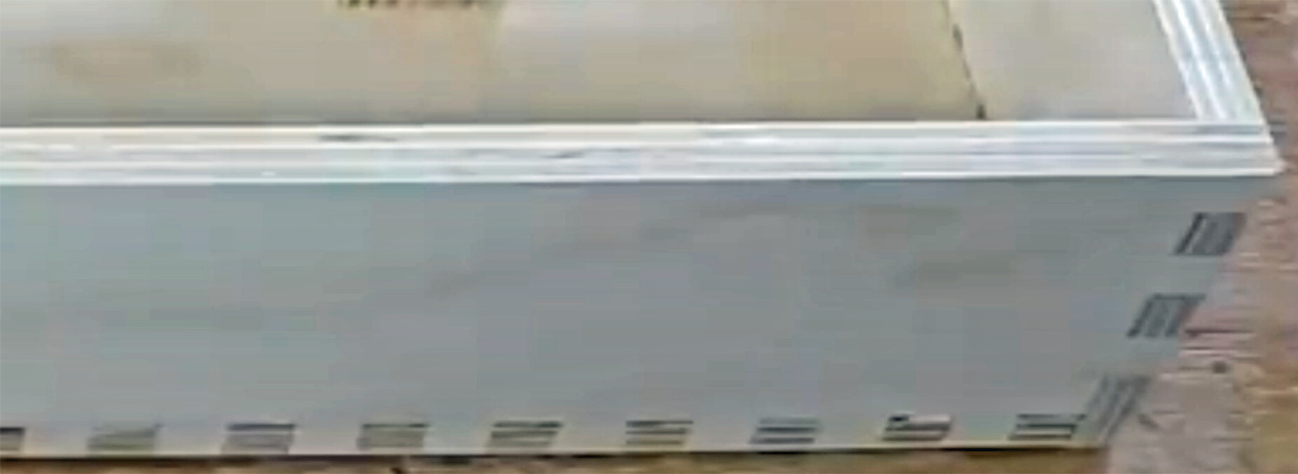

One more example:
in this captured (or supported) finger box, ideally there should be 4 & 3 fingers instead of 3 & 2… I can fix that in Lightburn, but I shouldn’t really have to.

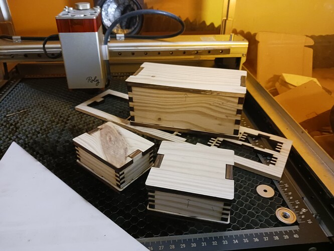

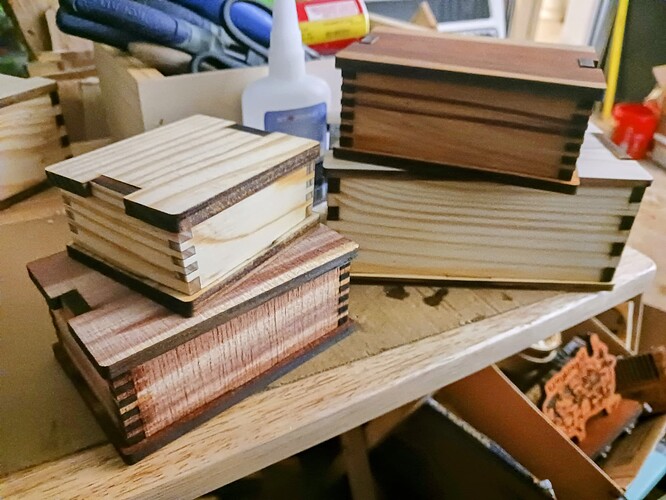

I like to make useful little finger-jointed boxes using laser and Lightburn… from thin bandsawn planks from small tree branches and scraps of construction lumber.
I start by using Boxes.py or MakeABox.io (and others I’m sure) to make an appropriately-sized generic six-sided box with lots of fingers (usually related to thickness) running along all edges. I also apply kerf correction here… and zero out the kerf settings in Lightburn. I usually use 0.12mm or 0.13mm for a nice fit.

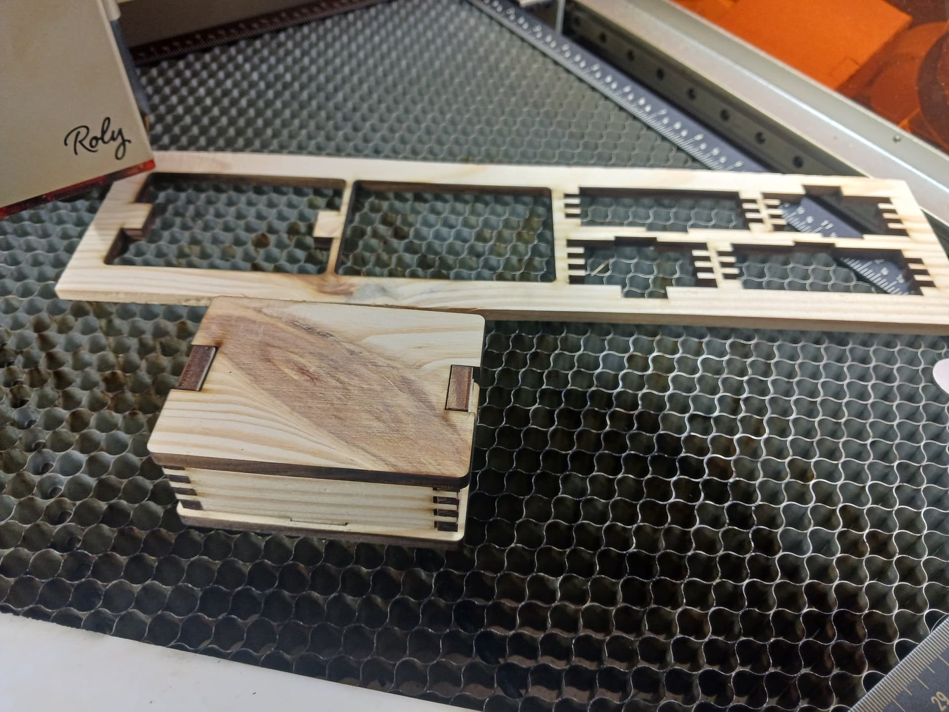

Import the SVG, PDF, or whatever into Lightburn and use the node editor to adjust the fingers and tabs to suit the design I’m looking for. This can go pretty quickly by simply box selecting and deleting/moving nodes or groups of nodes to form new tabs/fingers to suit… leftmost box design (below) as imported into Lightburn and rightmost group is partially adjusted using the node editor.
Once satisfied with the result, place material on the laser bed and laser the result. Here I’ve used a 45-degree orientation of material to compensate for the difference in X and Y kerf… but depending on your laser you may get satisfactory results without the 45-degree adjustment.
This works for me… YMMV, of course.

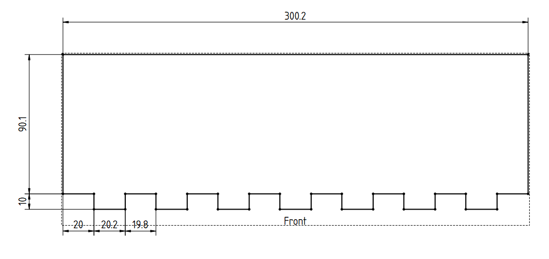

Further to my earlier reply, I’ve knocked up a very simple example in FreeCAD (which I’m not very familiar with at all!). The model is driven from an internal spreadsheet where the various parameters can be entered. These drive the solid model which in turn updates the 2D tech drawing. This can then be exported as SVG, DXF or PDF. This enables you to have different X and Y kerf values.

If you need a different size or number of tabs you just enter the new values into the spreadsheet and the model and the drawing will update automatically.
Let me know if you want my example file to use as a reference.

Here’s a screenshot of the drawing with some dimensions added:
Obviously this is a very simple design with only single axis movements (no angles or curves) and it would be more difficult (and in some cases impossible) if it contained such elements. I don’t think I’ve missed anything obvious but I’m sure you’ll let me know if you find anything amiss! :wink:
