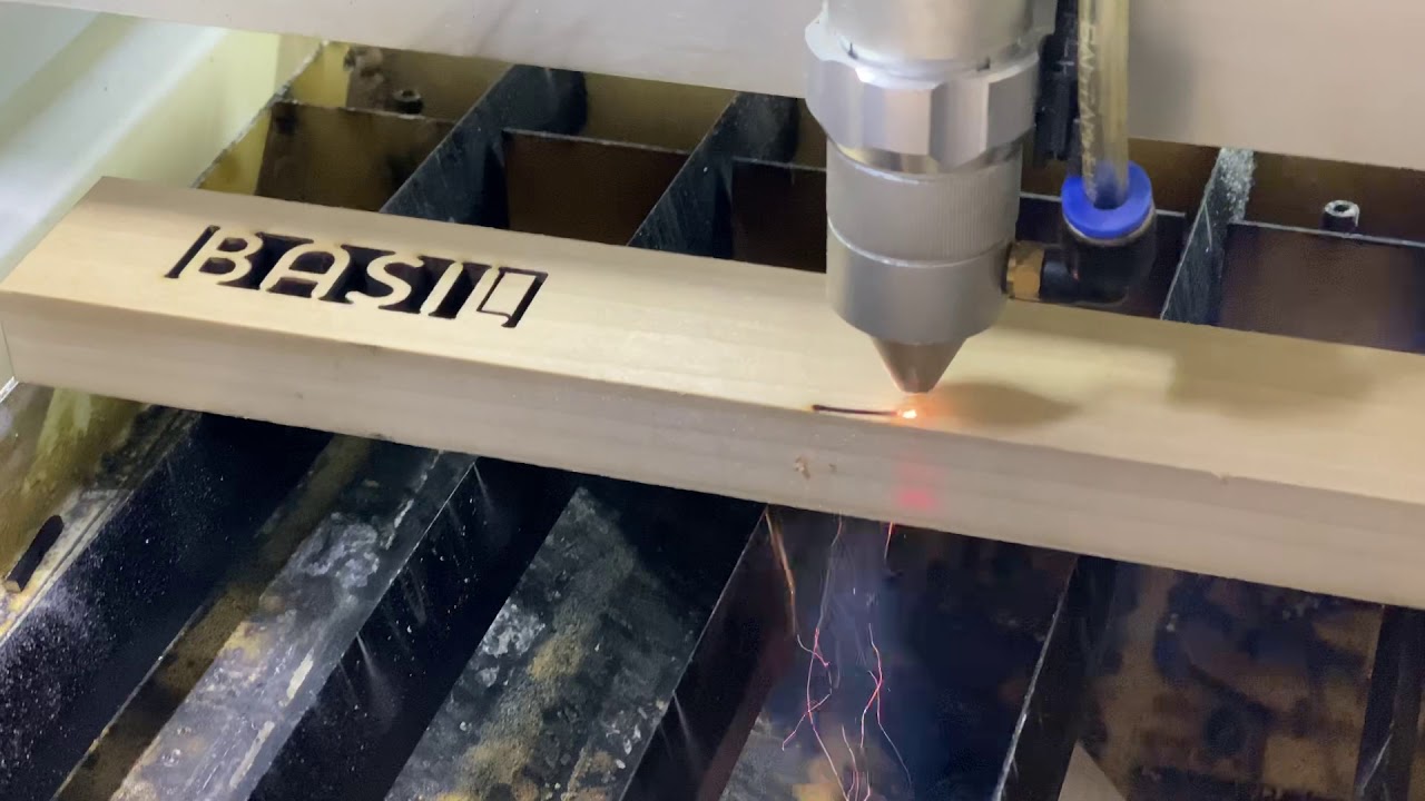

Looking to see if anyone here knows where I can find a font or pre made templates like this so that I can make a few of these without having to reinvent the wheel.
Thank you in advance for your suggestions.

Step 1. Draw a stick thing.
Step 2. Make some text with the same layer color as the stick thing. Align them how you want.
Step 3. Make another box the same color and height as the letters, and slightly wider. Align it with the text vertically and horizontally.
Step 4. This probably could be like… step 2.5 or something, but you’ll need to boolean difference the outside and inside boxes. Select the outside one first, then the inside one, and use Tools -> Boolean Difference. This turns them into one solid shape.
Step 5. Combine the words and stick thing with Boolean Union. You’ll want to make sure your text is through the stick thing. Zoom in and you should see it like this:
After Boolean Union, you’ll see them one shape, like so:
Voila.

Have you considered acrylic as the material to make them in? Acrylic would work very well outside or piercing into moist soil.
I made a demo for you
I would use 1/4 colored Acrylic

@Sasquatch, does this mean I need to remake my video using wood?
Ohh no, I loved your video, especially the perforations, that gave me an inspiration for another project… I will make them out of acrylic and sell them online to sell to people in your state… ![]()
Well, that inspired me to make another one just to show off the power of my laser vs 3/4" solid poplar. You want wood, there’s your wood. lol
(but I think this is too thick for its intended use) ![]()
Also, just order tons of tongue depressers. They’re cheap, you can make some killer margin, and they’ll be afforable. They’ll buy them every year!
Way cool and powerful @Stroonzo. My favorite part was being able to see the power of the laser glow on the side of the wood being cut.
