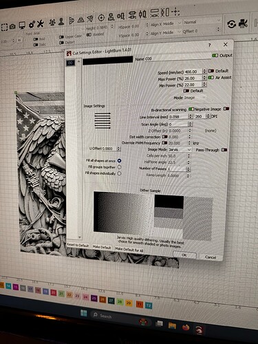

Yesterday I was burning 15" x 15" images. Everything was fine.
Today the burn is going about 1" longer in both directions in X and hitting my magnets.
I’m using a Ruida on an Omtech 100 watt laser.

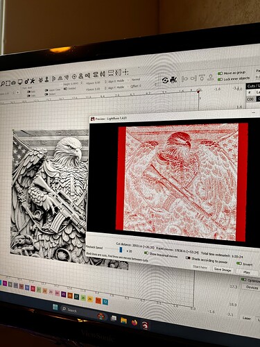

Does the preview indicate a large overscan?

Yes it shows in rendering.

If I zoom up on the red / no cut overscan there are black cut lines in there.

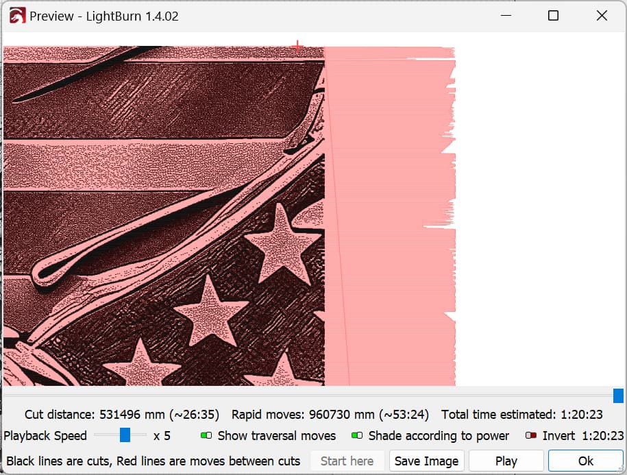

To be clear, my concern is not in the overscan itself as that seems normal based on what you’ve shown. It’s that you’re saying that the laser is firing at the fringes of the overscan. That is definitely not right.
If the firing is based on instructions being sent from LightBurn that indicates one potential problem. If however, LightBurn is not instructing the laser to fire at those times then that points to a hardware problem. If hardware, I would suspect LPS but I’m not familiar enough with all failure conditions to say with certainty.

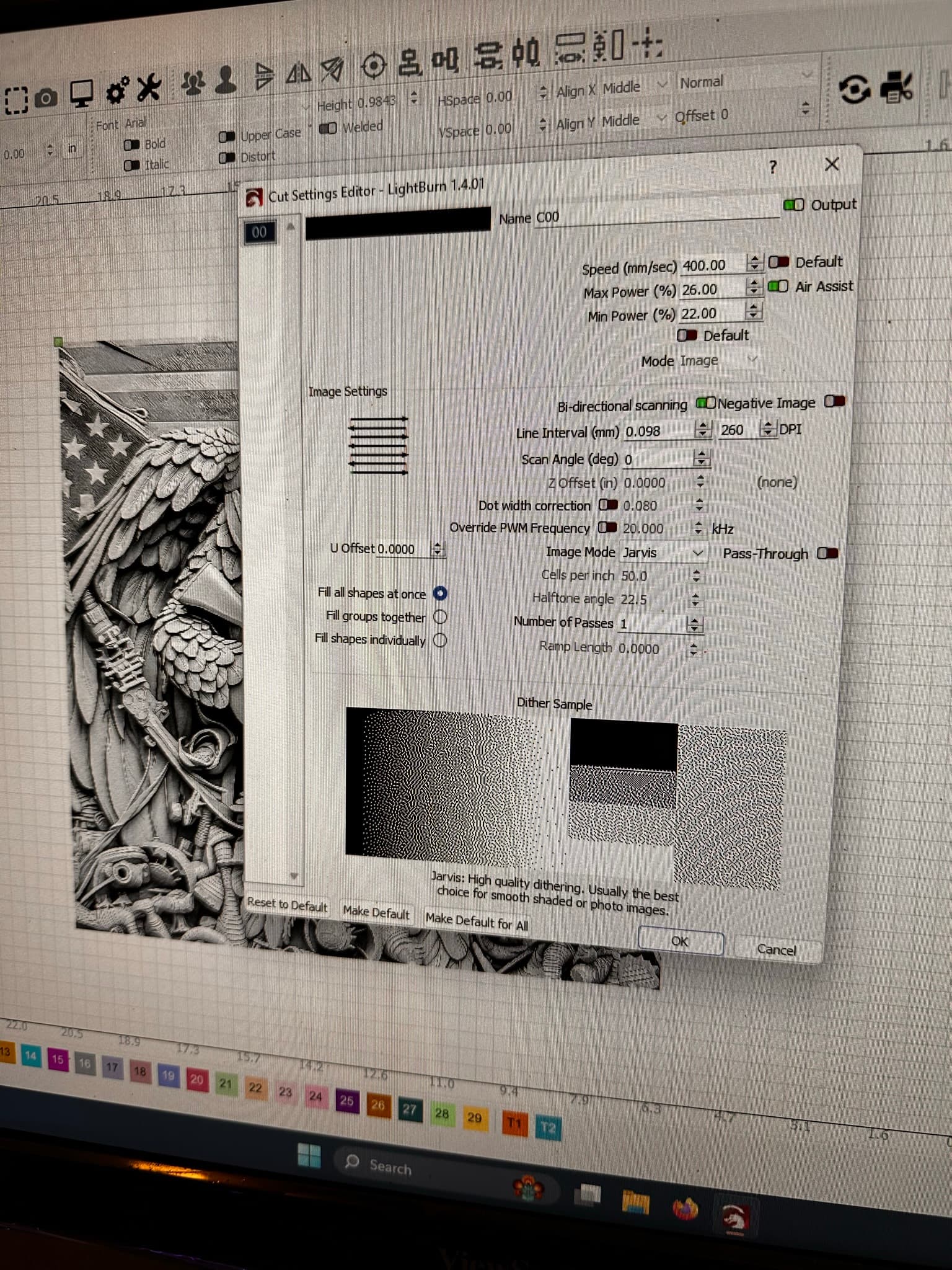

One other thing to look at. Do you have an Scanning Offset Adjustment set in Edit->Device Settings? I could see that potentially changing travel distances.
I’m looking at the .lbrn file. I don’t see anything specifically wrong with it. The artifacts at the edges of preview are a non-issue. It’s just the overscan reflecting the rough edge of the white true white are of the image.
Note how the white fringe matches the actual image.
I also took a look at the RD file which didn’t show any artifacts.
Bottom line, I don’t think the firing at the edges is being instructed from LightBurn. This is either a problem at the controller or downstream.
