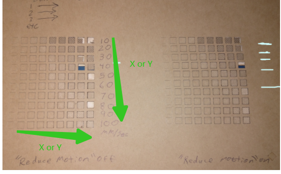

Losing alignment when traveling, can't make acceleration change write to hardware, xTool D1
This is to let you know you are not alone. We have had our lasers (xTool D1) about the same length of time and I have the same problems that you do. The default acceleration and speeds seem to be hard coded into the firmware of the D1. My laser fails when beginning or ending traversal moves, often when switching from engraving to cutting. I have included a crude cross hatch test grid that I have been using to test if changes I make improve the D1s performance or not. For me each row prints fine, but when it switches rows that is another story. The next row can be shifted in either the x-axis, y-axis or both.
grid fill cross hatch slower.lbrn (60.5 KB)
Things that have helped me were reducing the belt tension about 1/3 of a turn, wiping down all of the rails with a lint free cloth and applying a very thin coat of silicone oil to the rails. You might not believe that what actually makes the most difference is increasing the room temperature to 75 to 85F. It takes several hours for the D1 to warm up but then it actually seems to work. I have not (yet) had a failure when it was hot. Until xTool lets us lower the max acceleration I am going to be sweating when I’m cutting.
Note: I was using the test file on heavy mat board and in places it did cut through.
Thanks for the info, I’ll try that out. I have it mostly working for my current project, but it was a TON of fussing to get jumps out of laser path and going 80 mm/sec. I cant tell you how happy I would be if your tips get this working until firmware update.
Here is my .lbrn test file (thanks @elcdesign)
It definitely accelerates faster than the burn settings on traverses, I think it is going for 100mm/sec.
I do not have fast whitespace travel on.
As much at I like this hardware I am considering returning it. I can always buy another one if they fix the firmware so we can adjust machine settings. I have tried to press tech support on a timeline for firmware update, no direct answer yet.
grid fill cross hatch test.lbrn (60.5

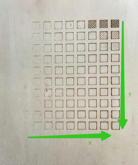

Writing to give another example of what I believe is the same issue, only with the rotary (leads me to believe firmware issues).
Same as yours, the error is always in the same direction.
If you can’t control acceleration settings for rotary you’re pretty much going to have a bad time. Rotaries are finicky even under good conditions.

The first image in their reply below is the burn they made from my test file, the second is one I made

And please confirm if the shift derection is Y axis or X aixs?
P.S. I can edit any post but the first one… if anyone wants to edit my misspelling of losing in the thread name they are welcome to :slight_smile: loosing is almost what is happening I guess, but not what I meant to type :smile:
It seems they’re calling what’s causing the “shifting” as offset compensation but that sounds odd. And unless they explicitly say so I wouldn’t expect them to allow for grbl configuration changes. It seems this is a deliberate choice that some vendors make and not a bug.

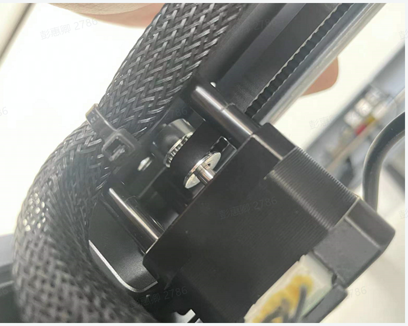

I sent them the picture, they asked about this before and I have checked belt alignment a few times during this ordeal, always perfect, I haven’t adjusted that one from factory other than belt tension.
support (support)
Jan 10, 2022, 5:52 UTC
Dear,
D1 does not support change configuration on Lightburn.
In this case, please check whether the X-axis synchronizer Wheel on top of the frame?
May I have this picture on your machine.
Looking forward to hearing from you and have a nice day
Best Regards
Email: Support@xtool.com
WEB: www.xtool.com
Global Leader in STEAM Education Solutions
Here is an example from when it vibrates the head for no apparent reason when it should be scanning at a consistent speed. note the “drilled holes”. (don’t mind where I burned too deep through my test ply :smile:)
I would have hit stop if I had been standing there, it can’t be good for the steppers. It can’t be good for anything on the poor machine.
I have had it shake the set screw loose and drag laser on table, that’s always nice.
