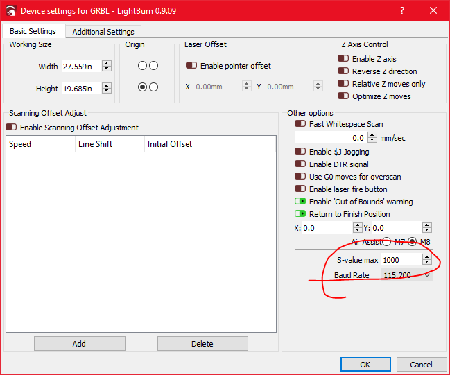

If you go to Device Settings in Lightburn, what’s the value of “S-Value Max”?
S- Value Max is 10.000
Change that to 255 and then run your program again, and let us know if it works.

i used $121=10.000 and $122=10.000
and had to set power max to $0% to see something
it seems that the laser swich on with delay
sorry typo: laser to 40
