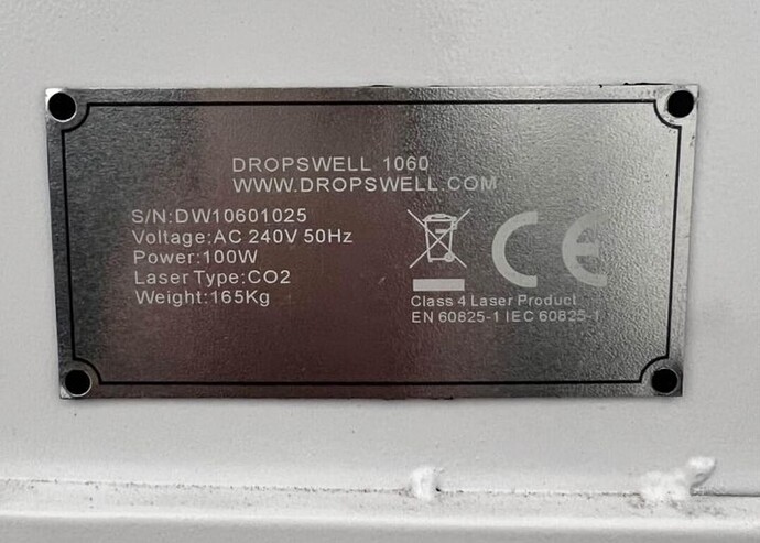

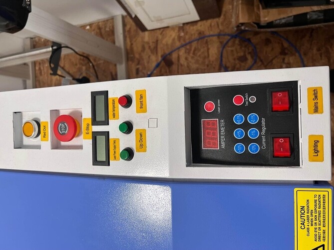

I have been offered this laser as an adition to the one i already have.
I dont recognise the brand and there doesnt seem to be a controller present.
Here are some snaps of the machine, the question im asking is, will it work out of the box with lightburn run direct to the internal conteoller or will i need to install a new ruida?
Thank you for your assistance.
Wow… “Dropswell.”
Doesn’t sound like a brand I would want to have delivered.
(Sorry, had to go there).
Not a bad looking unit though. Some nice features in its design.

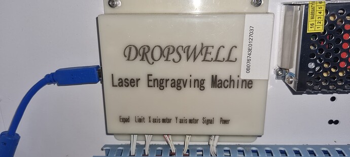

It looks like it has a typical Nano M2 (K40 style) control board behind those buttons.
Not likely Lightburn compatible as it sits, but you might be able to get a lighburn compatible K40 controller upgrade. If it were me, I would leapfrog straight to a good Ruida control system and never have to look back.

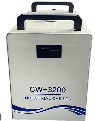

Machine comes with 3200 chiller. Rotary and extractor fan for $1200 i thought the price seemed reasonable.

$1200 is very reasonable. I’m questioning the “3200” chiller though… if that’s a CW-3000 series chiller, it’s really only a radiator and not a full fledged refrigerated chiller. I’ve just never heard it called a 3200. 5200… yeah, chiller… but 3200… uh… maybe not.

It looks to be a CW-3000 Series which is fine for me as the garage is usually around 18-20°C
I am looking at getting a 5202TH as im hoping that would cover both machines.
Yeah, I’ve used a CW-3000 with my K40 and briefly with my 60W.
In fact I have one for sale, now that I have a True 5200 series chiller.

I agree with @JMartin about it highly resembling a K40 type.
To be sure. we need to see inside the electronics cabinet and see what’s there… Post a photo of the board(s) and supplies… we can give you better advice…

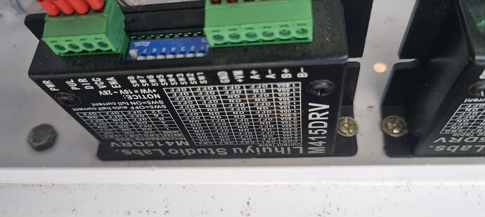

The Ruida does not have motor drivers, only outputs to them… about $20 US for each axes you wish to control…
It and the motor drivers require 24V.
The lps may also be a separate item, although most seem to have a single supply for both 24V and the hv for the tubes anode.
I don’t know how much current they can supply… you will be adding motor drivers, at least two and a more power hungry controller to the mix… ensure the power supplies can handle this.

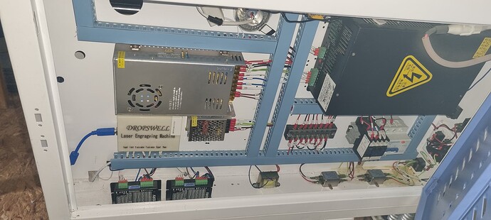

Hmm it sounds like the machine might need more bits than i originally thought.
Ill be able to see internals monday, and i can price up what extras i need, have to weigh it up against getting a alibaba red/black in the same size 1000x600mm
I was hoping it just needed a controller, would they be open or closed loopnl drivers? Im used to working with a DSP machine and tinkering but not a diy build, is this going to be more than its worth?
Generally speaking, if it is modeled after the K40 it will take some additions to bring it up the red & black level models that are a bit more expensive but more complete.

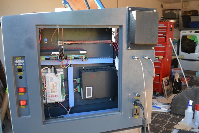

This is the electronics case of mine…
You might have to enlarge it, but I marked the controller, motor drivers and lps (laser power supply or hv supply for the tube). Can’t see the 24V supply below the switches…
Hope it helps you locate things… That machine probably has the motor drivers on the board…
Just plain stepper, not any kind of high priced closed loop stuff… that is a low cost machine… Mine was $2k US, a couple years back…

Quick update on the internals of the machine.

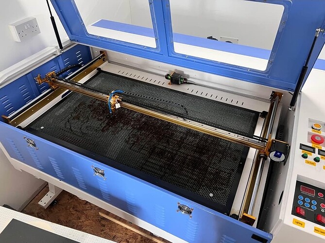

A new question has arrised, i want to use this to cut fabric from sewing patterns, the laser homes and reveals a bed size of around 1030mm x 600mm however the honeycomb installed is 980mm x 560mm the laser head moves far past this, can anyone recommend a alternative bed so that i can cut fabric? It doesnt have blades underneath the honeycomb rather a solid metal plate
Cheers
You can remove the honeycomb sheet and cut fabric directly on the solid plate, because it seems like there’s no air flow through the honeycomb anyway.
Although my machine does have knife-edge supports under the honeycomb, there’s not much air flow through the fabric while cutting, which is why I think you can cut on the plate.
