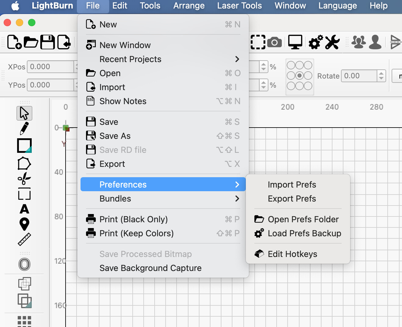

The easiest way to fix this is to install your old prefs file.

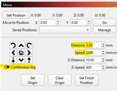

Are you using ‘Continuous jog’?
Can you try something for me please? If you disable ‘Continuous jog’ and set the distance to a small value like 5mm, a low speed, and jog 5mm in every direction, do these short jogging moves work as expected or do you have the same issue?

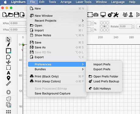

So the update installed on 7/30. I loaded my ‘prefs backup’ from 6/20, which was the last time I used the software. The problem still persists.
There isn’t a control for “continuous jog” on my ‘Move’ panel. Below my directional controls, there is nothing.
Regardless to what I set the distance or speed, the machine still jogs to the complete opposite corner. It also doesn’t matter what direction I click.

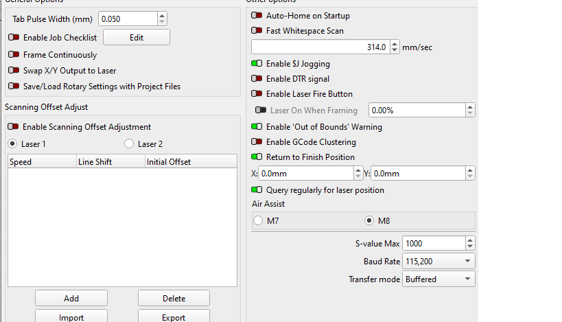

Update: I went into settings and enables “$J Jogging”. That caused the toggle control to display in my Move panel. It is currently not enabled. The problem still persists.
Update: I changed the speed and distance settings. The speed seems to have an affect, making the machine move at a very slow speed. But the distance makes no difference. It continues to try and jog all the way across to the opposite corner.

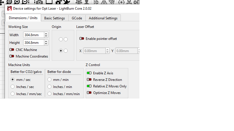

What are your settings in this area?, please add a screenshot of this ‘Dimensions’ page and the ‘Basic Settings’;

These are my basic settings and dimensions:
Please try the latest Public Release Candidate 2.0.03, and let us know if there is still an issue.
Do not worry about your license - if it was valid for 2.0.0 it will be valid for all 2.0.x versions. We don’t want folks to have to update to get bugfixes for features they already paid for.

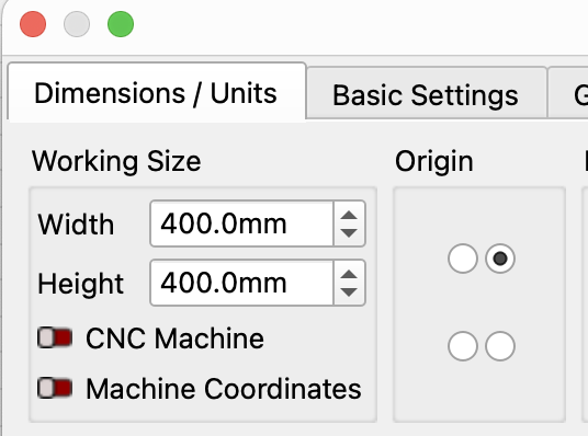

You should probably toggle on the CNC Machine toggle - your “home” position is clearly in the negative coordinates.
LightBurn does not normally appreciate negative coordinates. To use them, you need to toggle the CNC Machine setting on.
Also, given that you have multiple offsets (G54 to G59) listed, I would highly advise you also turn on Machine Coordinates, so that LightBurn sends all coordinates in absolute machine coordinates.
