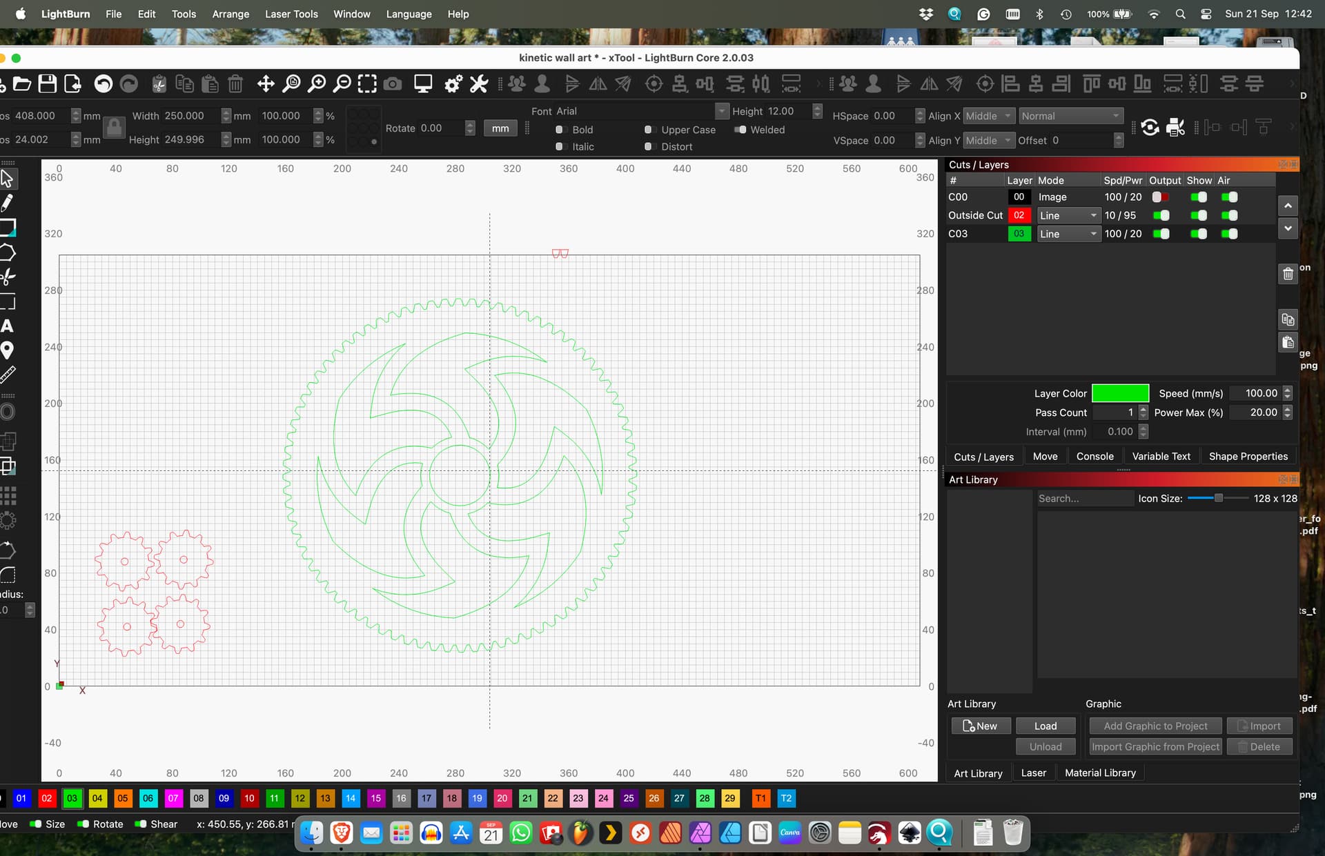

Over the past couple of months I have noticed the definition of the lines in Lightburn getting fainter and fainter - to the point that it is now virtually impossible to use.
I have spent this morning on the phone to Apple Support who have been remotely looking at my screen and display settings . They say that they can’t see a problem witht he Mac but accept that the Lightburn screen is virtually unusable.
So, assuming that my computer is not at fault, where do I start troubleshooting Lightburn?
I am running the latest Mac OS. and 20.0.3 in Lightburn.
I’ve attached a screenshot of the window which, in all honesty is stronger than I see on screen.

Yes we are aware of this issue on some screens. It seems that some retina displays don’t play friendly with some of the changes that have been made to the way lines are displayed.
What Mac are you using, and can you tell us exactly what your screen resolution is?
Your profile says you’re running Windows 10 on a MacBook Pro.
Are you using any display scaling?
Hi. I am using a MacBook Pro with an M2chip . I am running Sequoia 15.6.1 (The other machine I use for running my laser is a Windows 10.) I am using the Apple Display (P3-500nits) and using Promotion. When I was talking with Apple we went through all of the different settings and those were the best we could find. I am using the default resolution of 1728x1117 - changing this made little on no difference to the output on the screen.

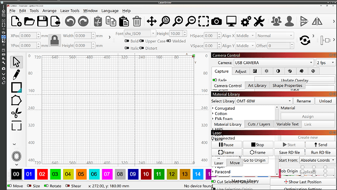

Super chonky:
Given longer arms, I could run it from the front yard on the 27 inch monitor! :grin:
Fiddling with the cursor / icon / font sliders cuts the surroundings down, but the layout math really doesn’t take pixel doubling into account: the dialog boxes / windows / whatever don’t shrink accordingly.
All I need is lines two or three pixels wide …

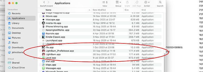

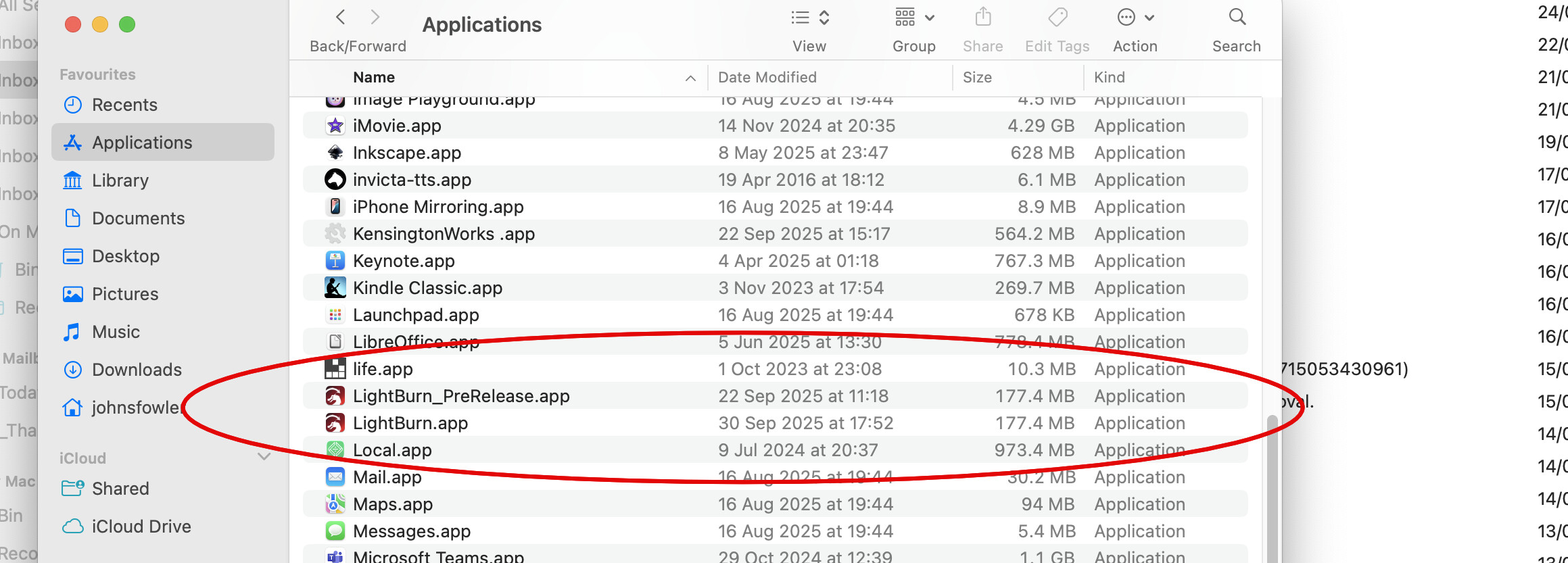

Hi thanks for this I tried it but in all honesty my knowledge of Macs is pretty rubbish. Where do I put this? Itried running it as described but I’m not sure how to determine the path to Lightburn. I tried going into the library, and highlighting the Lightburn app and choosing more info. I then chose the Where item and copy to path and got /Applications. So I went into terminal and % export QT_SCALE_FACTOR=“2”
open ./applications/lightburn.app
It returned The file /Users/johnsfowler/applications/lightburn.app does not exist.
What am I missing?
Lightburn is not an app, it is an executable, PC or MAC.
Perhaps you should let Apple know that!
