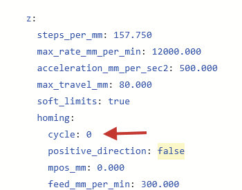

Unfortunately i am back at homing.
I used config from
My problem: i dont use a z axis and my virtual z axis is constantly triggering zneg,
so homing does not work
any thougths ?
According to the FluidNC docs here, you need to set the “cycle” for the Z axis to -1 to disable Z in the homing sequence.
This section in the config file you posted:
