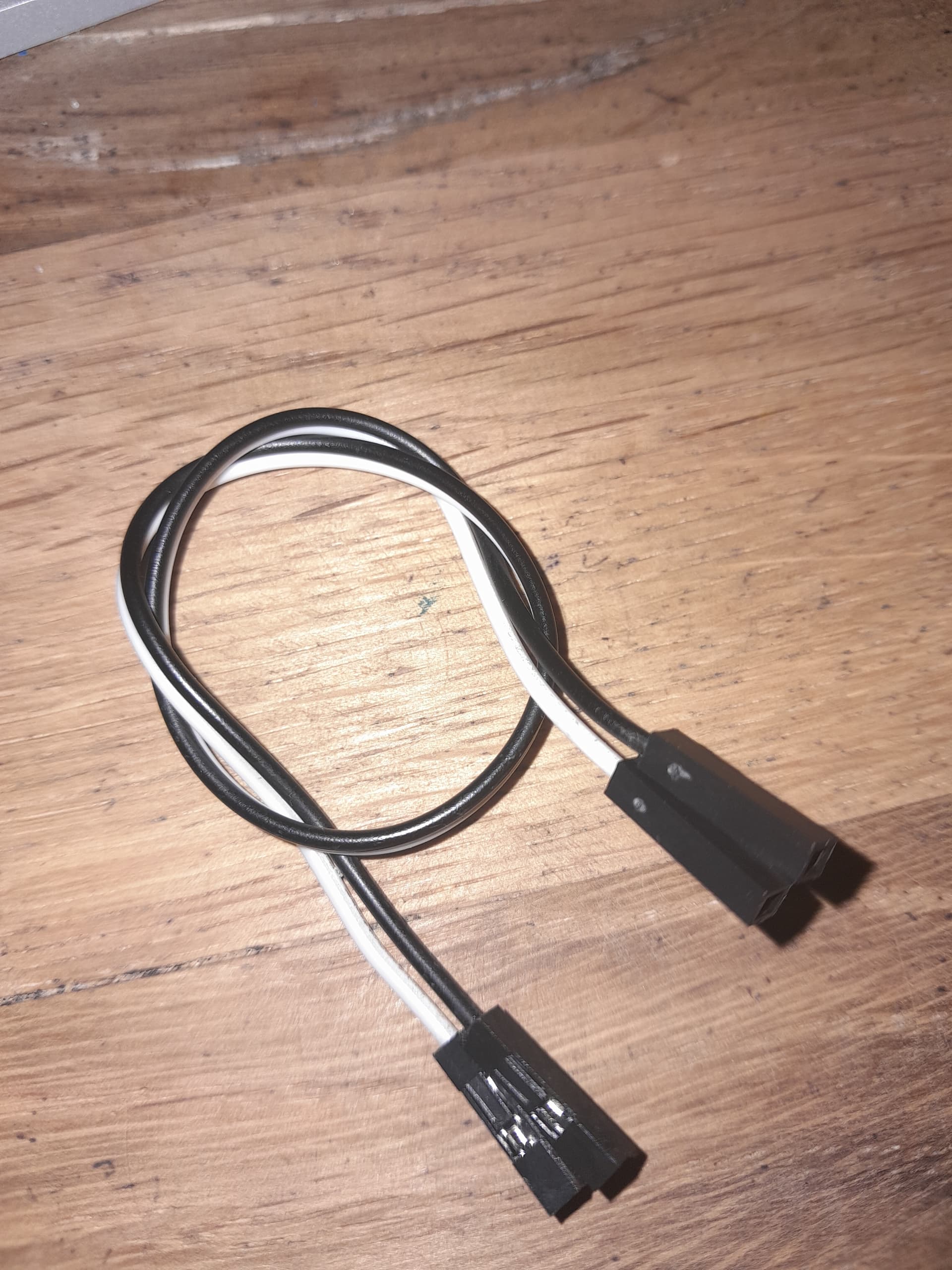

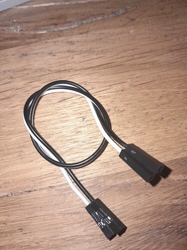

They plug into the controller board TMC2208 not the stepper motors .
when i got these today i got 2 little wires with them black and white…

Still in bed at the time this was written, and my brother as a meter to test wire’s I was thinking this last night as everything work’s but no just movement I dont think it is far off was also of thinking of setting my machine back to factory settings after some told me to change a few things in setting ?
yes and them 2 wires black and white that came with the TMC 2208 stepper motor drivers x 2
Check if the TMC 2208 V3 in STEP/DIR mode.
UART are not working.
The solder bridge for UART mode is V3 most set and can be re-soldered for DIR/STEP mode
I don’t have a clue what that is this machine worked 8 days ago till i put a Makerbase MKS dlc32 on it now it doesn’t want to know me , Everything but the stepper motors work.
