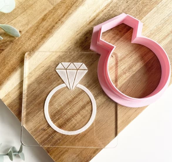

Hi I am wanting to make 3d cutters from my laser embossed acrylic stamps. I have tried offsetting on lightburn then making a stamp from fusion but the offset doesnt work. is there a simpler way to do this or simpler programme?
Picture for refernce is from laser doodle on etsy
