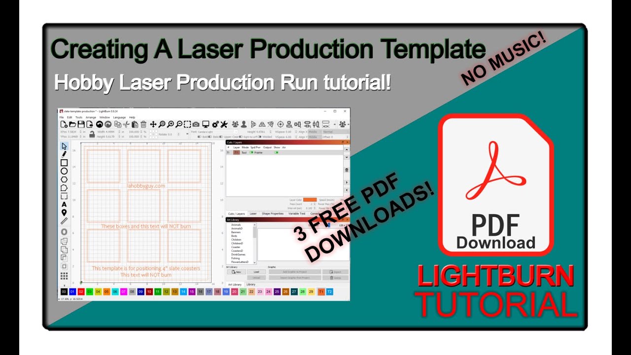

if you want to learn how to do these without framing, up to 9 at a time, here’s my video on making a template with 3 free Lightburn template files:
