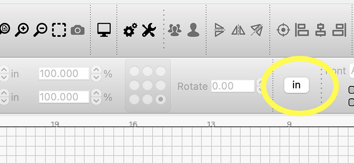

New to lightburn. I tried a material test and not getting any difference in engrave but a few on the bottom row. I did a side by side comparison with xcs and its a world of difference. Left is LightBurn, right xcs.
Not a good comparison. Set the Lightburn Material Test for a 5x5 grid, 150 to 350 mm/s, and 20% to 60% power and see how it comes out. then you can make a comparison.

I’m testing a theory. In Lightburn, Settings(Gears icon)> Units and Grids, Change from mm/s to mm/min and rerun your test using the equivalent values of 9,000 mm/min to 21,000 mm/min.

Here are the results for the test changing mm/min. Now I can see the difference.
Good!
I think Xtool does not interpret mm/s from Lightburn correctly. Leave it in mm/min and you should be good.
It interprets mm/s fine. Now any inch units. Right out.
Stick to metric and things should work.
Except he was using mm/s and it wasn’t working, so I suggested changing to mm/min and it worked for him. IDK?
@thelmuth it probably had to do with use of Inches in the Interval settings.
That could be. So the next time he hits the inch button to work on his design he would be back in the same boat. Might be worth some experimenting. I don’t have an Xtool machine.
Carlos, Ashwini make a good point.
When you have a minute I would like you to do a couple experiments. First, change the dimension settings to inches by clicking the button and rerun the material test using the same parameters. In other words speeds will be at mm/min but interval will be in inches, then change your settings to mm/s and make sure dimensions are in mm and run using your original speeds and post the results. That wil help to determine if the problem is the speed, mm/s vs mm/min, or the dimensions in inches or mm.
